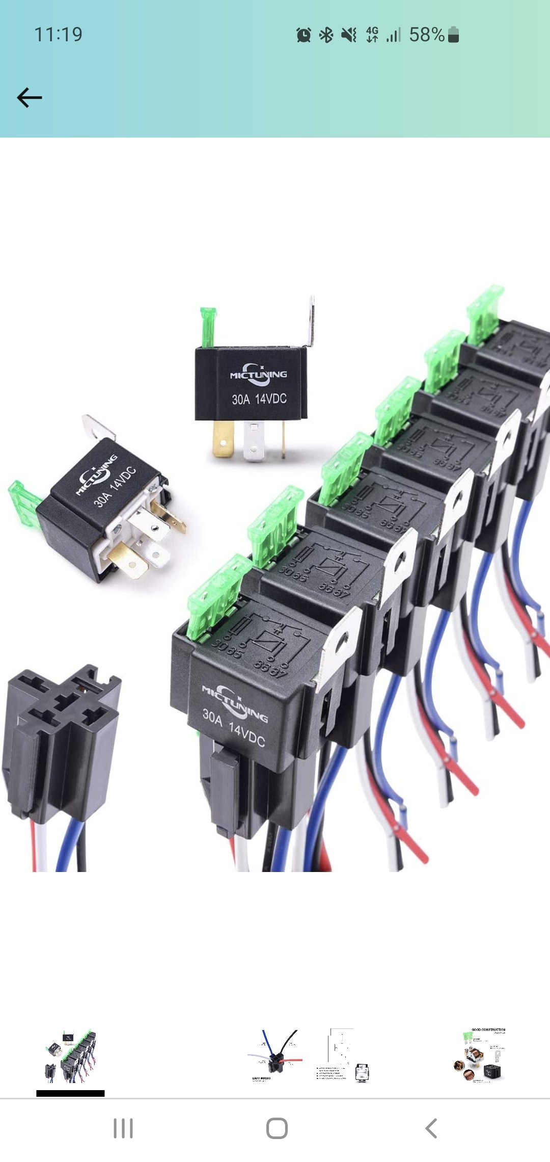

petert 614 Posted February 14, 2023 Add a relay close to lights/battery to minimise the voltage drop. Share this post Link to post Share on other sites
PhilNW 46 Posted February 14, 2023 (edited) Where is the best place to take new feeds (say 10 amp min) from, i.e. fuse box? At the moment I have the spots wired direct to the battery terminal Looking to tidy the wiring a bit Edited February 14, 2023 by PhilNW Share this post Link to post Share on other sites
welshpug 1,678 Posted February 14, 2023 (edited) Ring terminal from Shunt box into a fused relay would be easiest. Edited February 14, 2023 by welshpug Share this post Link to post Share on other sites
