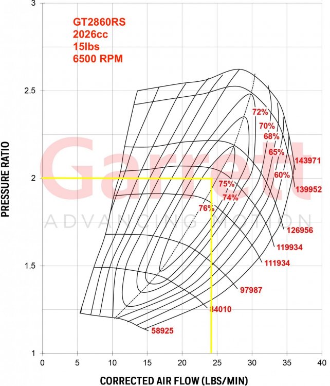

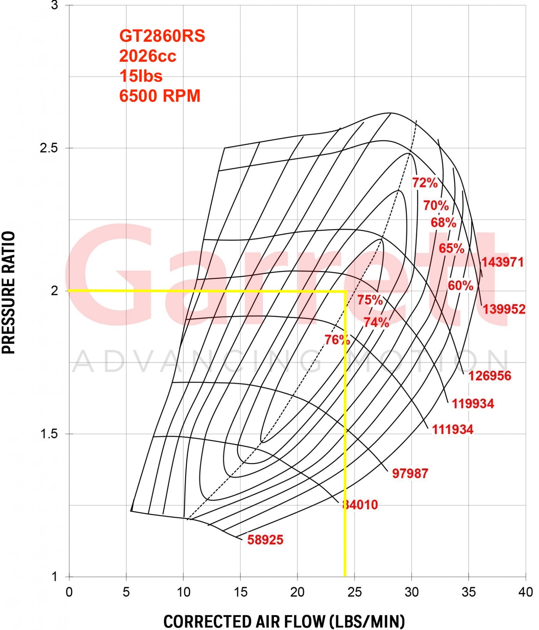

I agree. Thus why I suggested just the 86.5mm forged pistons and control the boost effectively. With 15-17psi and 2026cc, the GT2860RS is a good match.
Edited by petert
Here's the map - 2026cc, 6500 rpm and 15psi
