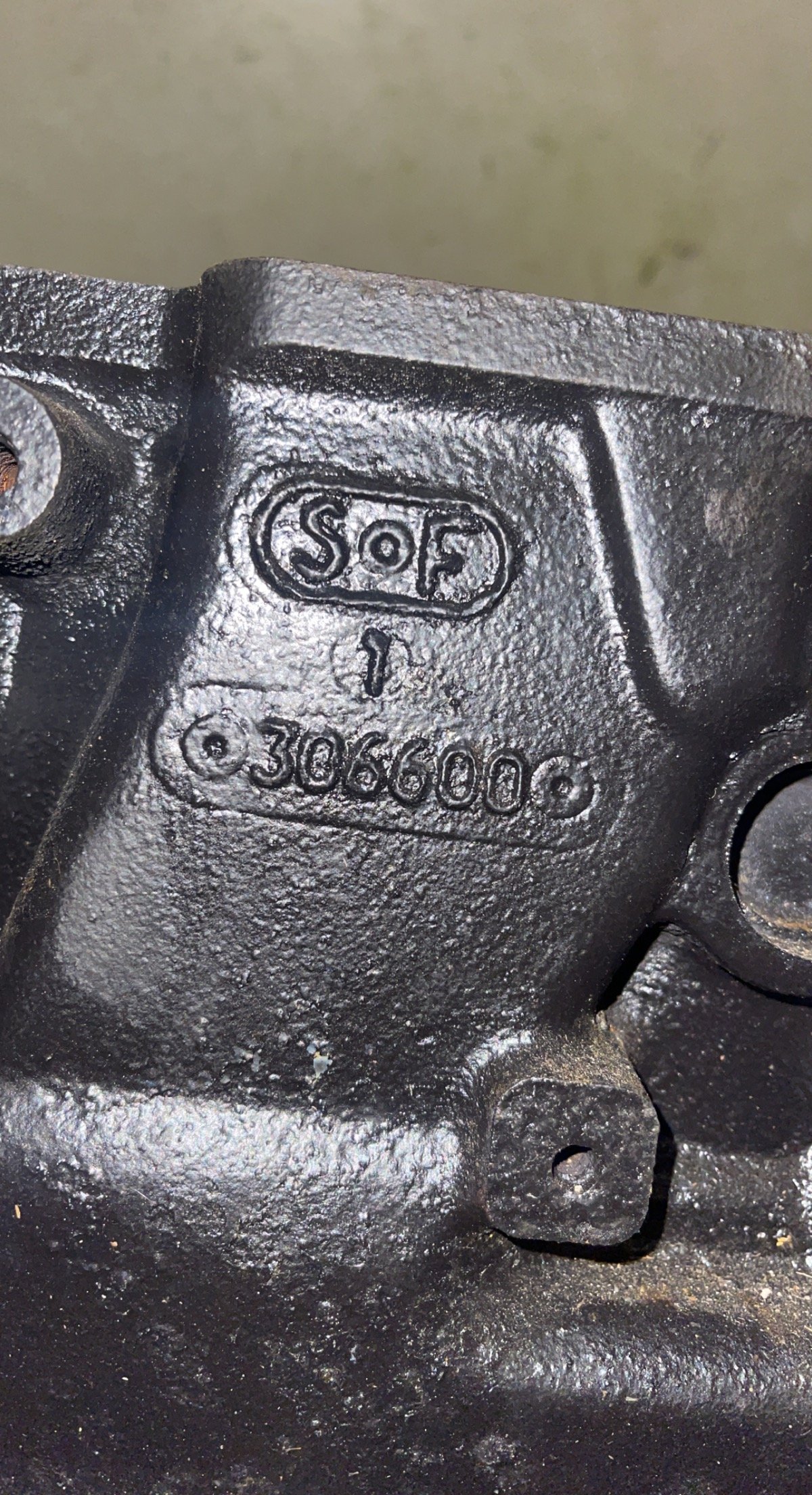

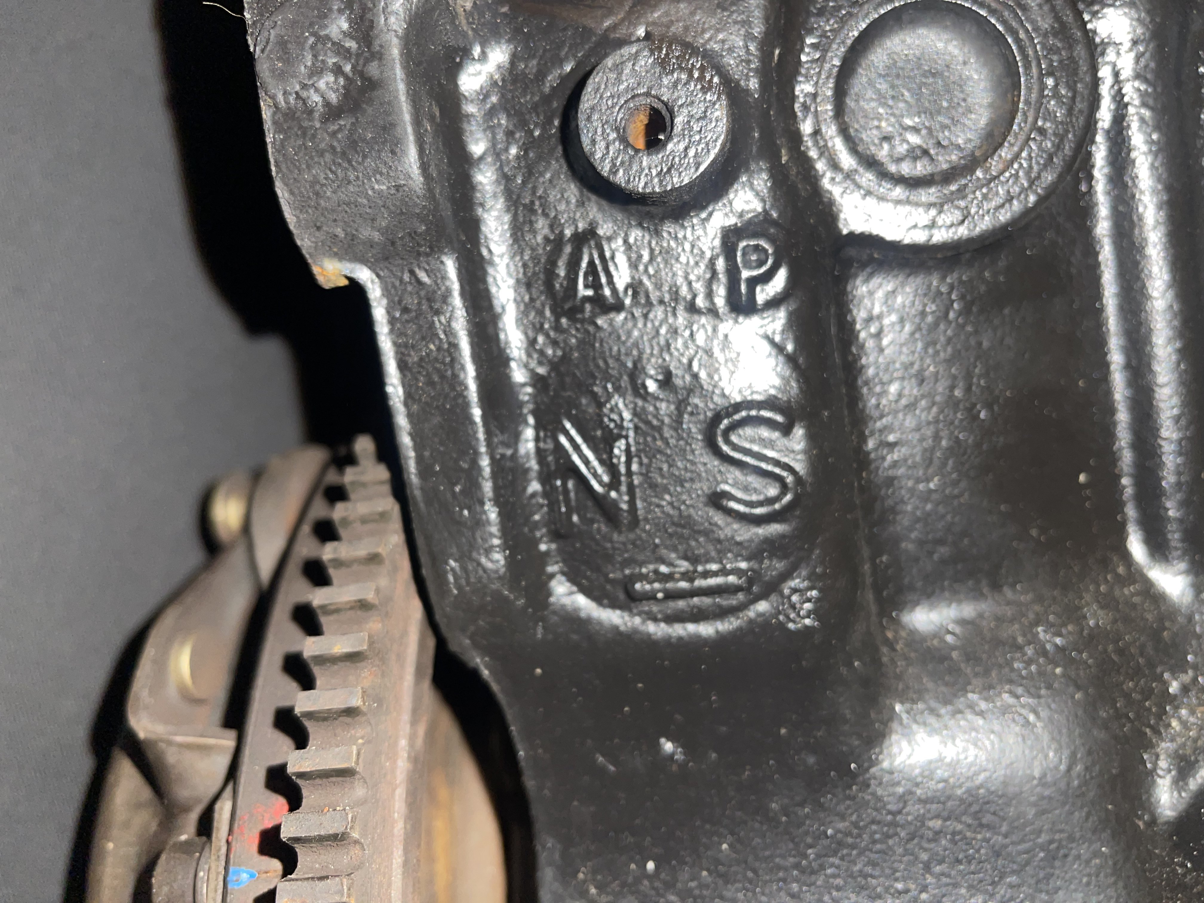

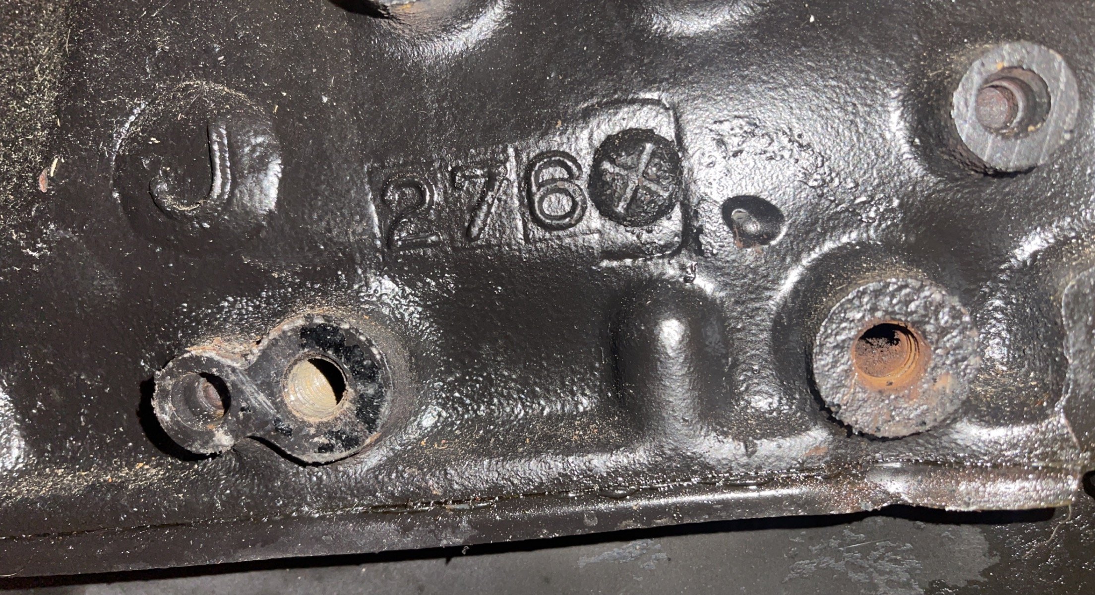

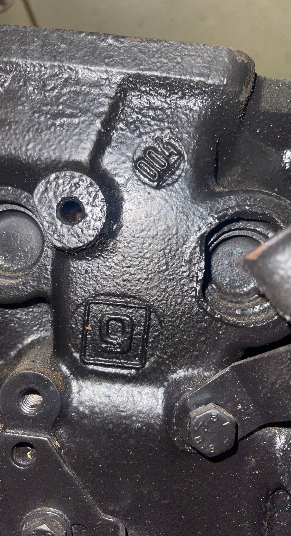

gtiburge 0 Posted March 14, 2022 That’s all the codes I’ve got off the engine are they of any use ? Share this post Link to post Share on other sites
SRDT 205 Posted March 14, 2022 The code should be here: Share this post Link to post Share on other sites

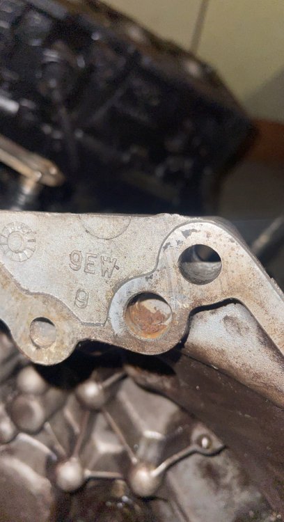

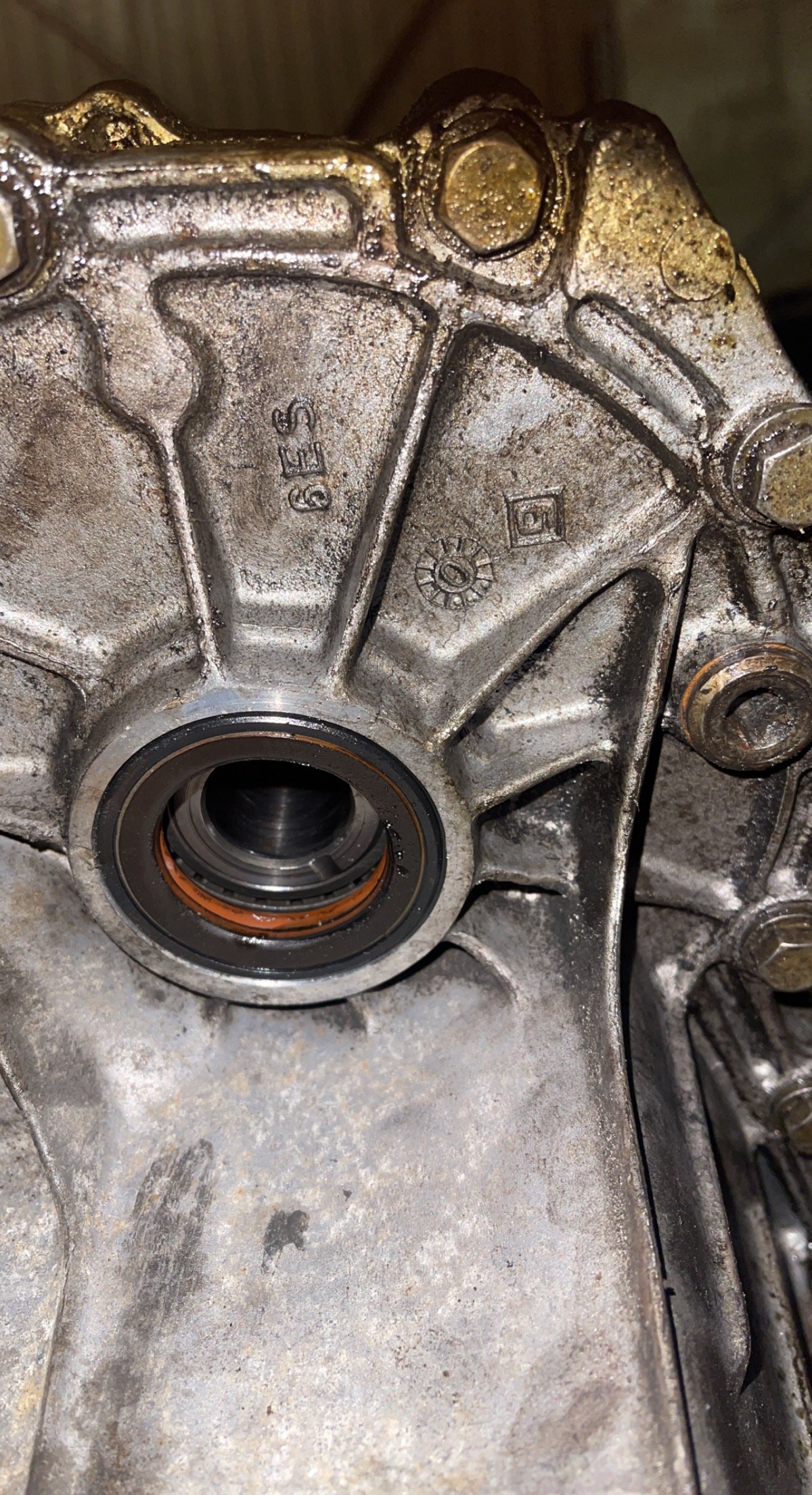

gtiburge 0 Posted March 15, 2022 Yh I’m getting to the bottom of it now you can buy a new plastic coolant flange to ge the pipes pointing in the right way , water pump is easy , Yh the tu3s gearbox has a different bolt pattern by the looks of it unless my box is not genuine ? I’ve got some codes from the box but not sure what it is Share this post Link to post Share on other sites
