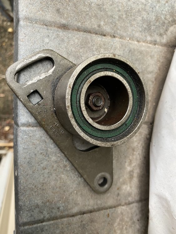

This is an inlet side XU10J4 tensioner. Exhaust is the same as XU9J4. It pivots on the 8mm hole and the slot is where the adjustment occurs, locked by the cam belt cover retaining pin.

Yup that's what engine 2 has got on it (standard/stock engine). Ok, this is all making sense now ☺️
So I'll just trim the plastic down that's getting bent by the tensioner; I'm guessing the shroud is off something else but otherwise everything else makes sense (for a race engine at least)
