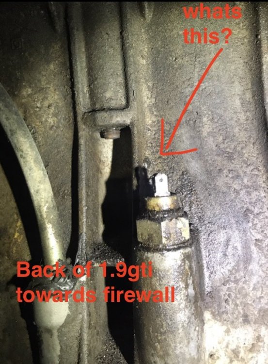

jj007205 0 Posted December 16, 2021 Anyone know what this sensor at the back (towards firewall) of the engine (1.9 Gti) is? Where are the connectors, wires likely to be? Any help greatly appreciated! Share this post Link to post Share on other sites
welshpug 1,737 Posted December 16, 2021 (edited) oil level, very few 205's had the gauges for them, fewer still actually worked reliably Edited December 16, 2021 by welshpug 1 Share this post Link to post Share on other sites
jj007205 0 Posted December 17, 2021 Great!! Any ideas on wiring? Share this post Link to post Share on other sites

SRDT 255 Posted December 17, 2021 Before 86 the 205 had a "oil level box", it was fitted on GTI, diesel, XU with carb... I've read that it used the oil pressure warning light and made it blink. Share this post Link to post Share on other sites
