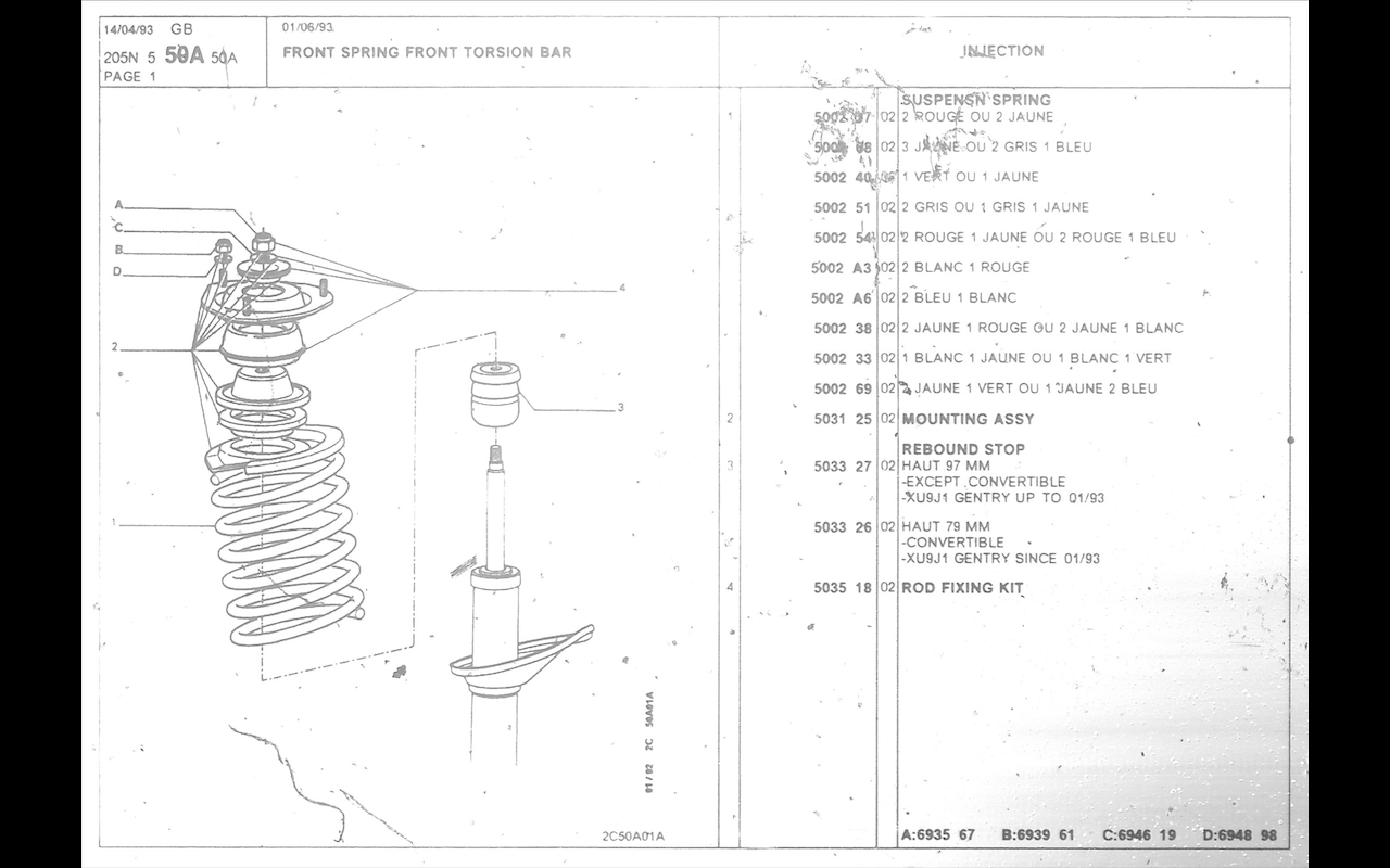

I got a set of meyle bearings #214 770 0001 from Lithuania UAB Elart over ebay about 9 months back
but its a bit dicey with shipping, and changing all the time
there looked to be heaps of UK suppliers doing strut top kits on ebay
try "peugeot 503125" , and some kits have more in them than others
hopefully you dont have any corrosion so you'll only need the bearing
far as I know the variation between models is only in the bump stop, spring, and shock
so any parts you need should be the same across models
Gohn
got a later clearer pic
hopefully you only need D
