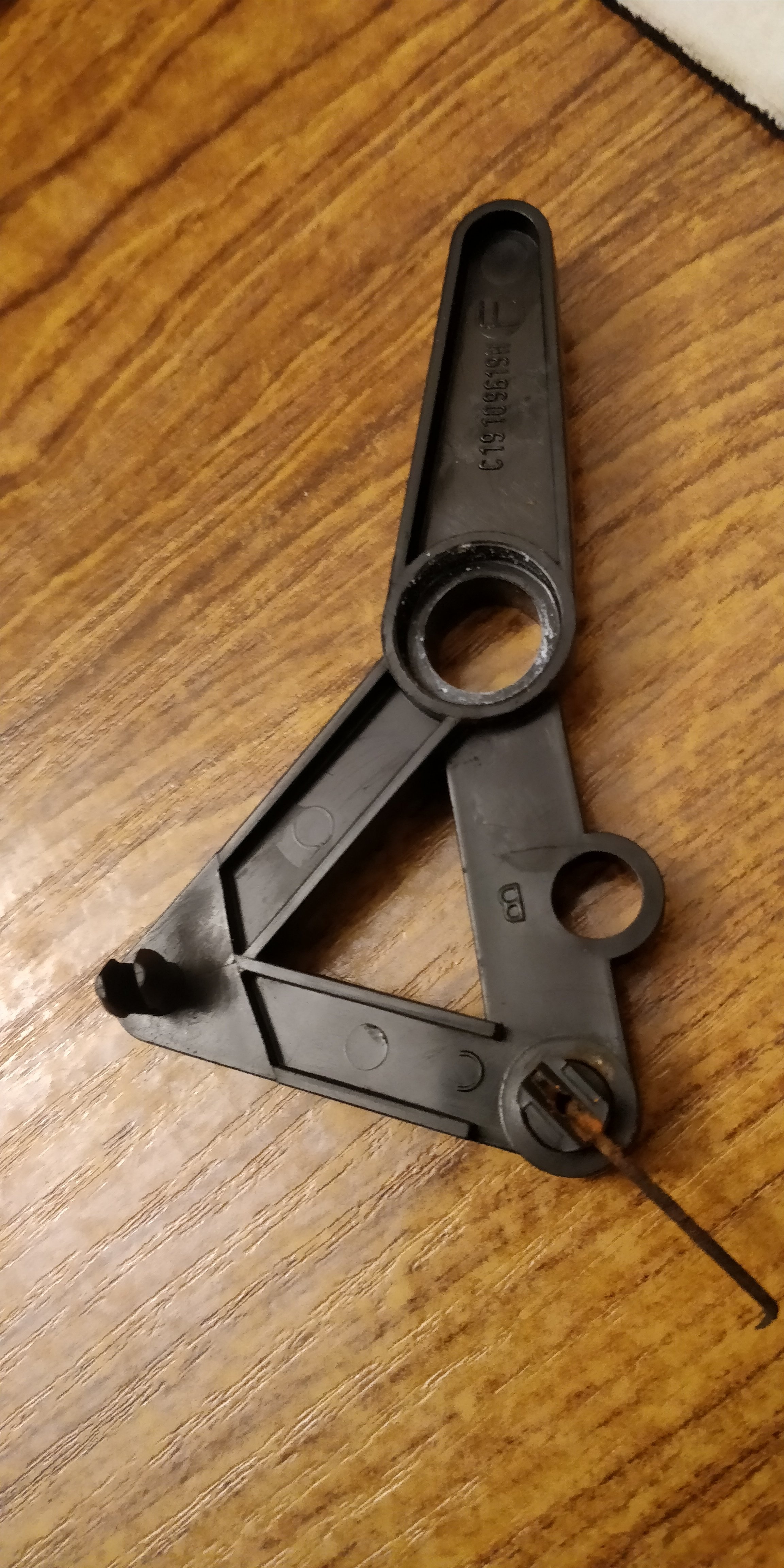

The fresh air vent cable has snapped on my car. Just wondering how to go about replacing it. I already have most of the dash out searching for a wiring fault so I am hoping it doesn't require too much more disassembly from this point. Can a new wire be made from modelling spring wire (piano wire) or are these parts available? How does the wire get removed from the plastic part? Just lever it up carefully and hope the plastic part does not snap?

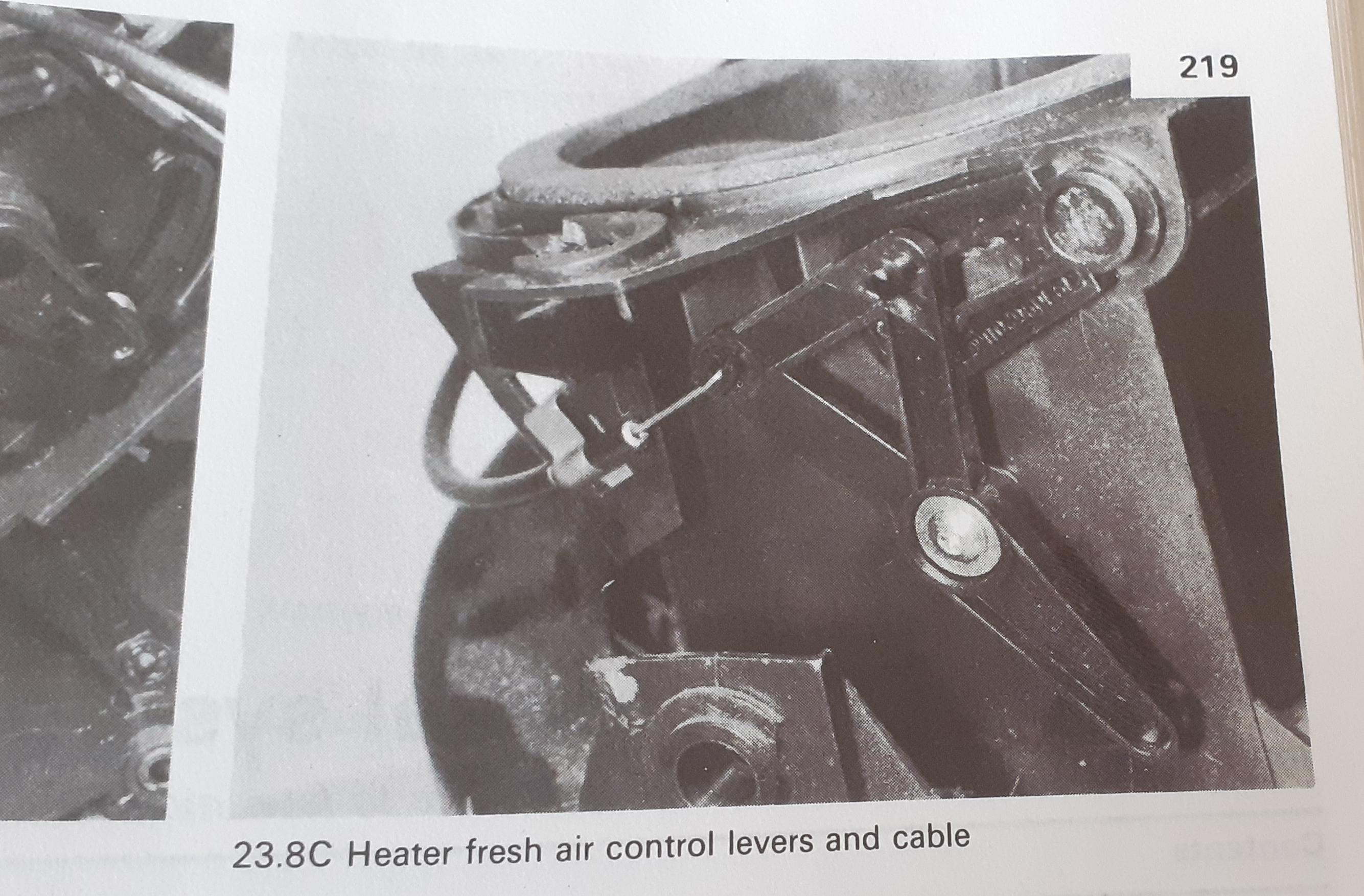

I don't know any of this for sure as I have never done one of these but I just had a look in the HM 205[932;1983-1991] to see if there is anything that could help me try and help,
found the pic below. pic 1 think this is the part looks identical must be

looks like it is something where the anchor to the end of the cable threads through to lock it into position to pull when the wire is pulled - if you push the wire forward would the anchor move forward? then you can unthread it from the plastic ?(is it not like the other cable attachments like the accelerator?)                                                                                                                        pic1 below

its pretty good wire when corrosion free and usually just manouvre out the S end or pop out if its at right angle
