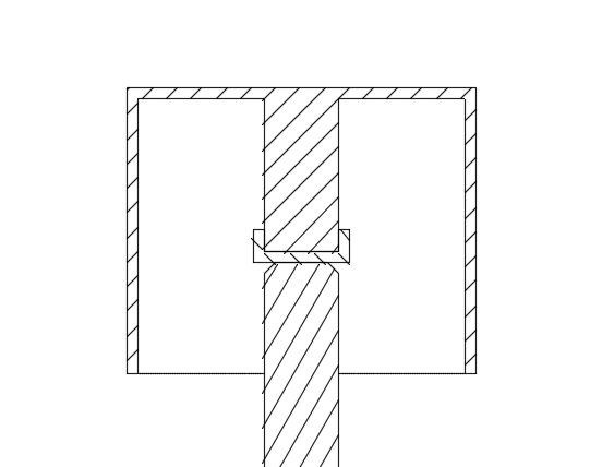

This is what I meant. It's light, simple and standard practice.
