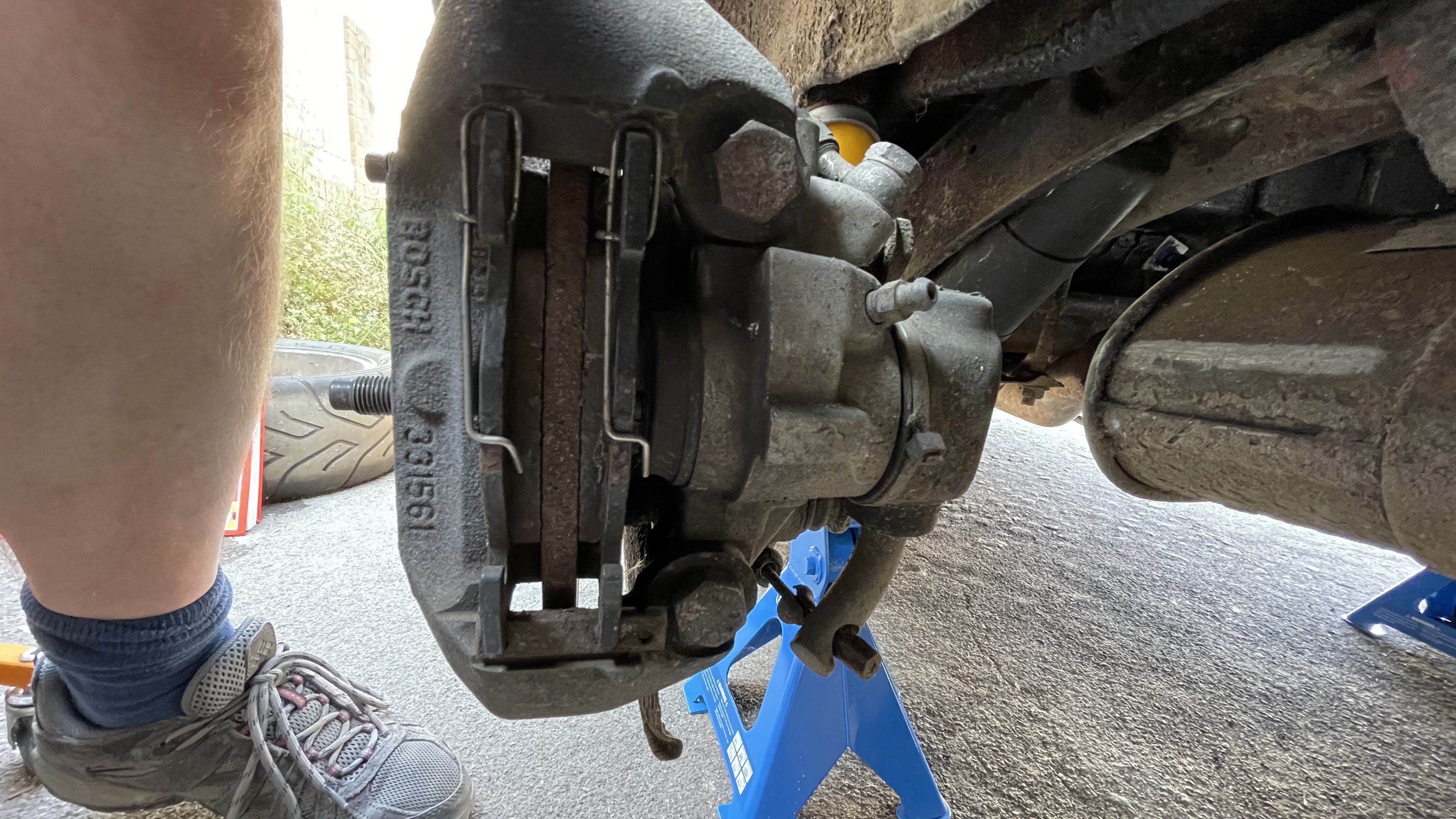

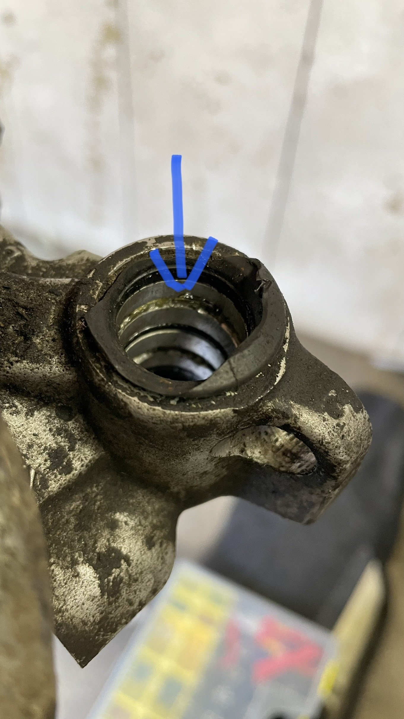

Greetings people. I'm servicing the rear callipers on my 1.9 GTi and I need to replace the rubber rings on either end of the sliders. Unlike the front it's harder on the back of course. It looks like the slider rubbers are held in by a ring, does anyone know how to remove the rings? are they screwed in or push fit and need knocking out? I have Bosch 331561 callipers if that helps? I'll also attach a couple of photos.Thanks.

Ah, so turns out that ring doesn't come out, just a ring under the rubber

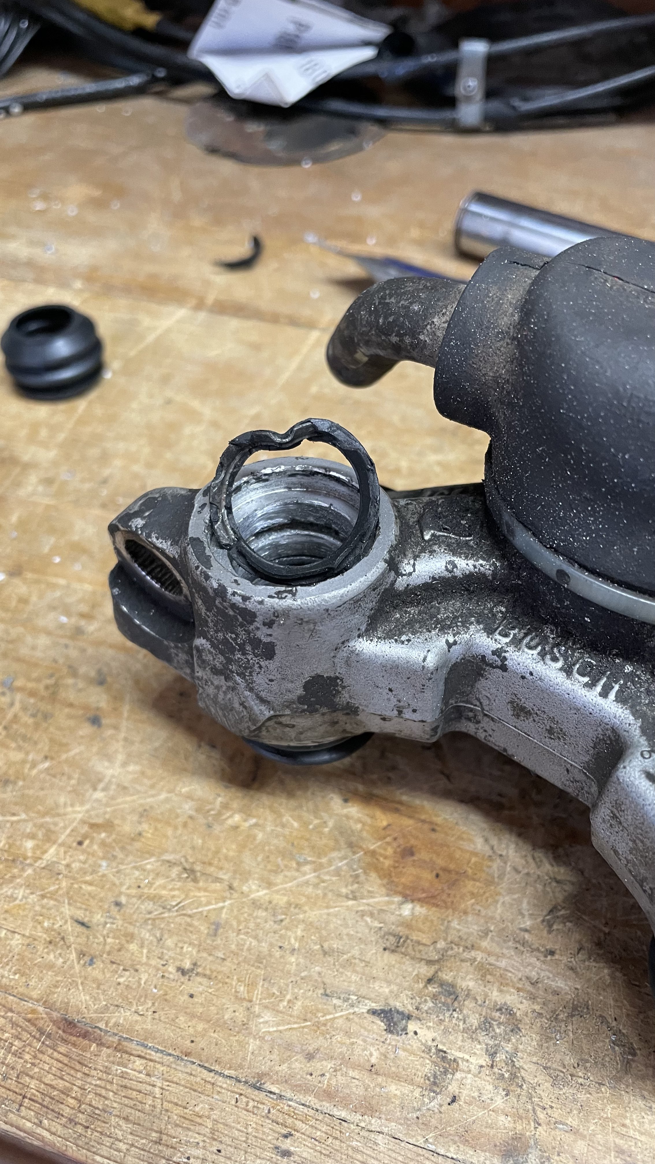

Hey Welshpug, thanks for the reply. Yep, after I ripped away some of the rubber I noticed a little nick in the alloy, put a narrow screwdriver in there and.......pop, came out easy. The other 7 were out in mins :)
