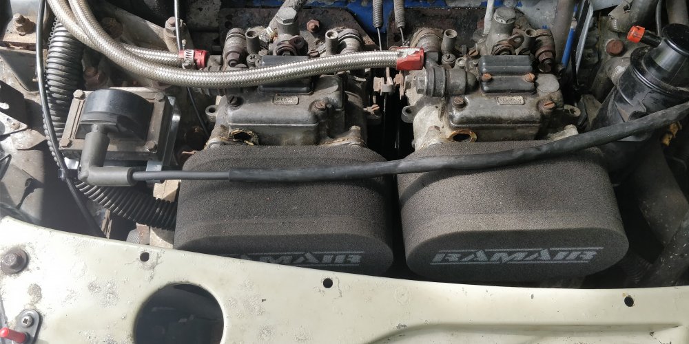

richard64 0 Posted July 20, 2021 I was replacing the air filters today on my car and above the left air intake trumpet on the Dellorto carbs there is a large hole 1.5cm. Does anyone know its purpose? It doesn't seem to be part of the main air path. Thanks Share this post Link to post Share on other sites
calvinhorse 870 Posted July 20, 2021 On the air filter back plate? if so it’s for an air temp sensor usually Share this post Link to post Share on other sites
richard64 0 Posted July 24, 2021 Thanks, I have foam air filter s with no back plate (not sure if that is an issue) and the hole is exposed just above the air filter. The is no air temp sensor, Is it ok for the hole to be exposed or should it be blanked off? Share this post Link to post Share on other sites
Thijs_Rallye 90 4 Cars Posted July 25, 2021 I think those holes are the float chamber vents. Share this post Link to post Share on other sites
