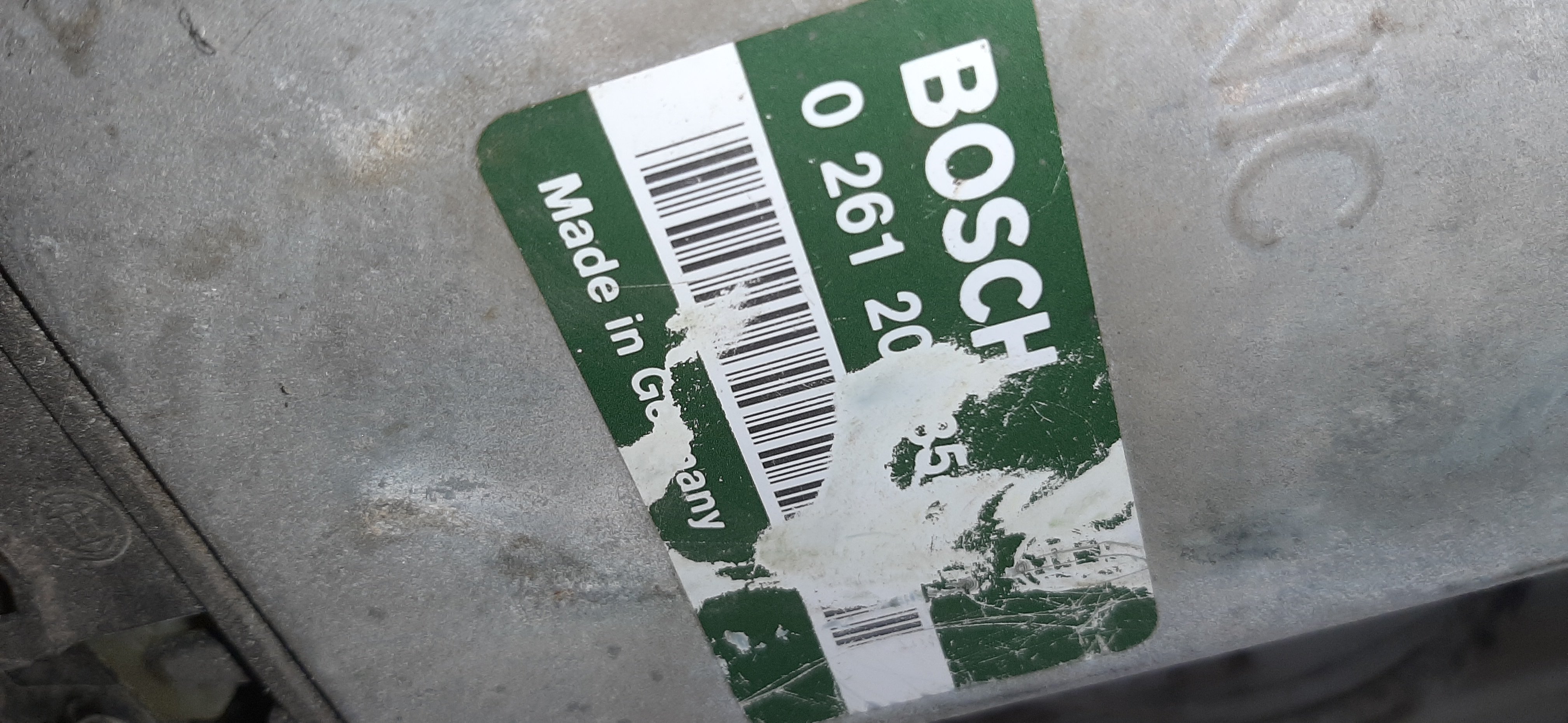

peterhenry07 0 Posted June 25, 2021 I am trying to determine if a MI16 engine that I am looking @ is a D6C or a DFW - the PTC plate is missing - the only thing I have is the engine number which starts with 1CW5D, does anyone know if this tells me anything? Someone has told me if the Bosch label on the ECU is green it is an early Mi16 which means it is a D6C. Thanks, Share this post Link to post Share on other sites
petert 617 Posted June 26, 2021 (edited) What is the part number on the ecu? http://www.taylor-eng.com/ecu/motronic_intro.html Edited June 26, 2021 by petert Share this post Link to post Share on other sites

peterhenry07 0 Posted June 27, 2021 Thanks Folks, unfortunately the ecu label is damaged Share this post Link to post Share on other sites
SRDT 205 Posted June 27, 2021 Looks like 0 261 200 354 or 355 to me, so this ECU should be for a D6C engine. But because this is a 55 pin 3 row ECU that means the original ECU could also have been a DFW one. Share this post Link to post Share on other sites
petert 617 Posted June 27, 2021 If there is no lambda sensor or fitting for one in the exhaust downpipe, it has always been a late D6C with 355 ecu. Share this post Link to post Share on other sites
