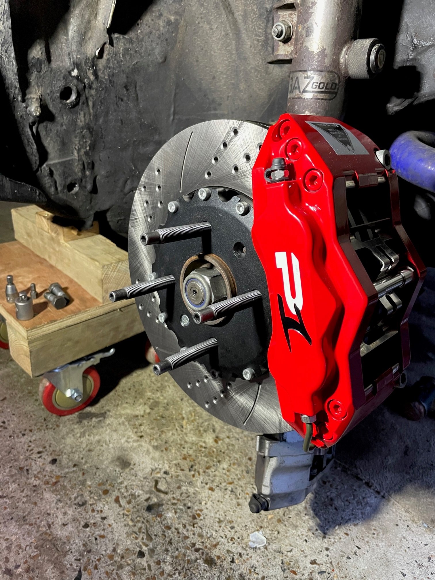

SweetBadger 99 Posted May 13, 2021 I've done this recently - you can just about make one of them out in this picture: Some oak with a slot for the jacking point to sit in. Then some 3x3 pine and plywood screwed together with 4 x castor wheels per platform. It's nice and secure and makes working on the car in a single garage a lot easier! I also have a fixed electric hoist on an I beam in the garage roof, so can lift engines out then move the car out of the way on the castors. Castor wheels I used are here: https://www.ebay.co.uk/itm/254397876458 This was my 2nd attempt - 1st attempt with some lower rated castor wheels did not end well! So if you're planning on using them with the engine in don't be tempted to go for a castor wheel with a lower load capacity. Share this post Link to post Share on other sites
Tatty205 0 Posted May 13, 2021 Thanks alot for the advice that's exactly my plan for mine, top man. Nice calipers them Share this post Link to post Share on other sites
