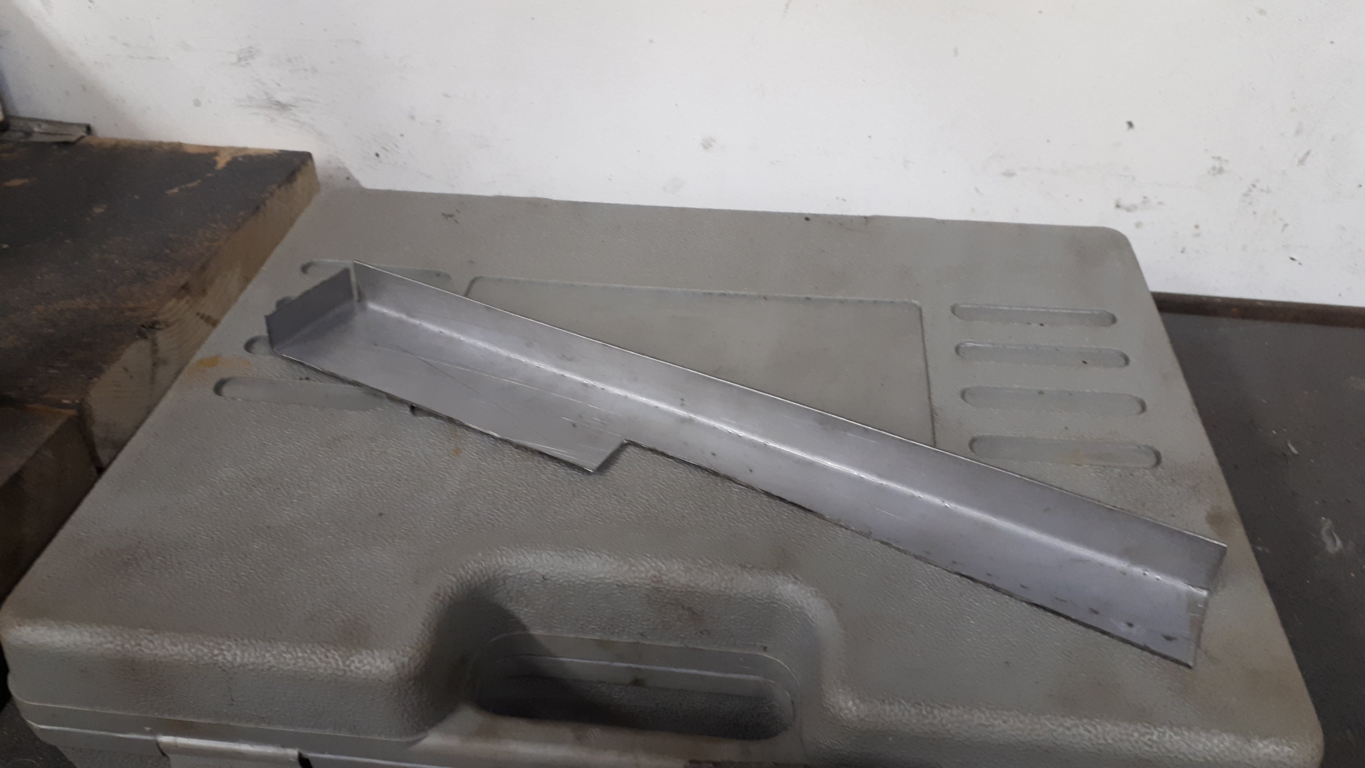

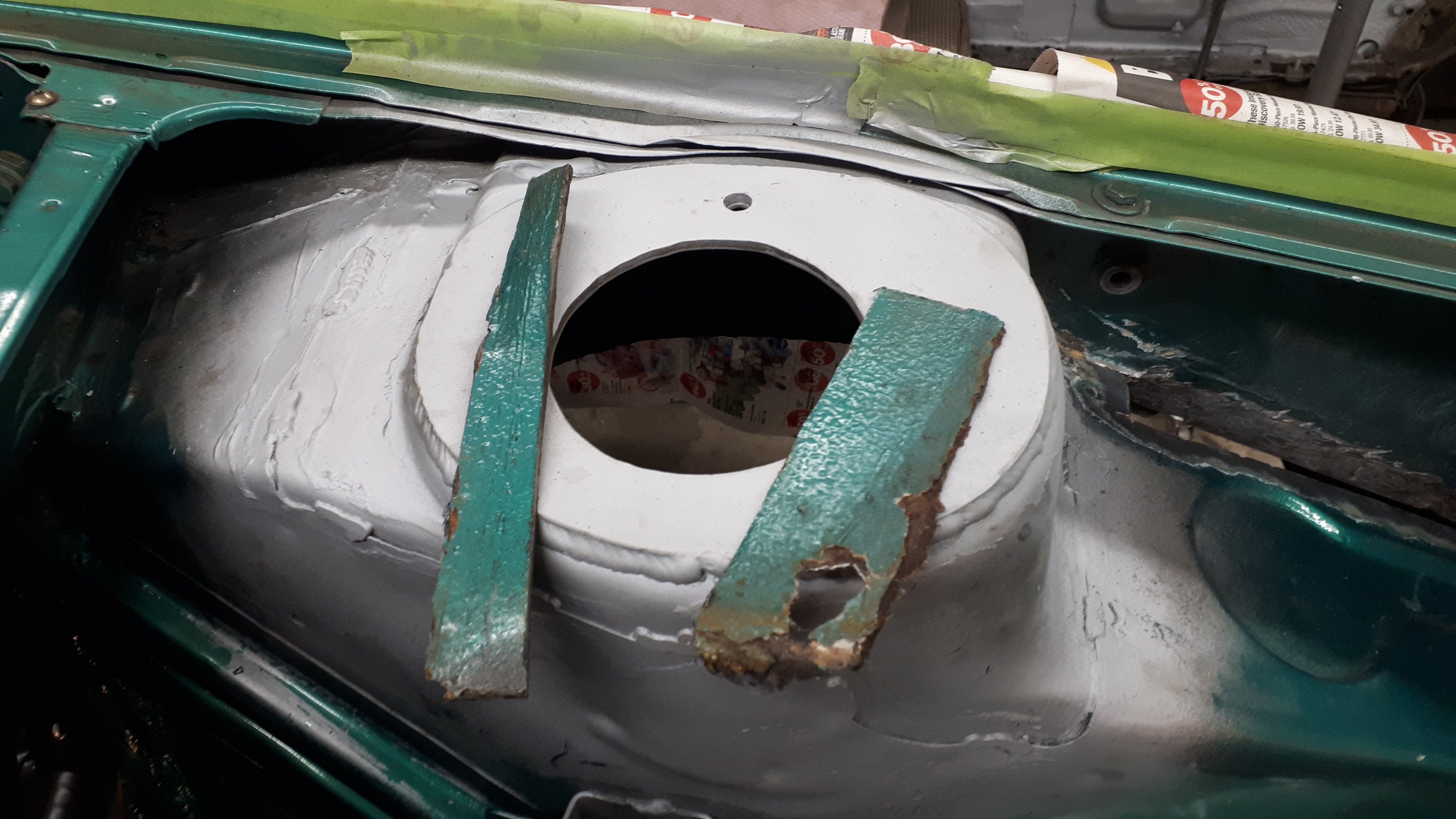

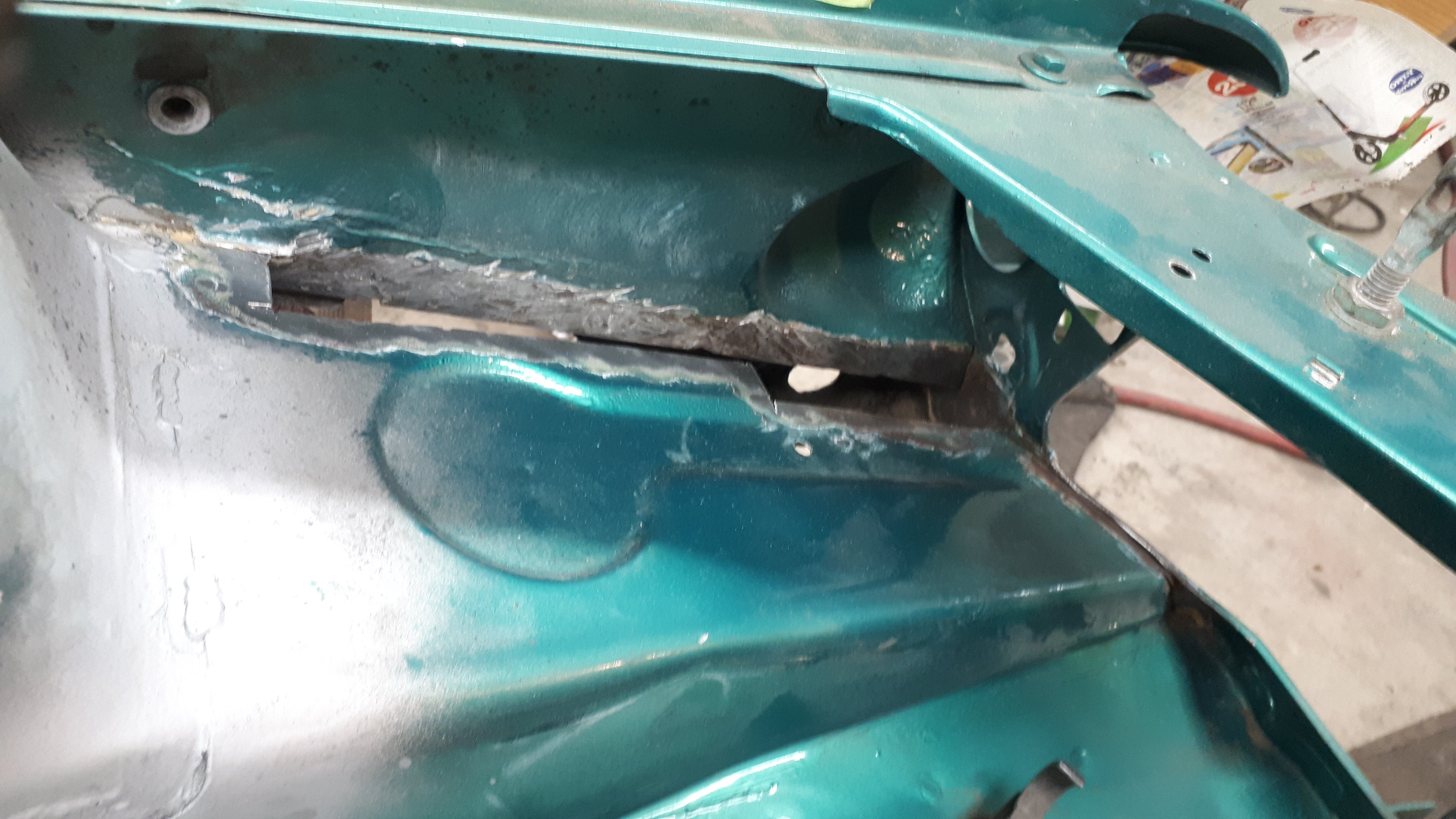

This came as only a small surprise to me, but I prodded a rust bubble which looked like nothing behind the head light. Turned into a bit more than I thought it was going to be to be honest. Still an easy repair in comparison to my other project car (1977 chev vega). But still worth reminding everyone that it's amazing what is hiding under the underseal and seam sealant.

A very common area for rot as the washer bottle is there and water gets split into that seam,mine was the same  Nice shade of green !
