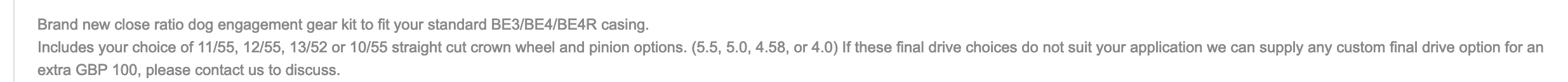

petert 616 Posted November 5, 2020 (edited) What about fitting a Satchell dog box gear set to the BE3? You can have what ever cwp you want. you can change 5th and the cwp of your current gearbox. Swapping 5th is easy but changing the cwp is a full strip. Edited November 5, 2020 by petert 1 Share this post Link to post Share on other sites

erick314 0 Posted November 9, 2020 On 11/5/2020 at 9:12 PM, petert said: What about fitting a Satchell dog box gear set to the BE3? You can have what ever cwp you want. you can change 5th and the cwp of your current gearbox. Swapping 5th is easy but changing the cwp is a full strip. I saw some dog box setup and all I could find was shorter ratios, for fast car response. Not longer ratios for top speed. I also saw that dog box was not so cheap. So my case I´m thinking to make longer ratio, and try to have some safe setup: I see some guys using forged gearbox and custom built, but they have some problem and take months to have new gears. That is why I was looking and considering at first moment to try to find some "OEM" based setup for my application, if possible. So if I need replacement parts for example , I don´t need to rely on someone to custom build it for me, and take a few months. Not an easy task and investigation. Thanks for the suggestion. I will research it a little bit more to see if could be an option. Share this post Link to post Share on other sites
petert 616 Posted November 9, 2020 (edited) See attached. No, it's not cheap but nothing that can reliably hold on to 360+Nm will be. Aside from the strength of the gears/shaft themselves, the other issue is the case. The later BE4/BE4R case has an improved bearing on the end of the 1st line shaft. It's possible to modify the earlier case to accept the bigger bearing. The earlier BE1/BE3 gears are actually stronger than the later gears, which are finer to reduce noise. Thus the ultimate cheap arse gearbox is probably a BE3 Mi16 gearset, with 3.62, 3.78 or 3.94 cwp in a later case. Edited November 9, 2020 by petert Share this post Link to post Share on other sites
