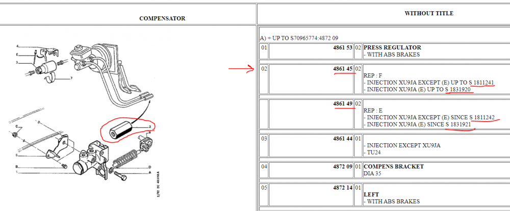

Since the car is parked outside I cannot work on the brakes properly. If the compensators are too rusty or facing away against the floor I have to identify by some serial number. As an alternative, should I compare the last seven digits of my chassis number with the drawing info below?

Hi again,
had a chance to look at the old part, it says "E"  and "24" stamped on one side, and the car falls in the late model of chassis.
Let me know if anybody knows a good source of these brake compensators, Manufacturer part number: 4861 49.
