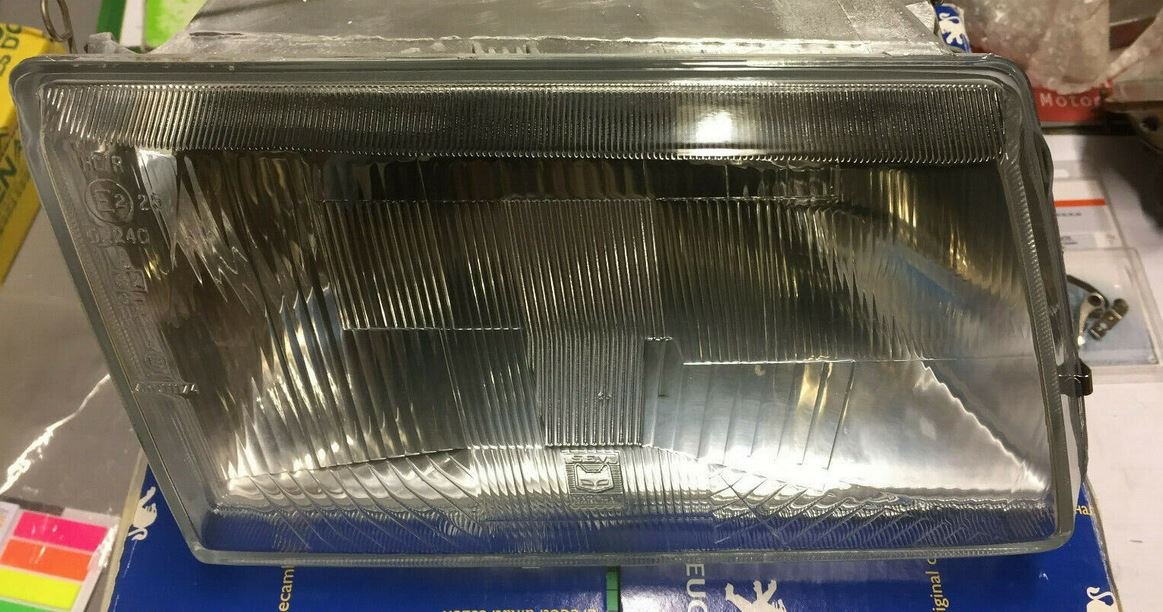

Intend to change the aftermarket headlights on my '89 1.9 for second hand Valeo / Marchal ones.
Even being 30+ years older than the copies the originals seem to be a far better fit / finish.

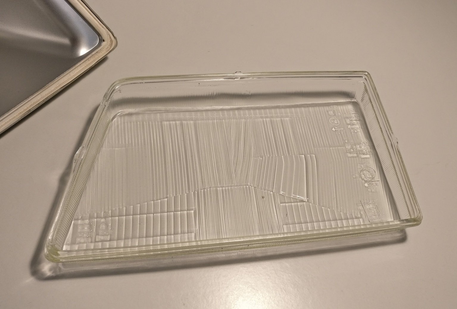

Got a pair for not too much, however the glass lenses weren't too secure.
Up side is they came off easily without any damage, down side is they have to go back on at some point.
If some one has used a specific product to re-seal them and knows for a fact it works / stands the test of time would be grateful to hear... cheers.

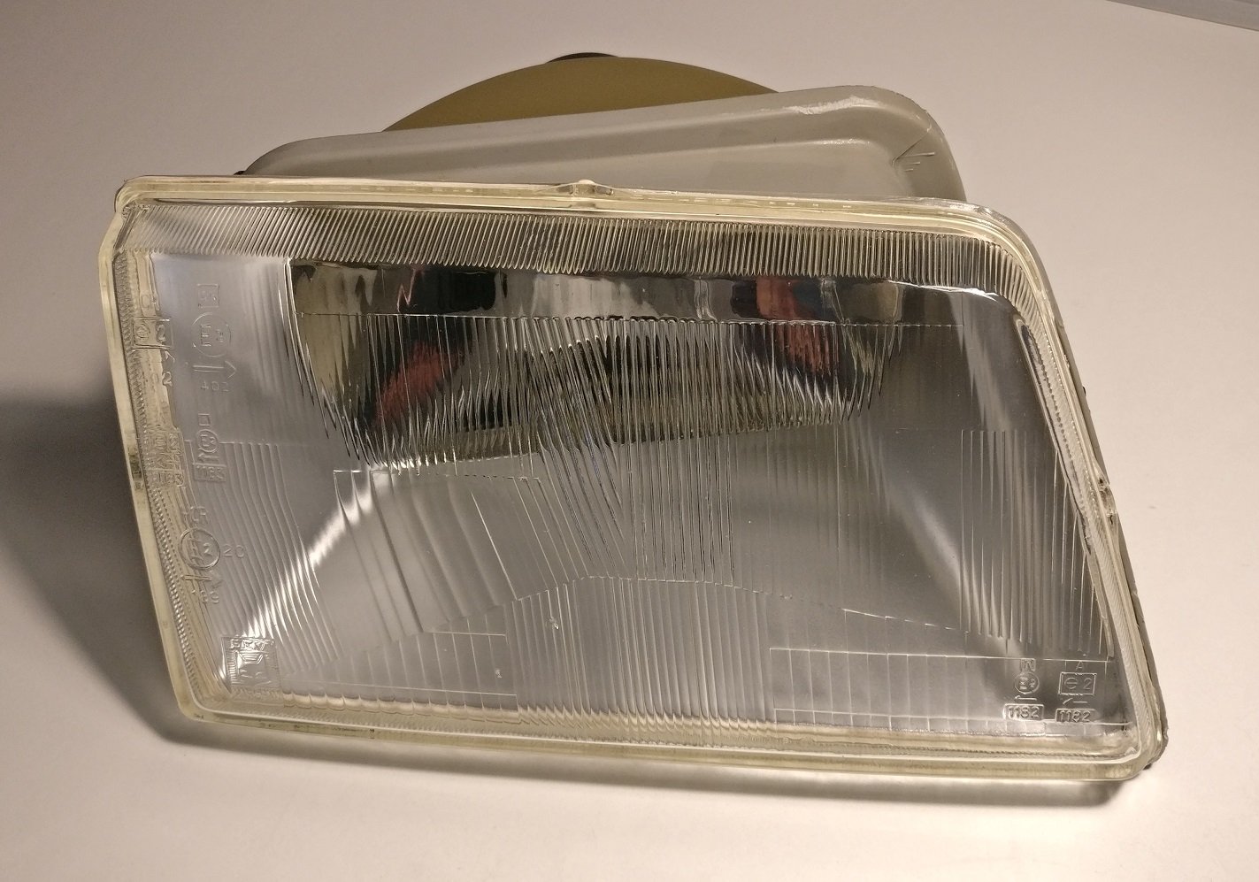

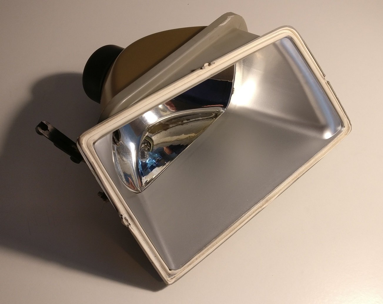

bacardincoke
Checked out a few different sealants / adhesives on-line and while you can't always take any reviews as gospel this stuff seems to only get positive comments, plus even one or two mentions of using it successfully to re-attach headlight glass.
It's also clear drying, some cure translucent. Thought if it wasn't visible, any less than perfect bits would be harder to see.

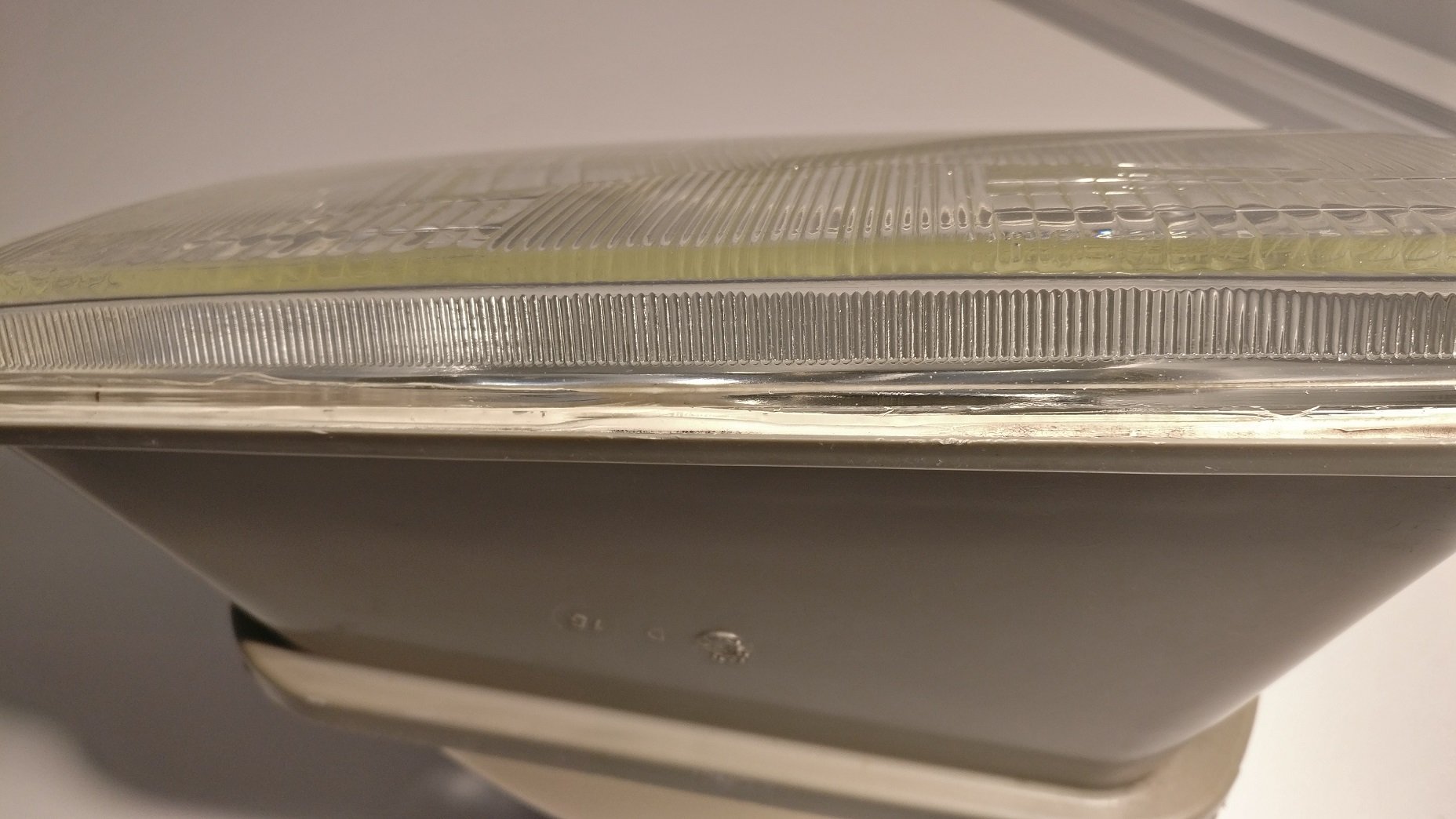

The original stuff cleaned back up to near white and as it was complete / already shaped to the countours of the glass and still made a perfect seal I left it in place, plus it was so well stuck I don't think I could have removed it completely to start afresh even I'd wanted to.
Easy to work with and apply, takes 24 hours to fully set - will stick up a photo of it fitted back in then.

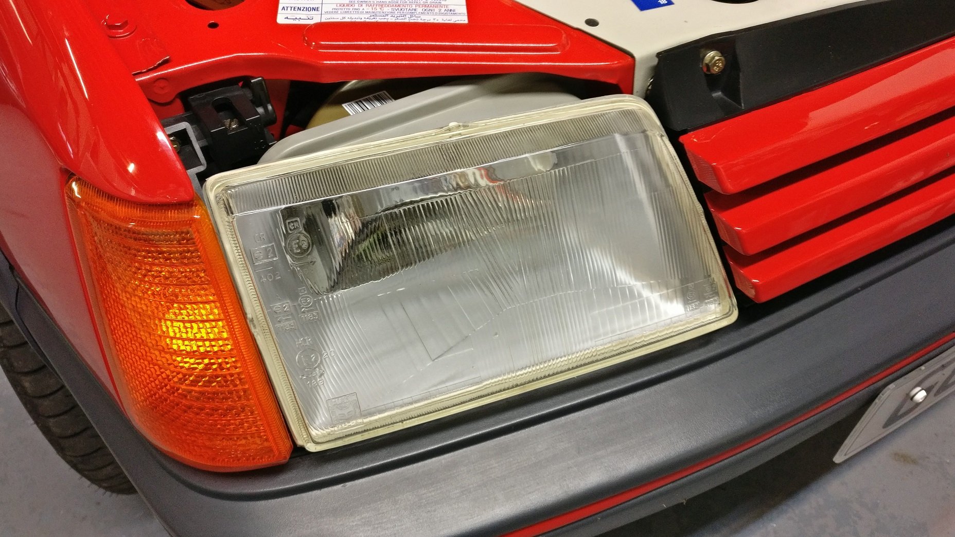

bacardincoke
Proof's in the pudding and even though it's only been weeks got to say the Sikaflex stuff works a treat... recommended.
Cured clear as expected so you don't see they've been re-sealed and are holding rock solid.

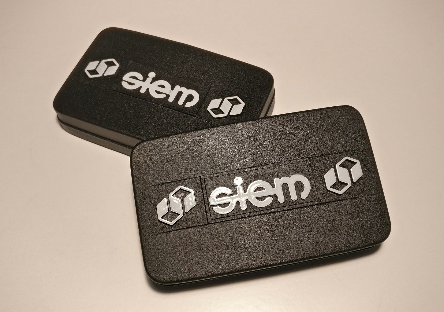

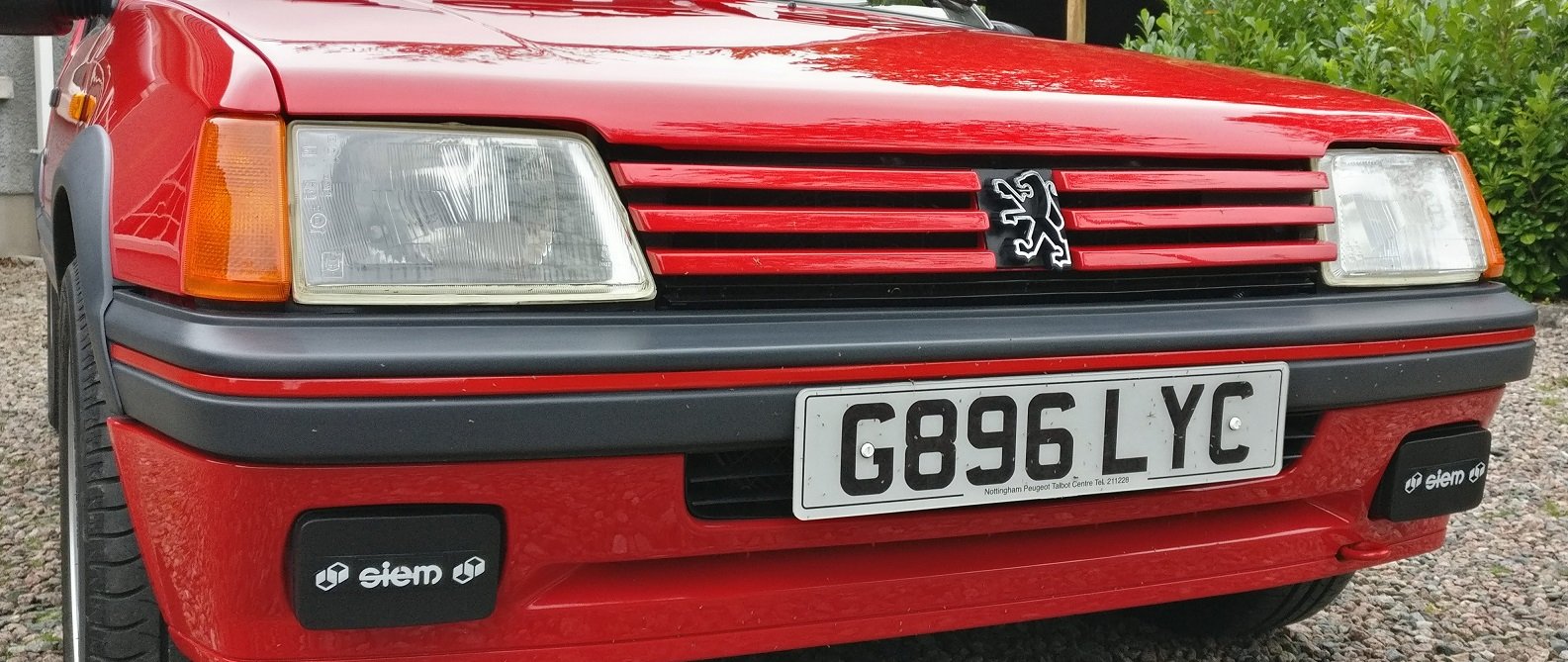

An unplanned effect of changing out the head lights is they now make the Denji spots stand out and look a bit odd.
The Marchals have a slight yellow hue being old glass while the Denji's are new and a bright clear white.
Since picked up a set of SIEM's, plus a spare for less than £30.00 posted... wouldn't have paid the prices they usually seem to go for otherwise.
Despite not costing much I don't want them getting damaged.
There are at least two repro. cover types that I've seen... jury's still out on whether I like the look or not but if I do get some am leaning towards those that clip on over the whole unit as opposed to screw on type that use the existing holes.
Some pics on the inter-web / sellers auctions, but difficult to get a proper idea.
Anyone got the type I'm talking about and can put up some better images of them fitted?
