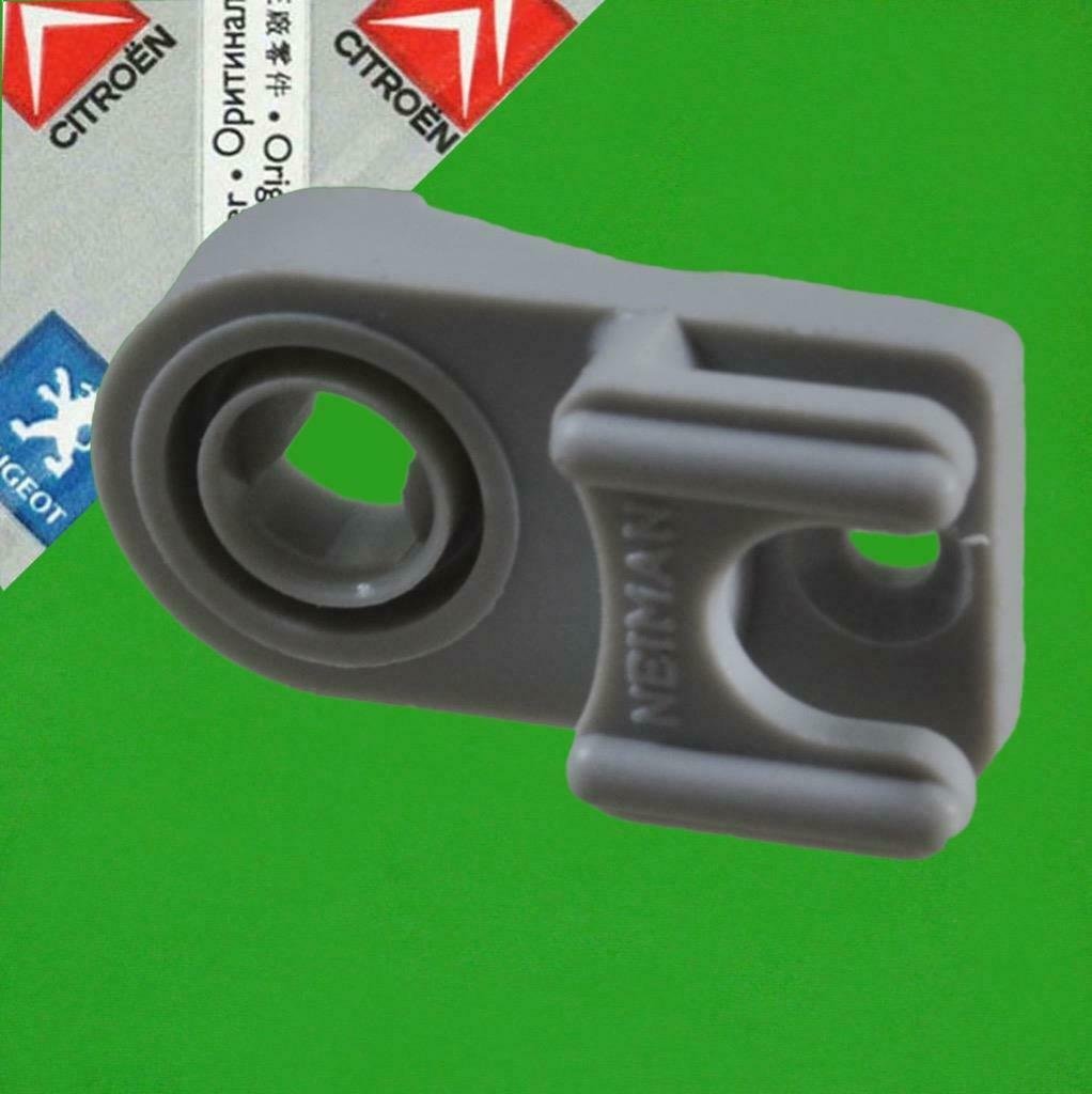

If you pull the barrel clear of the door (as far as you can) & rotate it, you should be able to see the rod & unclip it from the plastic clip on the back of the barrel.
They are only clipped loosely into it, with the barrel clip turned through 90' from it's usual position, there is a gap in the plastic that allows you to remove the rod.
