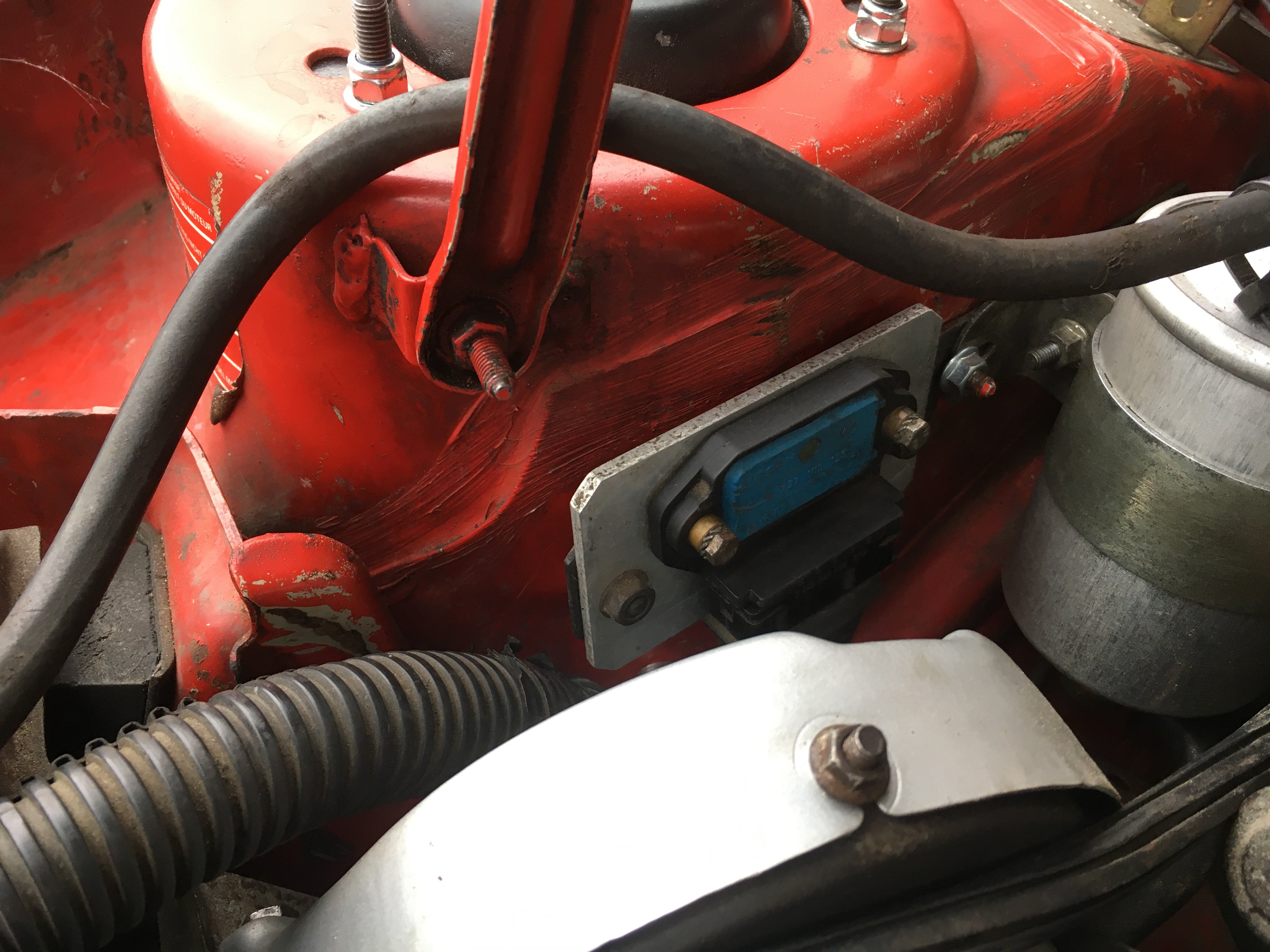

Is this it? Mounted on the metal plate in centre of the photo.
Im looking for 12v thats supposed to feed the fuel pump, not getting 12v at fuse 14.  Chassis -ve connection ok at fuel pump.  Haynes diagram shows wire 76 going direct from fuse14 to tachymrtric relay, I hope that’s right.
DamirGTI
No , that's the ignition amp/module .
Tachy relay will be under the dash near the steering column or ECU .

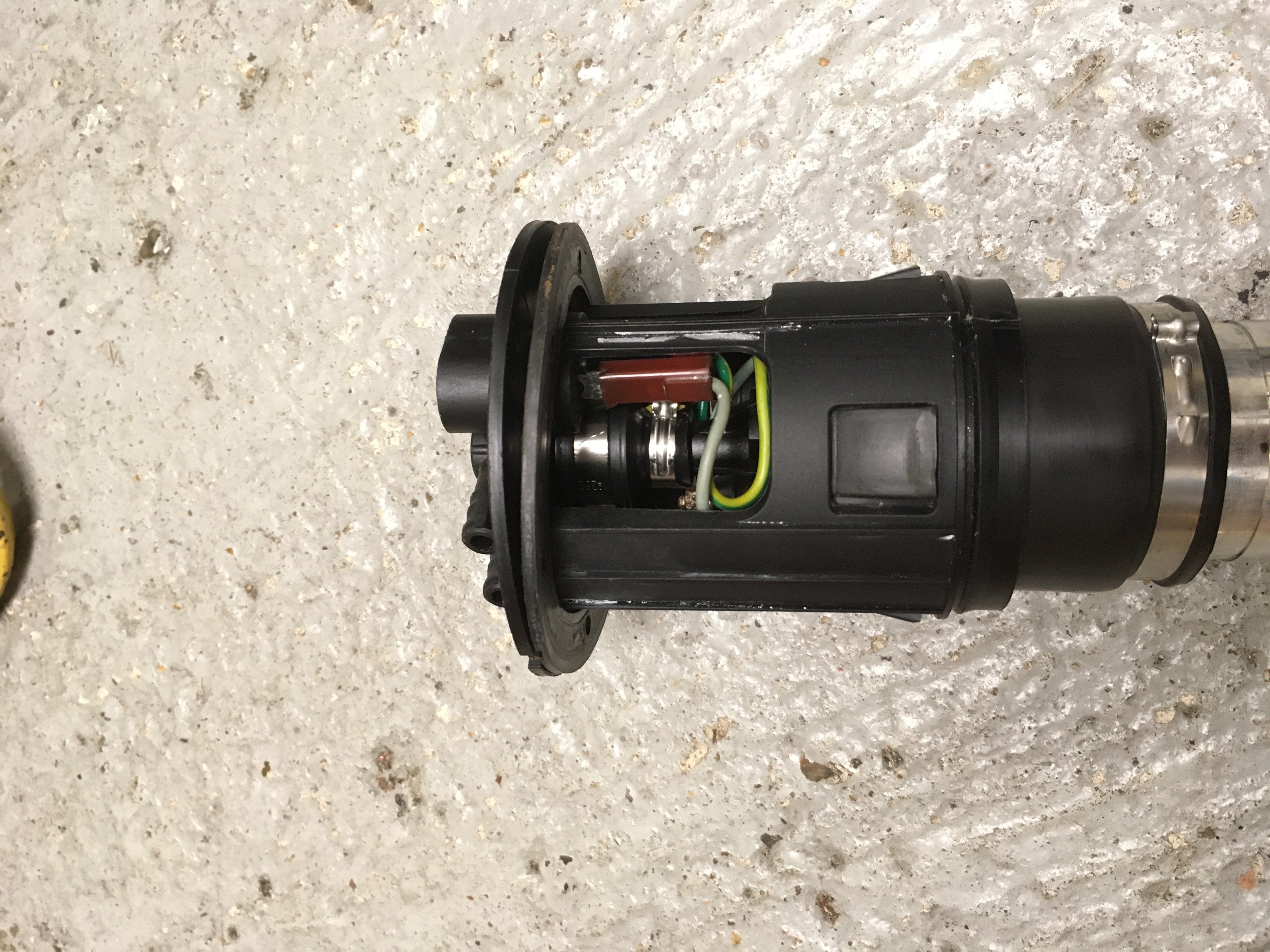

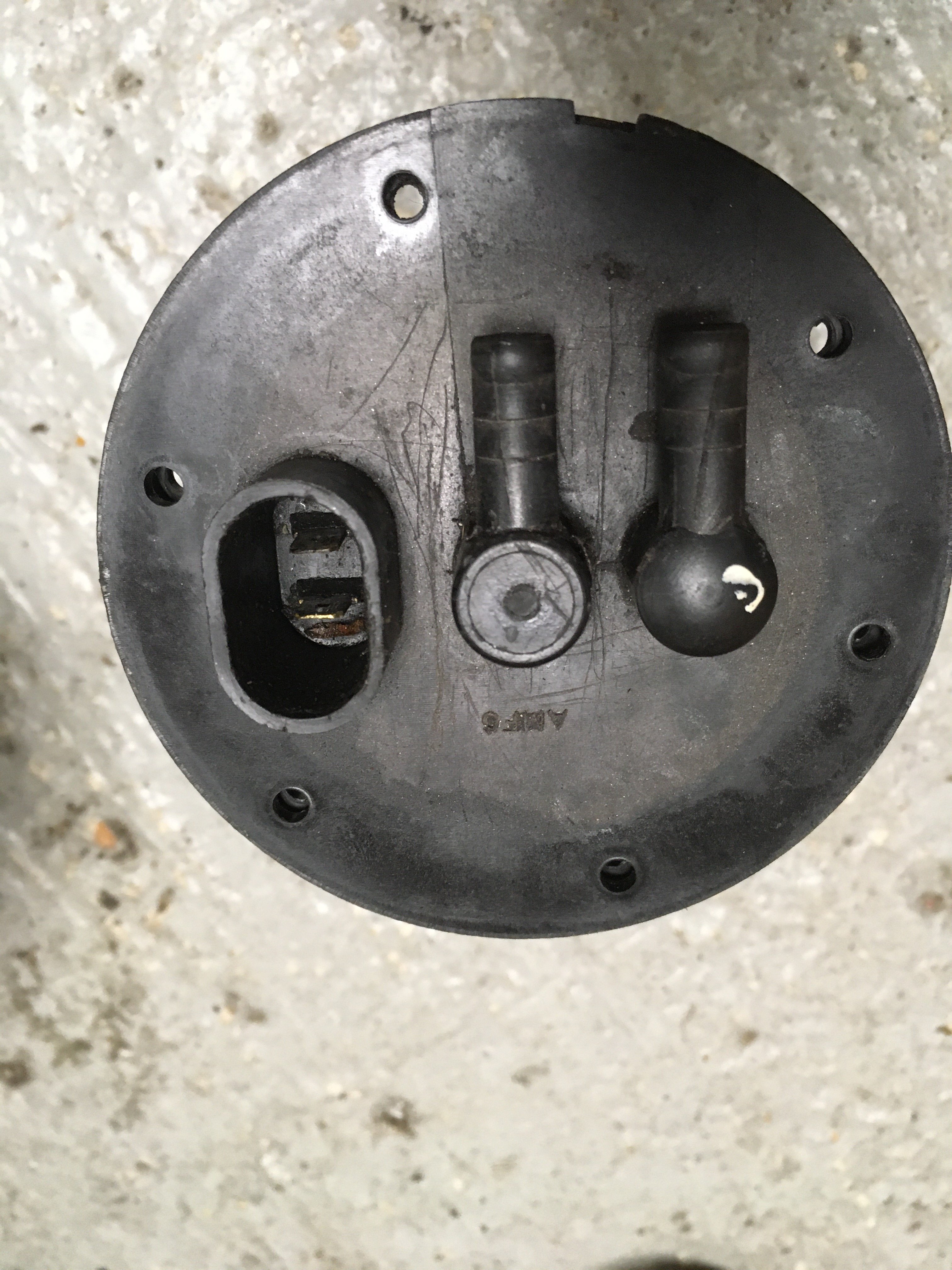

wiring looks original but the top of the pump has been messed with.
SootySport
Top of the pump is a moulded piece of PVC so can’t have been messed with.  I’ve tapped The pump many times on all sides and it just turns very slowly so well gummed up.

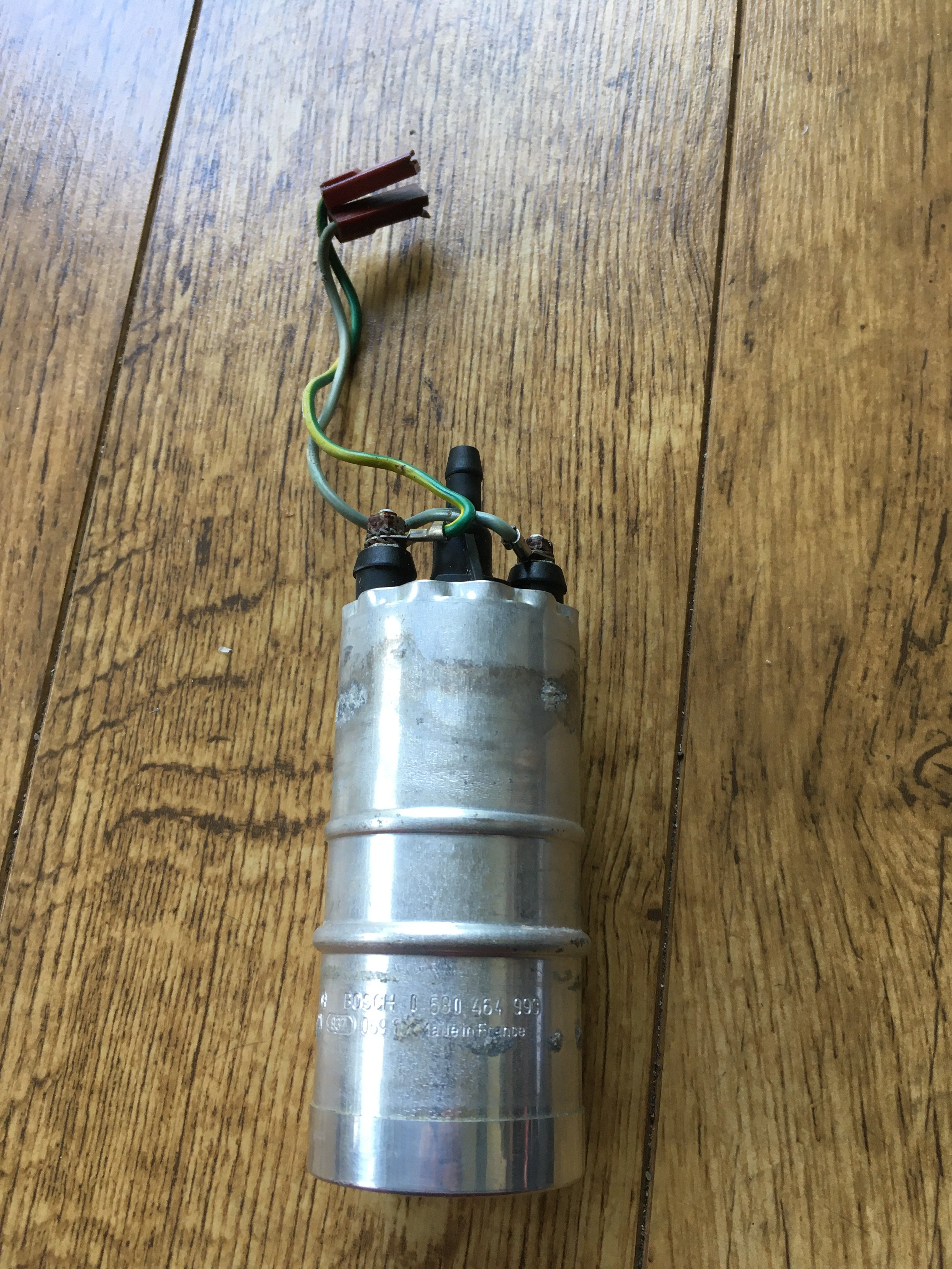

Taken the pump assembly apart now and the part number is Bosch 0 580 464 993, might help others if they need to order one, there is a few available on EBay @ £86 ‘ish, I have ordered mine.

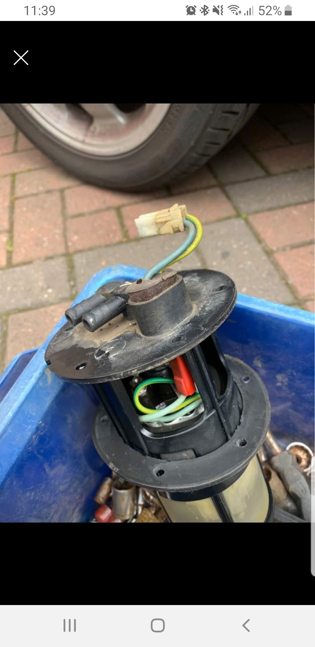

definitely messed with, it should look like this with potted wires and a fly lead.

See what you mean now, although it’s just an uneccessary extra connection. My loom goes straight onto to the spade terminals.
