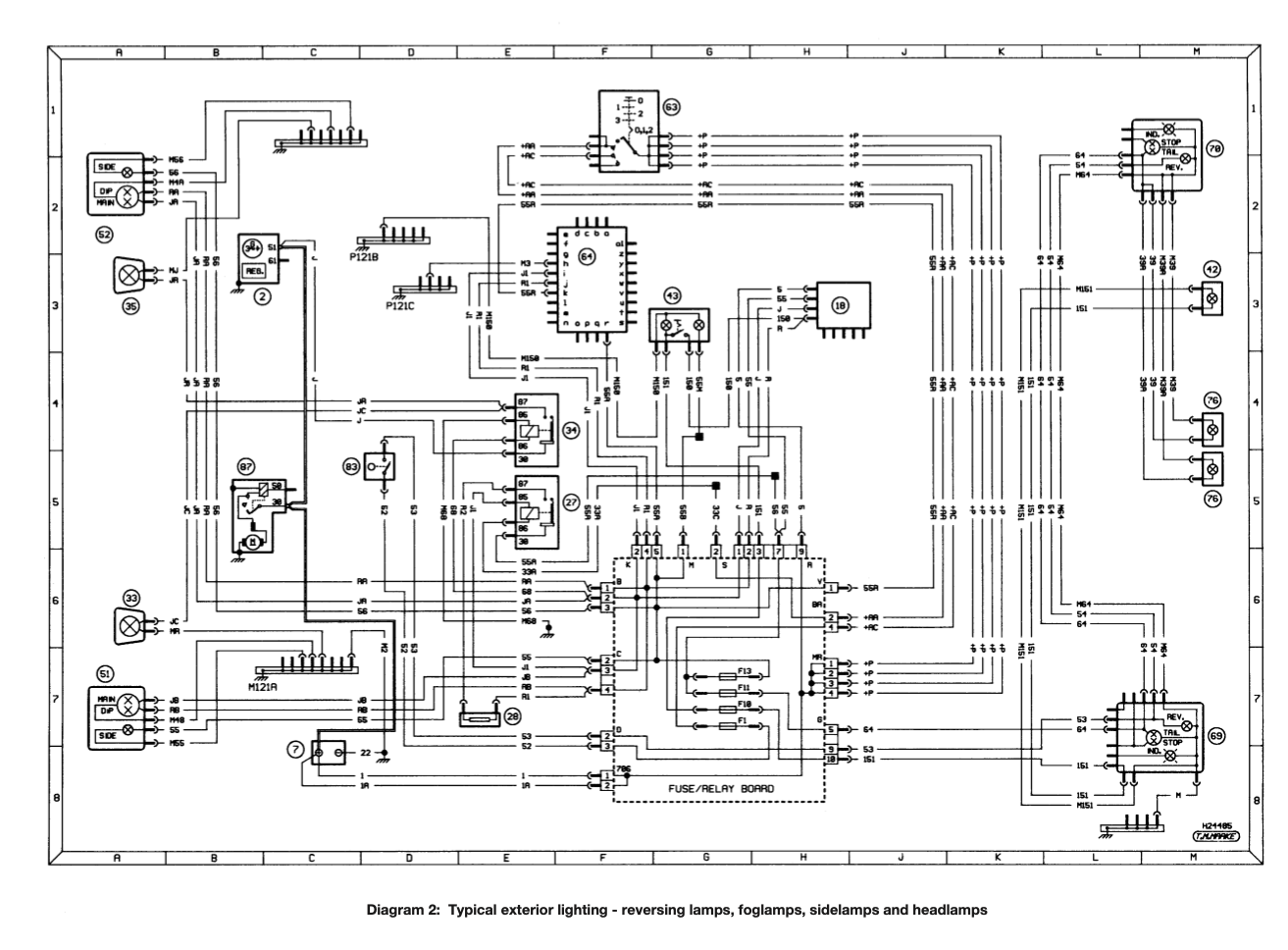

jackherer 543 Posted June 14, 2020 I'd never given it any thought but it looks like it breaks the live side in the Haynes wiring diagram. The switch is 83 and the tail lights are 69 and 70. Share this post Link to post Share on other sites

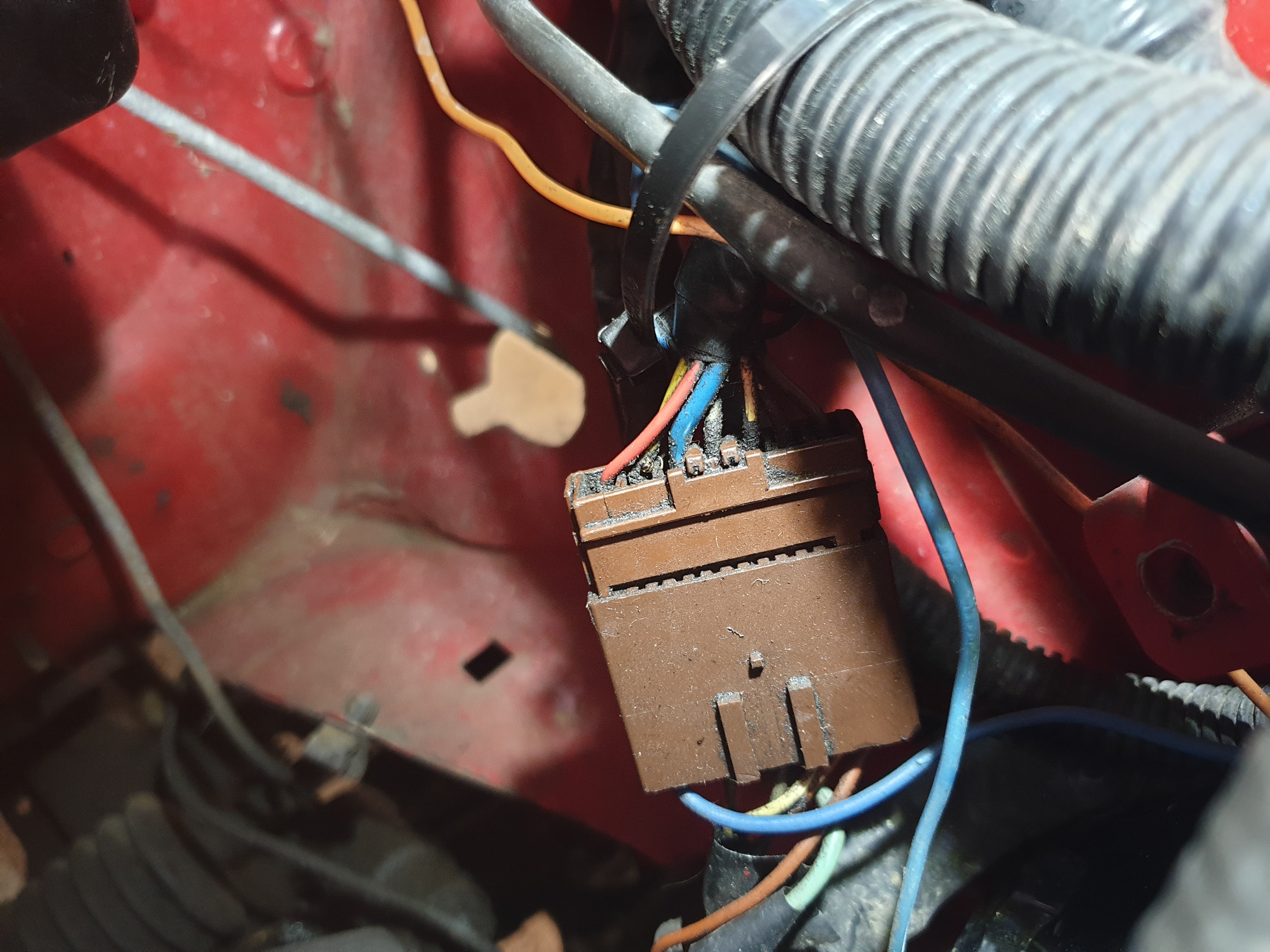

kes205 0 Posted June 14, 2020 Well I checked the plug connecting to the reverse switch and either wires are not recieving any voltage with the ignition on or or off. Think it must be some wiring errors in the conversion. Just trying to work out the engine bay wiring now. Found the brown multiplug the v6 loom seems to be spliced into. Just need to work out each wire. Share this post Link to post Share on other sites
welshpug 1,737 Posted June 14, 2020 that looks rather shonky the brown plugs i mentioned are under the dash near the steering column by the side of the heater box. Share this post Link to post Share on other sites
kes205 0 Posted June 14, 2020 Yeah dont think it's the best to be honest. Will need to look at sorting it all or getting someone to create new loom etc Share this post Link to post Share on other sites
