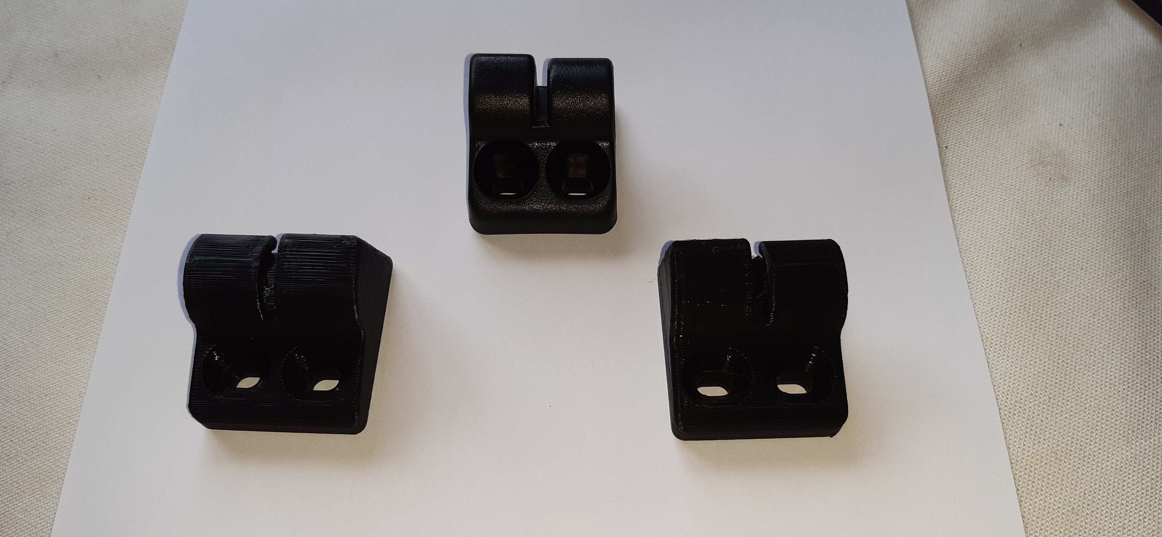

My own creation copied the best I could from a single side and mirrored for the other.
https://www.thingiverse.com/thing:4386683/files
Not sure if they'll be strong enough in PLA, Maybe better in ABS?
Let me know if anyone uses one and how it goes as I dont have a GTI to test them.

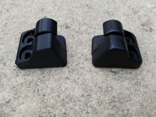

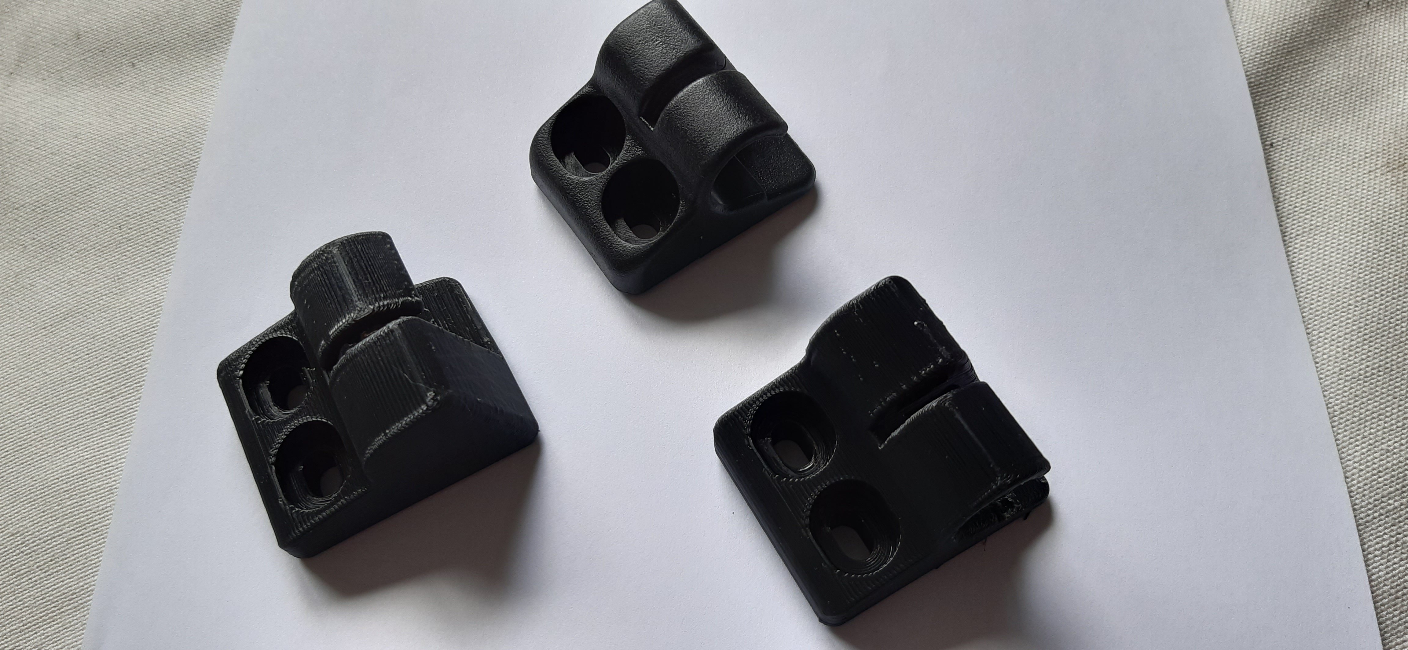

Print these on the flat edge so the hook part is printed on the bed first, not as the above photo these were printed on the base with the handing written on it. These ended up been weak as the z axis lines are aligned with the part that is stressed.
See photo below using a resolution of 0.15mm using my CR10S. Print with supports everywhere.
