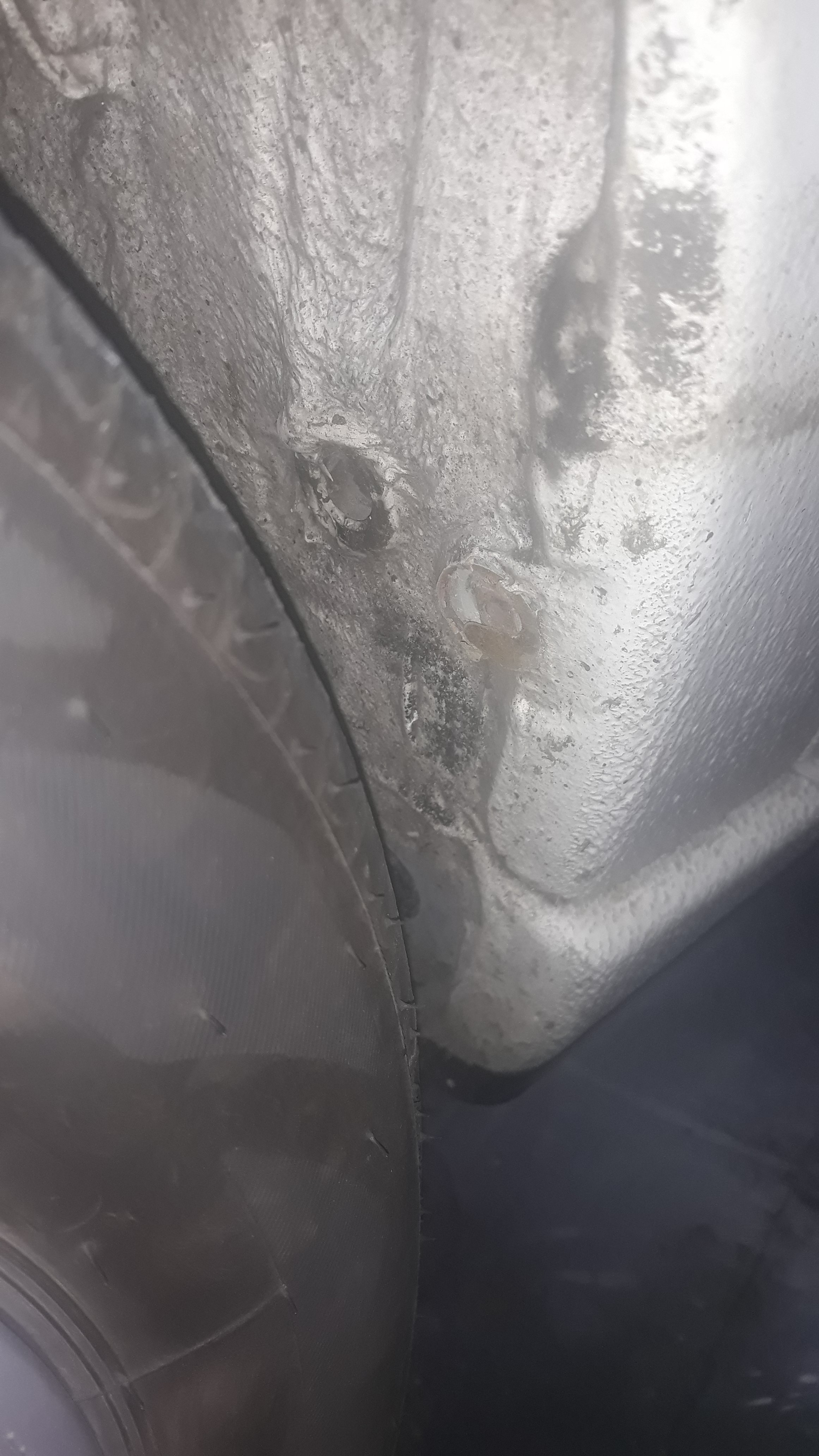

SWINNEY 2 Posted May 17, 2020 Hi can anyone tell me what sort of bolt/ washer/ screw should be holding the little arch clip on as mine appears to be missing on both side i suspect my car had mud flaps fitted at some point Share this post Link to post Share on other sites
welshpug 1,622 Posted May 18, 2020 m6 screw, 10mm hex head with a captive washer, same as the top edge of the wing. Share this post Link to post Share on other sites
SWINNEY 2 Posted May 23, 2020 M6 doesn't fit and M5 is too small Share this post Link to post Share on other sites
welshpug 1,622 Posted May 23, 2020 m6 will fit, probably needs cleaning out. Share this post Link to post Share on other sites
