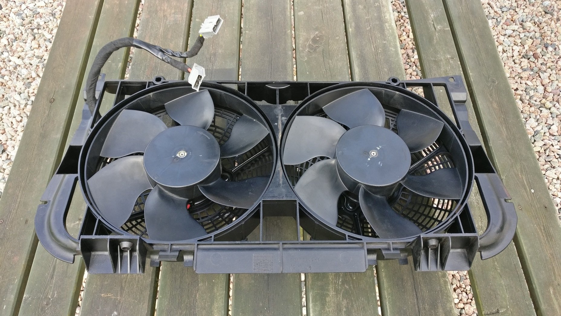

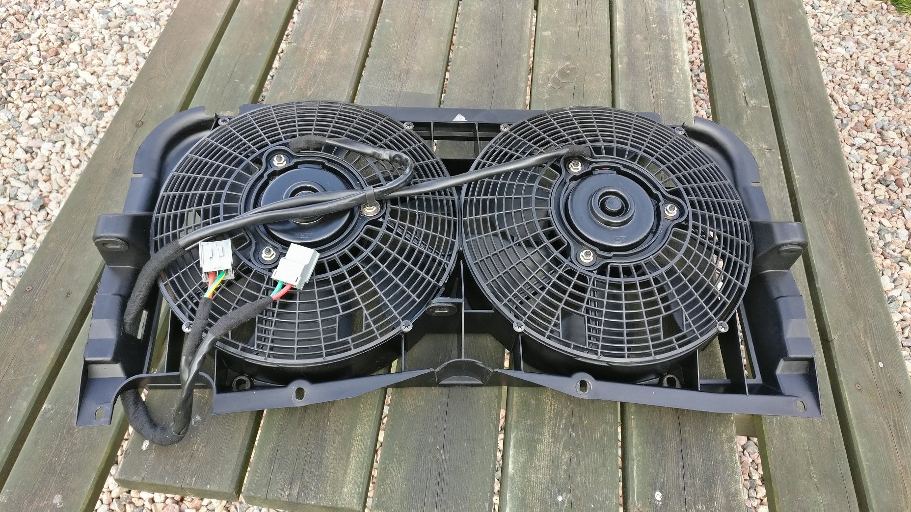

When I got my '89 1.9 GTI last year I later discovered it already had the twin fans / heavier radiator and cowl from a TD fitted. The install seems to have been an old one from the 1990's and the radiators age meant it had sprung a small leak.
I now realise the twin fan set up is generally considered a pointless upgrade for normal UK driving but as it was already there I stuck with it.
I also now know it was only a partial upgrade as the original GTI fan wiring, including the resistor was still being used and had not been replaced with the TD's additional box of relays. Only one fan was being powered!
I've since added that extra box / removed the resistor etc. which probably wasn't working anyway, as it was crumbling apart.

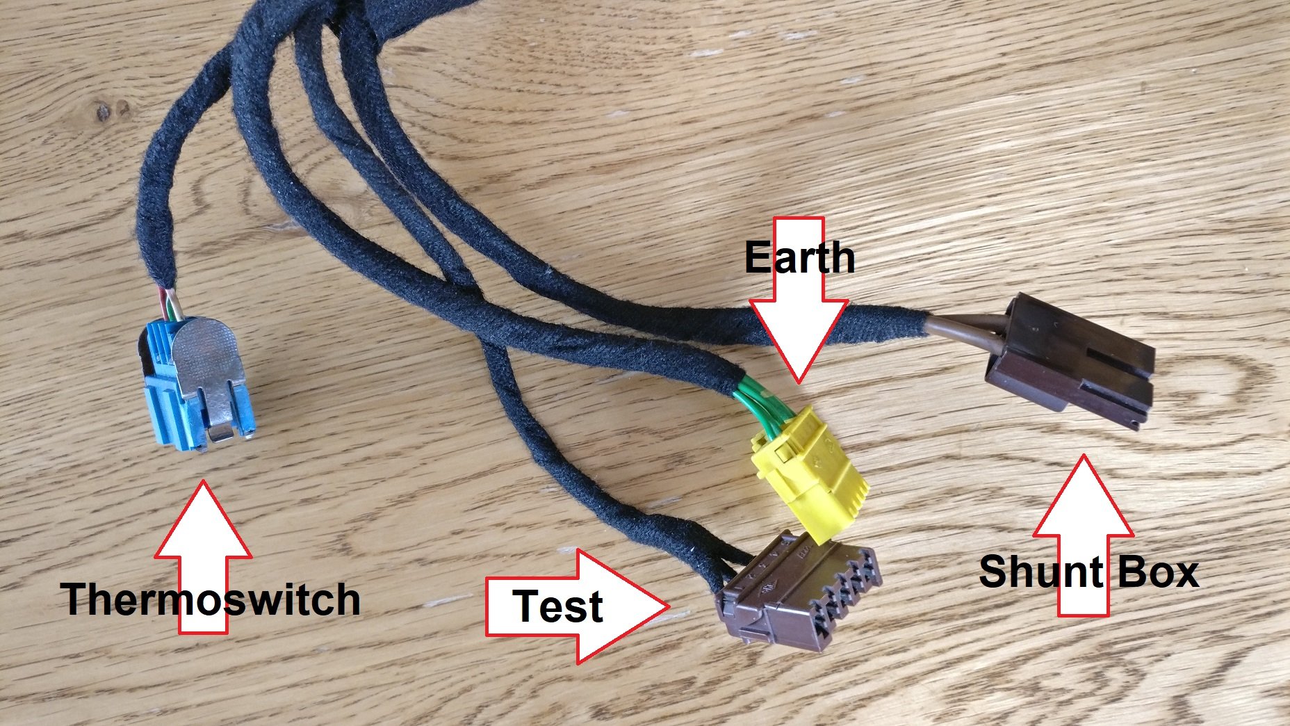

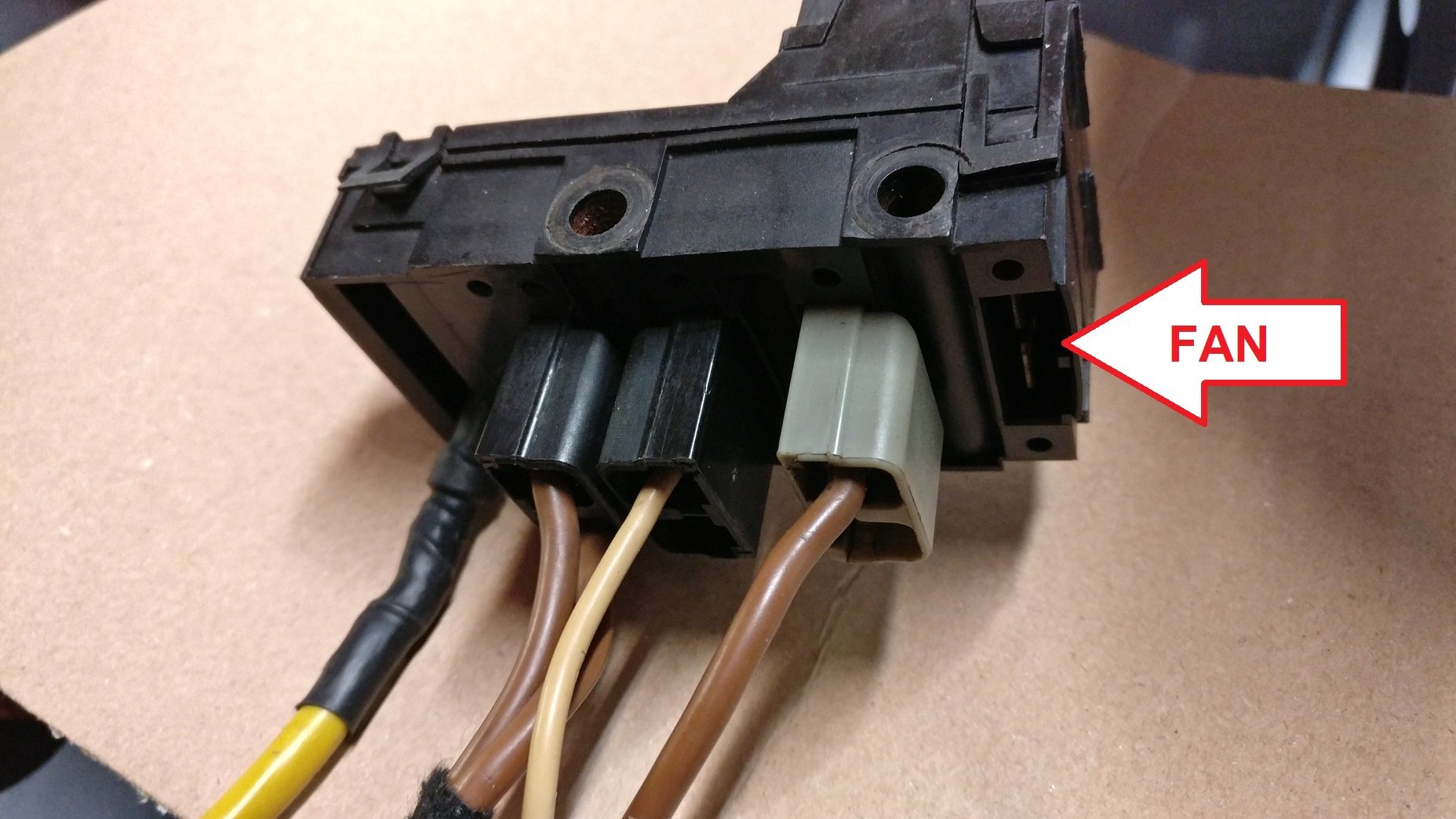

I've marked out where I believe the various connectors go on some of the images below, it's mainly the 2 pin brown one from the TD relay box to the GTI shunt box that I'm unsure about. There's only one remaining free slot so I'm perhaps wrongly assuming it's the correct one?
The brown test connector... Am I correct in saying it's just a case of bridging one or other of the two outer pins to the center pin to check each fans in turn? I already know they're working fine having connected them directly to a battery, but if they need checked in the future when back in the car it'd be useful.

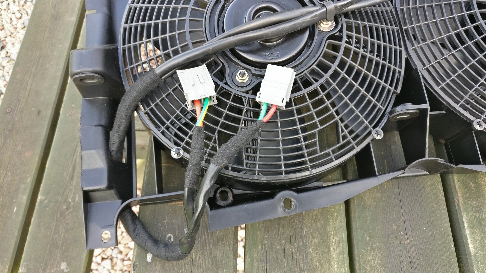

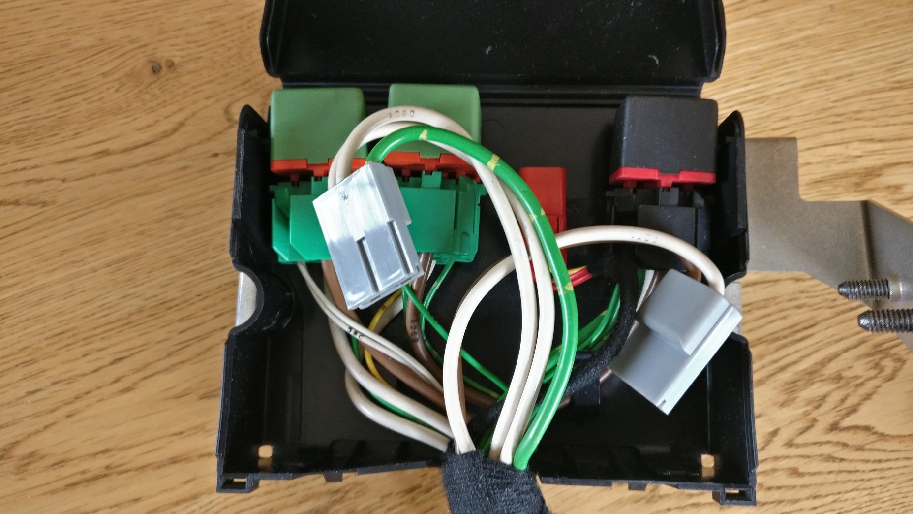

The leads with the grey 2 pin connectors from the fans themselves... their counterparts within the TD relay box - one has three wires coming from it, the other two. Is it immaterial which connects to which?
I'm guessing which ever way round you do it will determine which of the two fans is powered on and when, but that's presumably of no consequence?
The thermoswitch... the TD relay box came with one that has the range 92.5 - 97.5 stamped on, it's a purple banded one.

I've identified the previously unused 2 pin red connector in the car, which goes into the TD relay box... all's OK there.
The yellow earth block from the TD relay box... I believe it goes to the earthing block behind the nearside head light.

looks all in order yes, make sure it has an 83 degree thermostat installed not an 89 degree one.
with a single fan I'd be using the lower TD fan switch but as its a twin fan arrangement you'll be fine on the slightly higher gti temp, probably rarely switch to the higher speed!

The brown test plug has turned out to be useful and this is what it's showing -
One of the two test connections operates just one fan at high speed, while the other fan is idle.
The other test connection will operate both fans simultaneously, but each is at low speed.
Is this what I should expect, indicating things are working as they should be?
bacardincoke
Let her sit idling for 10 - 15 minutes and the temperature gauge went up to just short of the mid position and stayed there.
Both fans then eventually kicked in at low speed for less than a minute then off again, and repeated that cycle, so everyting seems to be spot on... finally!
