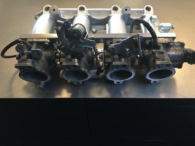

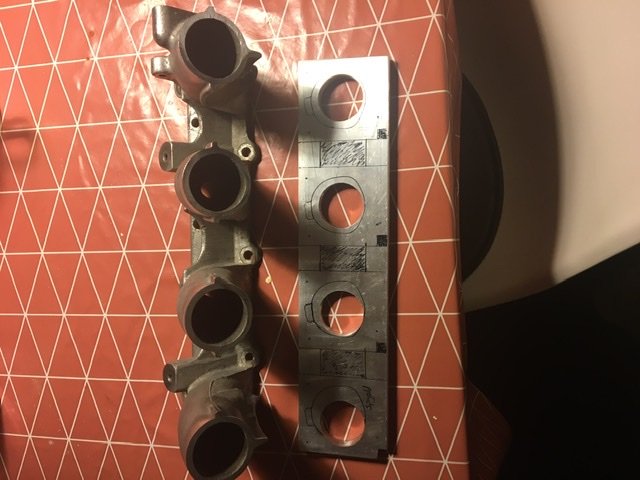

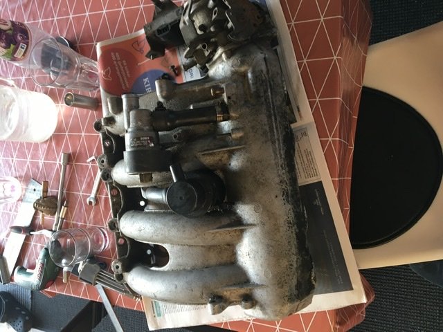

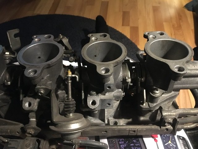

mmt 15 Posted March 26, 2020 Some years ago I bought some ITB from a 4-age Toyota Blacktop engine. In the storrage I also had an old Mi16 inlet manifold. Share this post Link to post Share on other sites

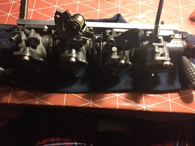

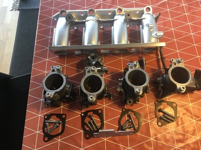

mmt 15 Posted March 26, 2020 Started out cleaning the ITBs. Tootbrush and oven cleaner. Share this post Link to post Share on other sites

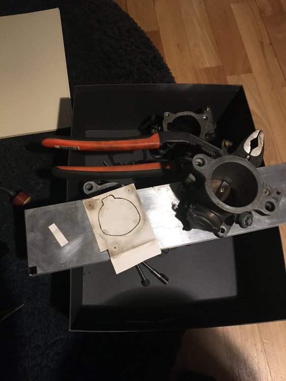

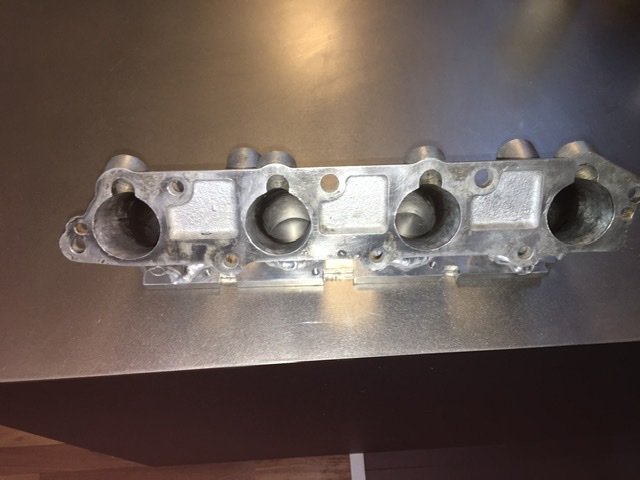

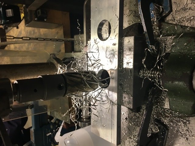

mmt 15 Posted March 26, 2020 Next I made the mounting plate for the ITBs. This was a lot of work. Meassuring, drilling and cutting. At the same time I Cut the Mi16 manifold. Share this post Link to post Share on other sites

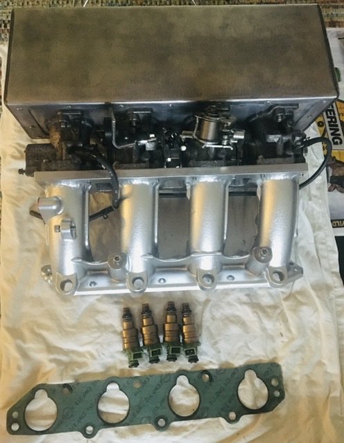

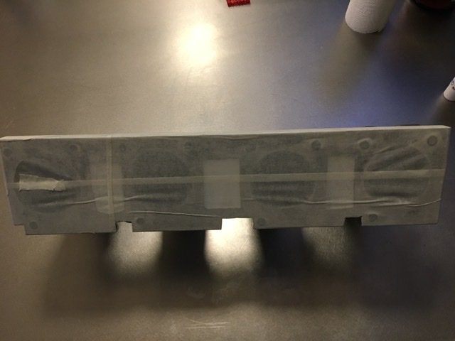

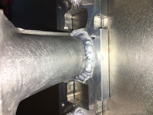

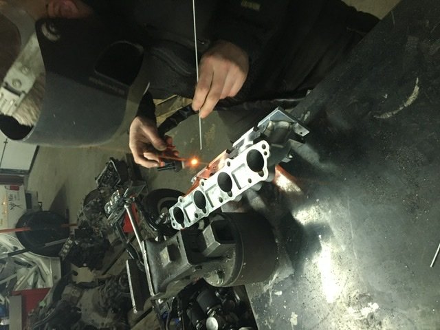

mmt 15 Posted March 26, 2020 Next up was preparing for the mounting plate to be welded on to the Cut manifold - welding, painting and mounting the ITBs Share this post Link to post Share on other sites

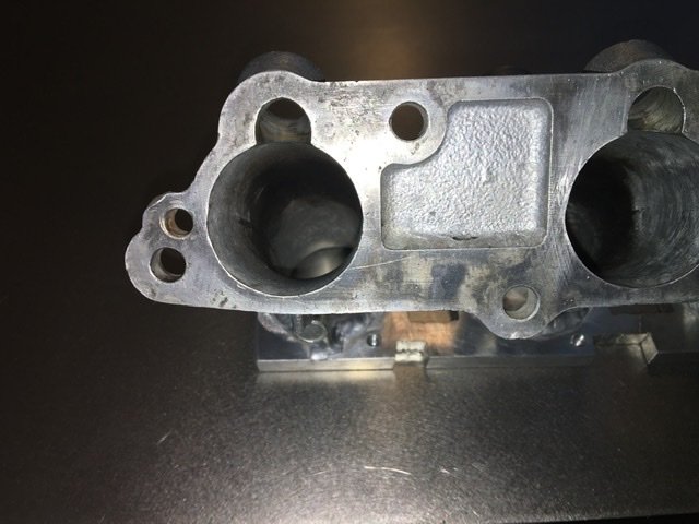

mmt 15 Posted March 26, 2020 Dremel time. Mating the ITBs Withers the manifold Share this post Link to post Share on other sites
mmt 15 Posted March 26, 2020 More cleaning / Sponge bath Share this post Link to post Share on other sites
mmt 15 Posted March 26, 2020 Putting it together. Also I needed to make a ToyPeu throttle cable bracket. It fits the holes on the ITBs and uses the Mi 16 throttle cable. Share this post Link to post Share on other sites

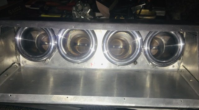

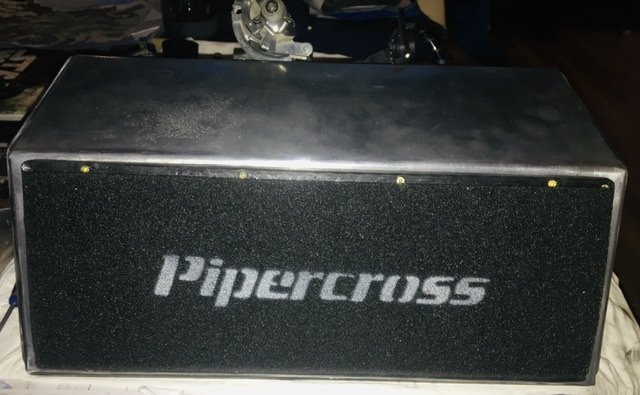

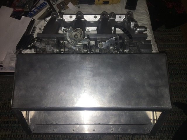

mmt 15 Posted March 26, 2020 Many years ago I bought an Air box from another gtidriver. The airbox was made to fit Webers- Cut out the back plate and made a new one to fit the new ITB setup. Also needed to fit the Peugeot Air temp Share this post Link to post Share on other sites

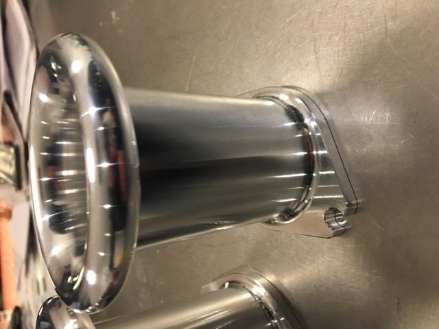

mmt 15 Posted March 26, 2020 Shiny stuff arrived from Australia. 100 mm stacks one-piece alu. Nice. Share this post Link to post Share on other sites

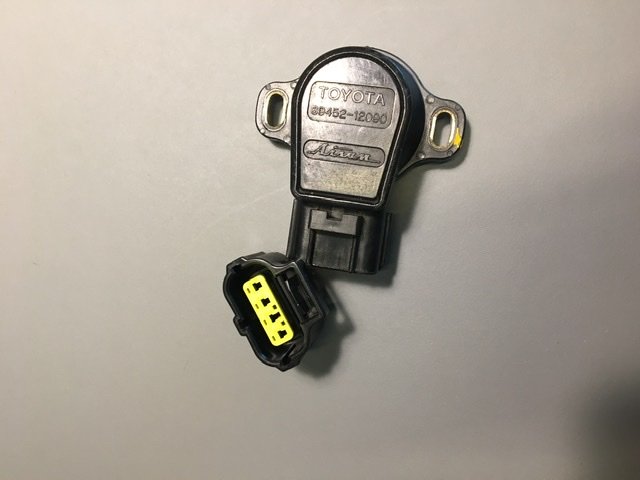

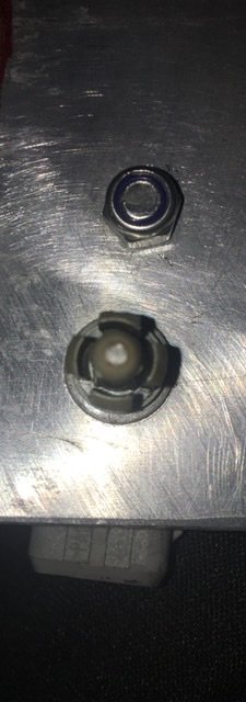

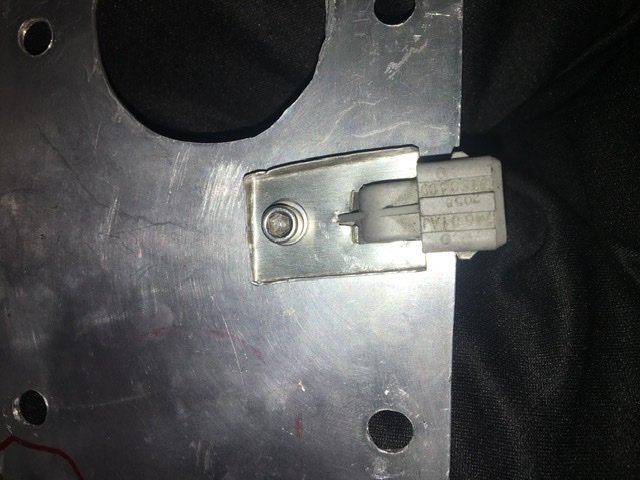

mmt 15 Posted March 26, 2020 Sourced a connector to the TPS. The local Toyota dealership parts guy loved sourcing something special. He had to go into old books (real papir books!) to find the right part. Share this post Link to post Share on other sites
mmt 15 Posted March 26, 2020 Next up was filter for the airbox - this time the Italians are up. Filter comes from a 1994 Fiat Punto. Share this post Link to post Share on other sites

petert 616 Posted March 26, 2020 Love your work. Although I think you need more AC balance in order to deepen the penetration on that fillet weld! I've done exactly the same with two Nissan R32 TB's and an Mi16 manifold. Share this post Link to post Share on other sites

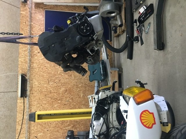

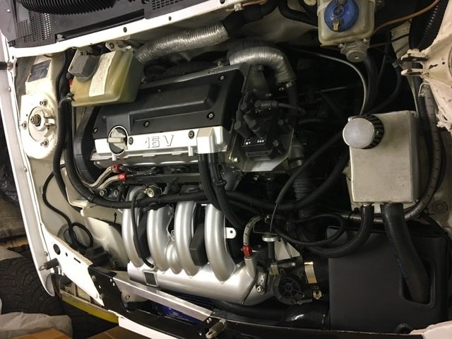

mmt 15 Posted May 16, 2020 (edited) DONE! complete install done. Borrowed a freinds lift and crane- I’m getting too old for crawling around on the floor. Edited May 16, 2020 by mmt 1 Share this post Link to post Share on other sites
