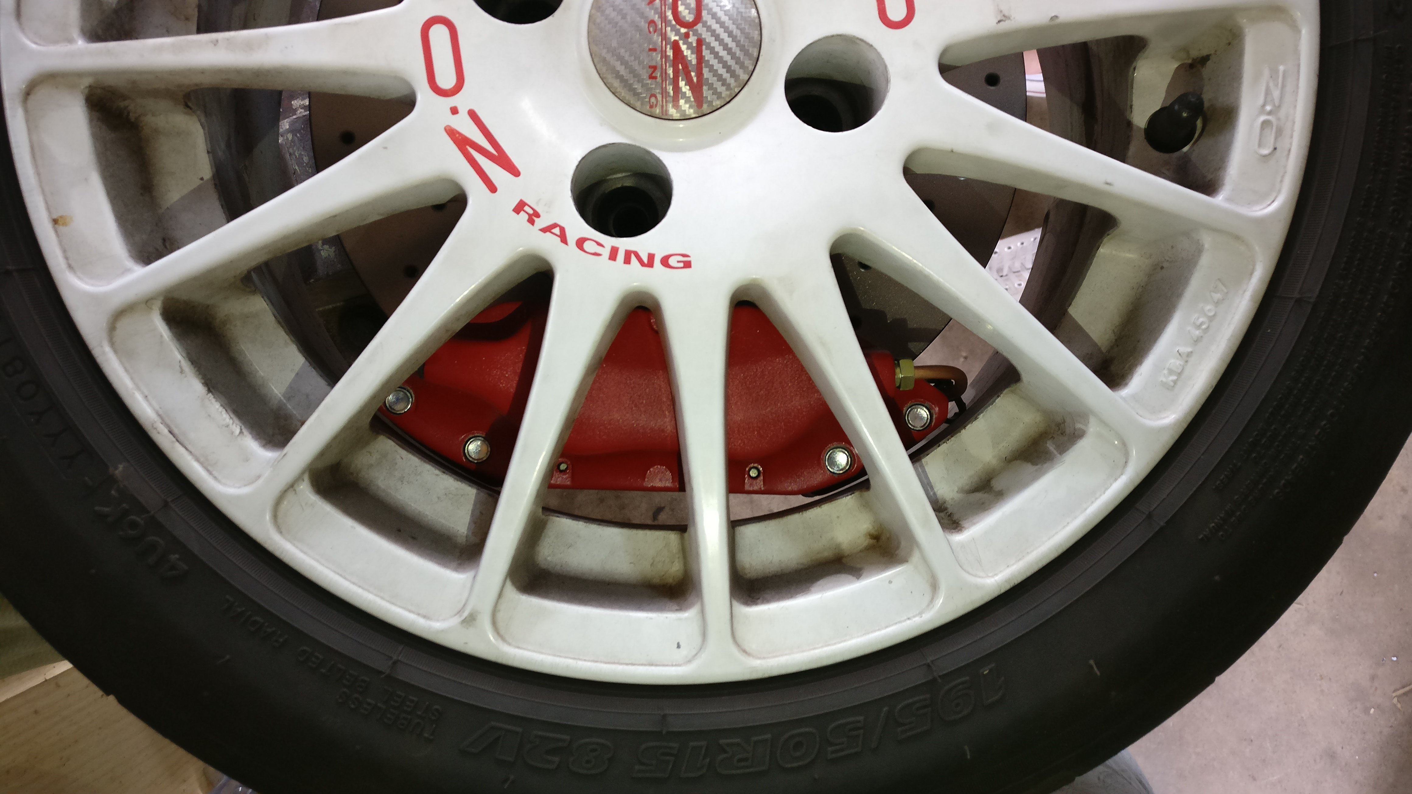

Planing to use the brembos on my upcoming TCT project too. Had them trial fitted on a hub with my 15" OZ Superturismo...it's a tight fit and needs some small spacers.

Cheers for the replies the speedline sl434 are really nice. Didnt think about changing the calipers. Shall have a look at the speedline and oz wheels. Sorry for stupid question does the spacer go on the wheel or a
 shim for the caliper.
