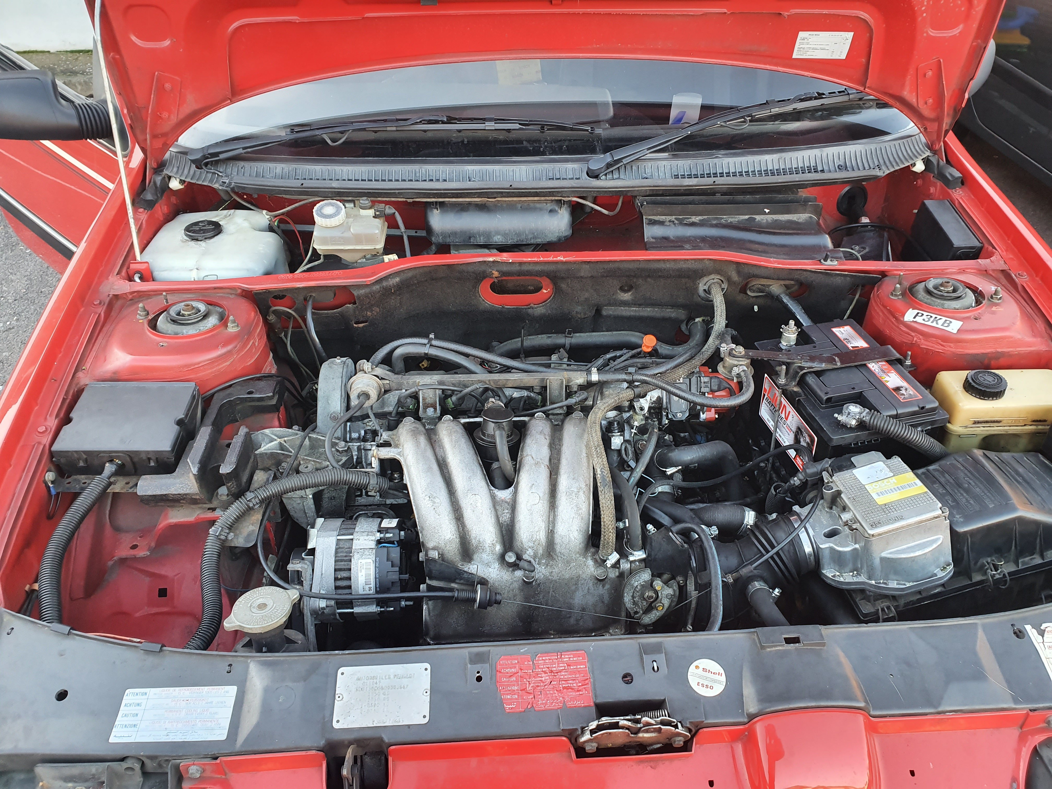

What year is it? BXs changed from Jetronic to Motronic in about 1991 IIRC.
A photo of the engine bay would answer that question (and more...)
Basically if it is an early Jetronic setup then it uses a 205 GTI Jetronic tachymetric relay, and if it's a later Motronic one it uses a standard automotive relay.

This is the engine

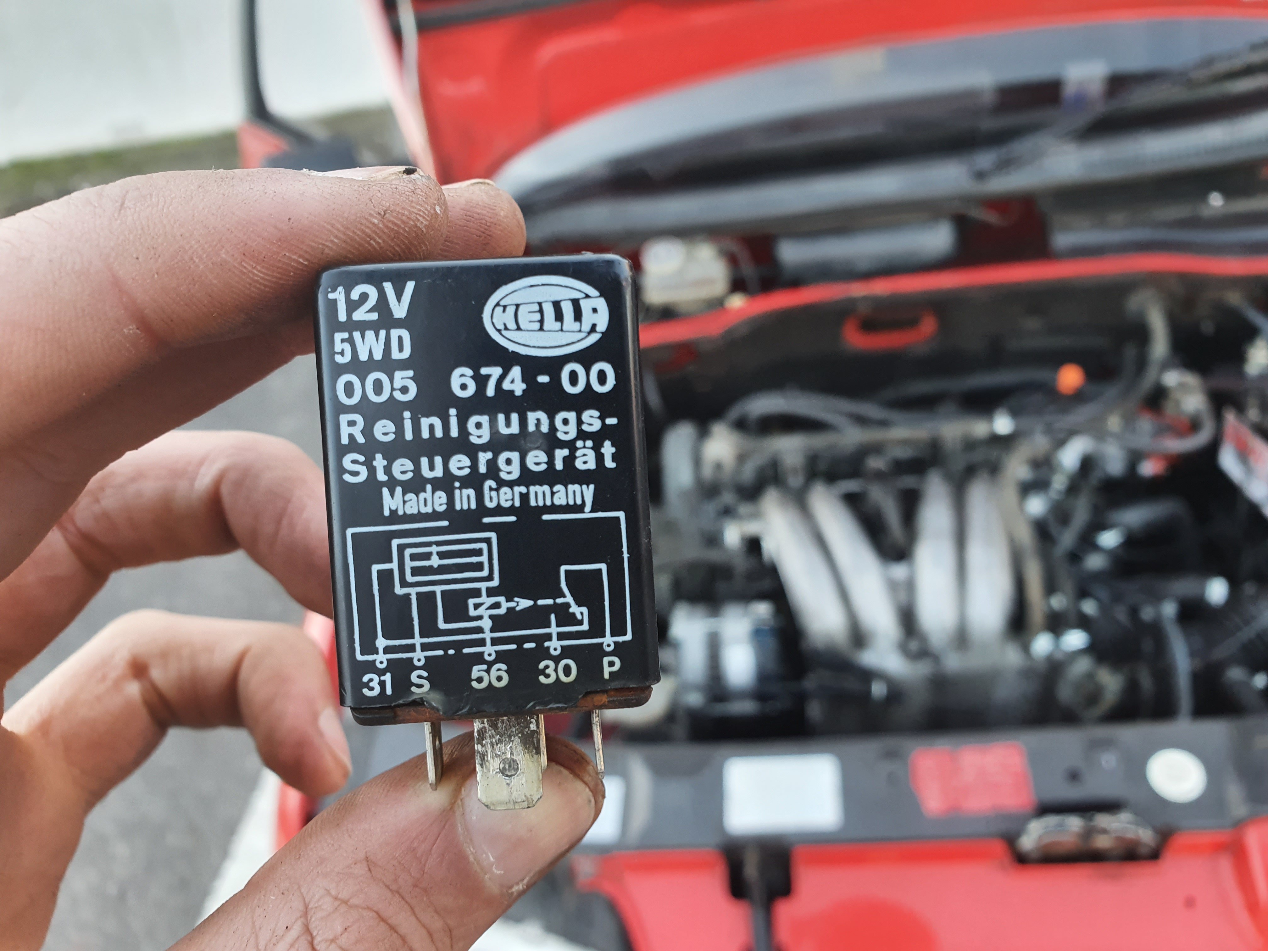

This is the relay I need. The one listed fir a 205 gti has different numbers on the pins to mine so not sure it will fit.

That's not the same as a 205 tachymetric relay, I thought they were the same but clearly not.
It's a much simpler relay so it should be a lot cheaper.

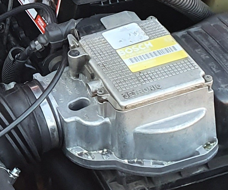

Yup , "ze Steuergerat" ! .. it is , the fuel pump relay .
And that is the Motronic 1.3 type AFM from what i can see on the pic ... certainly isn't older Jetronic type AFM body .. could be some mix of components on those 1.9 SRi's , haven't seen one for ages ..
Anyhow , Bosch replacement relay will be : 0 332 019 150 ... it's a 5pin relay , but not the "ordinary" 5pin relay which you'll find most often when looking for 5pin one .. as per this post (scroll down) should be 5pin but "dual output" type :
.. the Bosch 0 332 019 150 is a "dual output" , and costs around 2 or 3 quids ..

It would appear that this is not the fuel pump relay as it activates the headlight washers when I got it working.
It looks like the BX Jetronic AFM to me, it has the ECU built into it! Also it says 'Jetronic' on it when you zoom in.
Did the garage you took it to tell you that was the fuel pump relay? If so you should ask for your money back...
DamirGTI
... the shape of the AFM body made me think it's Motronic !
D
