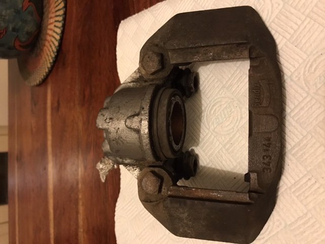

After allowing my errant son to drive my 205 GTi for the past 6 months he reported that it had run out of brakes. After opening the caliper and two backing plates completely devoid of any friction material fell out I figured I needed new pads. Worse was to come. After noticing one of the flexible pipes was weeping I figured I’d I needed new pipes too. So having removed the pipe together with the caliper I decided to check the bleed nipples were free. You guessed it, the bleed nipple sheared off. So now I also need a recon caliper. When I checked the various websites with my reg number, they tell me I need solid discs. Mine are vented. Has my braking system been upgraded at some stage in its checkered history and if so how do I know what caliper / pads I need? I can’t find any part numbers on the caliper itself. On the bracket that attaches to the caliper it says 343144 and then Bendix. Any ideas please?

Hi Tom. Photo is of caliper showing only part number I can find. Neglected to take one of the disc.
The number is a casting number and meaningless.
Those are standard 1.6 GTI Bendix
calipers.
Try Brakes International in Rochdale.

Fab. Thanks Tom. I’ll give them a call tomorrow and let you know. Cheers. Dave.
