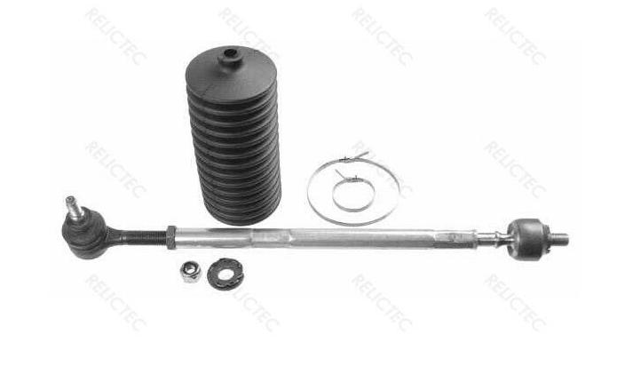

That could still be the inner track rod ball joints by the sounds of it?
They are easily replaced with the rack in place. You can buy the entire kit above or individual parts, there are four ball joints in total, two each side so make sure they are good before you change the whole rack.
stewal
Many thanks for this: I think you may be onto something as the mileage isnt sky high so would not expect the rack to be so worn.
i was only looking at the joints I could see,
so will take the gaitors off and take a look. Cheers.
