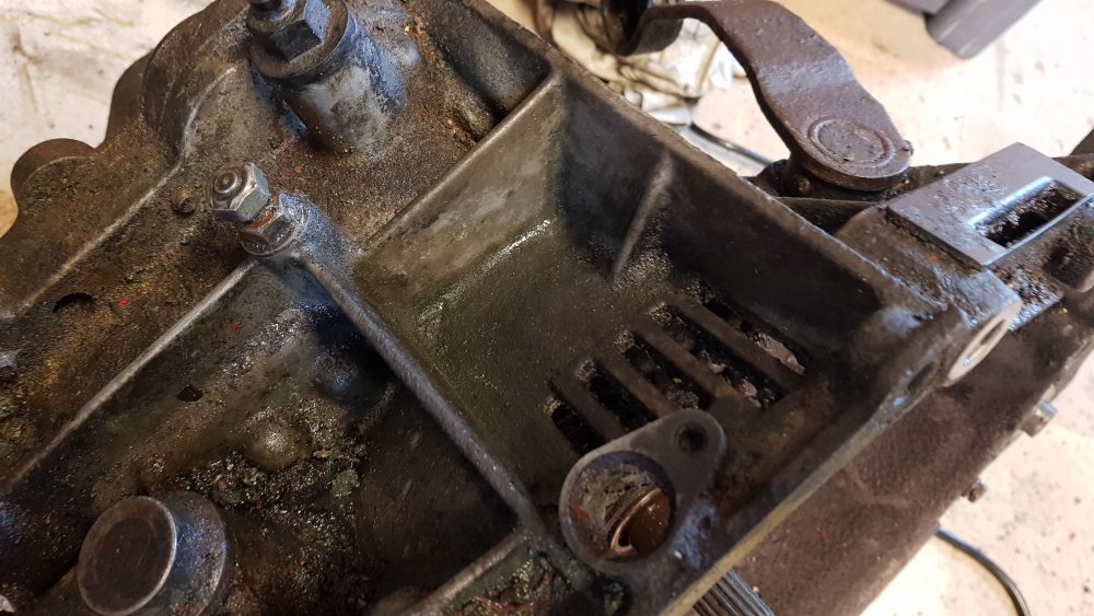

ian010778 21 Posted August 26, 2019 The results are in. I picked up some Gunk TFR yesterday so sprayed some neat onto a section of the gearbox. I left it overnight and got the steam cleaner on it this morning. Not quite the magic bullet I might have hoped for but it certainly looks a lot better. I reckon a couple of applications and some proper elbow grease it'll clean up nice ready for painting. I did put the steam cleaner on a different section that hadn't been treated with the TFR and it made no impact whatsoever! I have also seen online engine and gearbox painting kits that come with a degreaser that is applied by brush before the paint. This geezer uses such a kit - might be worth investigating if not too expensive (sorry about the massive video - the forum's HTML editor won't let me edit the video size). Ian. Share this post Link to post Share on other sites
SootySport 23 Posted August 30, 2019 Shouldn’t leave the tfr on all night, it dries out and doesn’t do much. Go by the instructions is best. 1 Share this post Link to post Share on other sites
