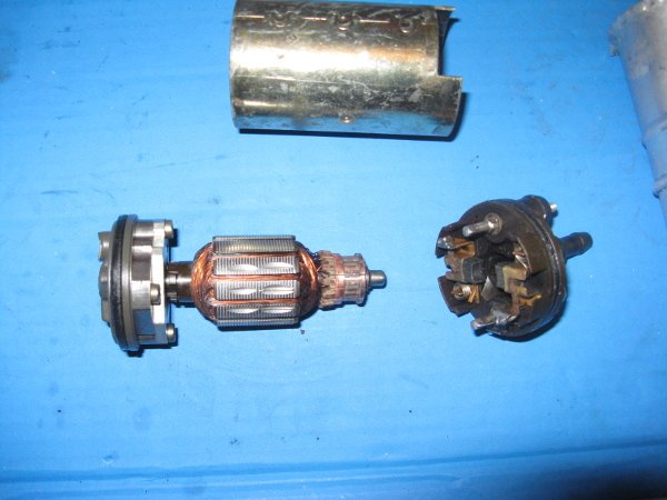

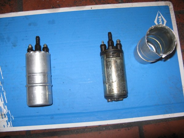

DamirGTI
There's two seals in the pump inside (if you strip the cylinder housing and pull the pump assembly out) , and if bad these can also be the source of pressure drop .. but me thinks he meant the "mushroom" shaped rubber grommet which connects the fuel pump outlet to the pump housing .

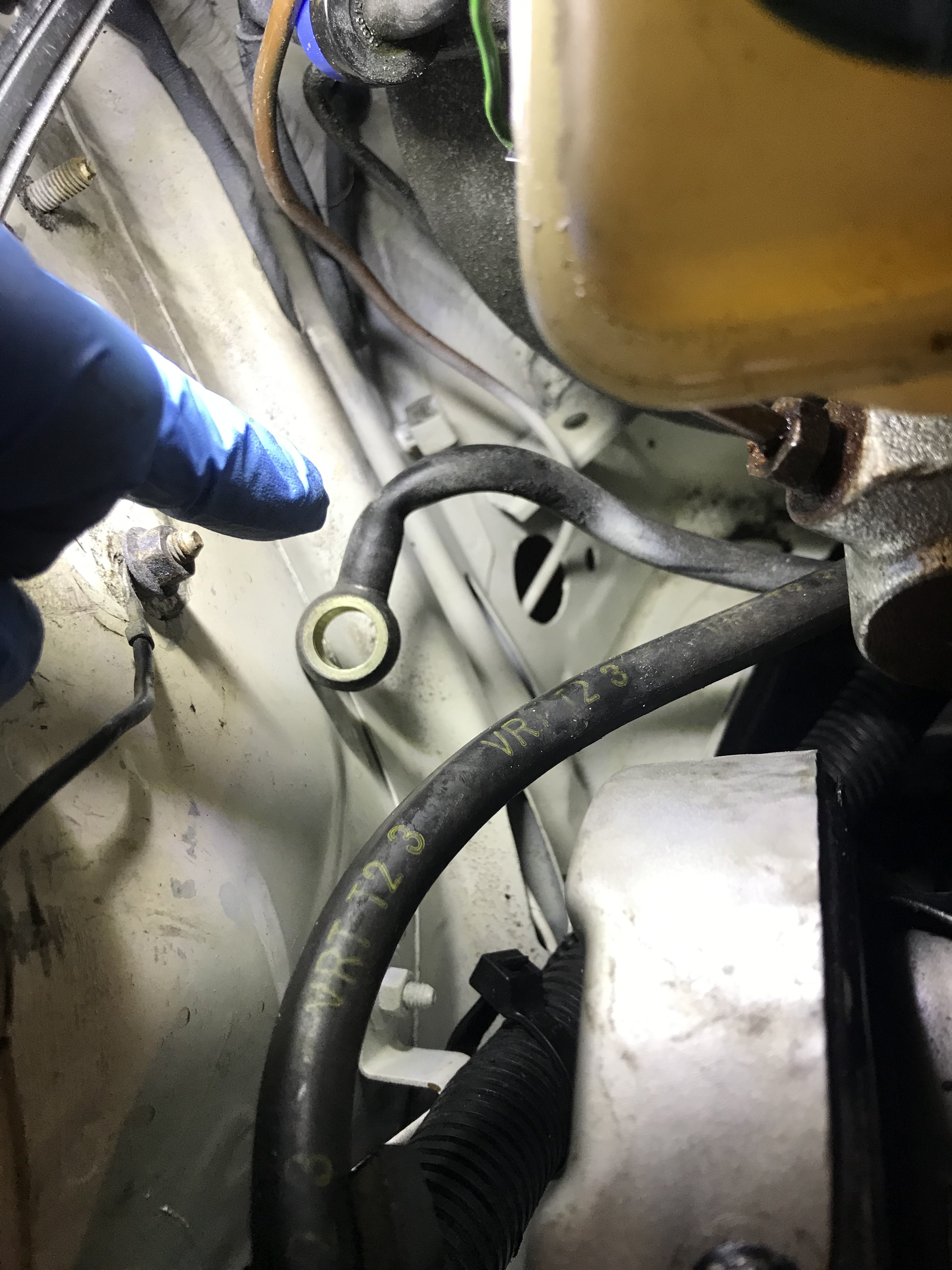

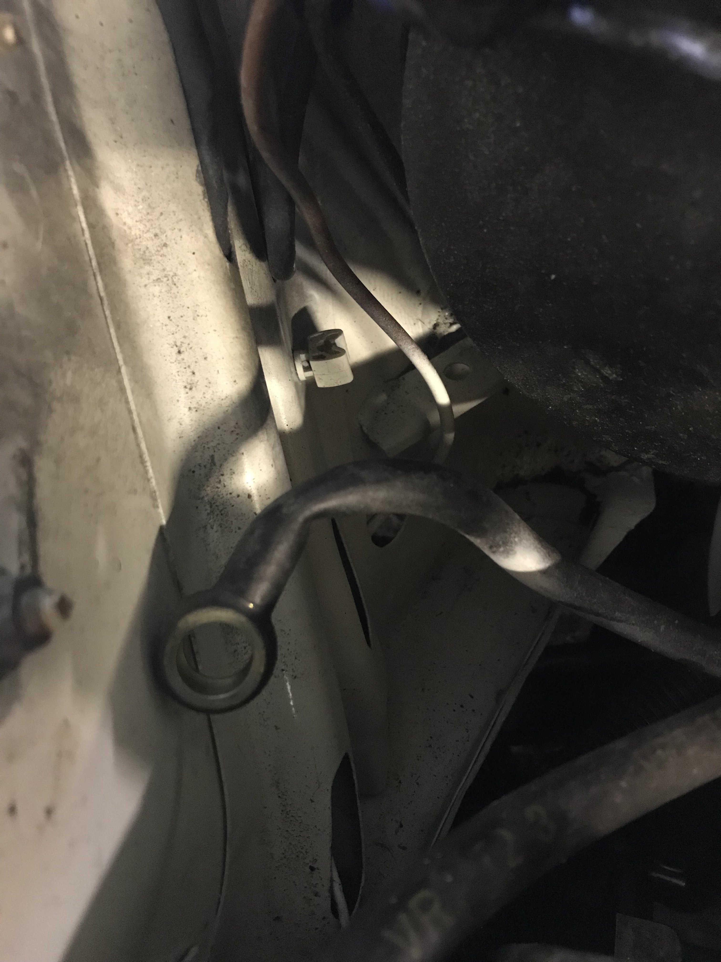

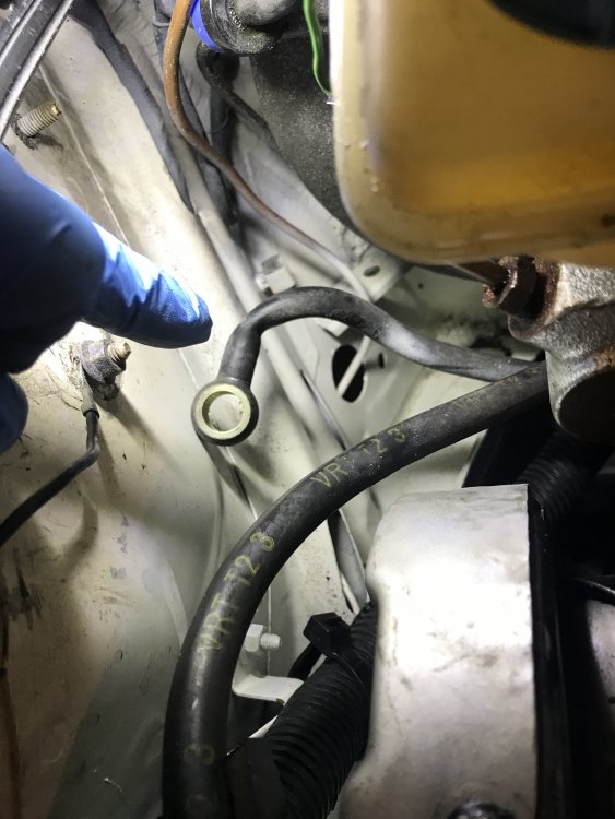

UPDATE
Finally fixed.
Ordered a fuel filter mainly to rule it out. As I went to remove it I notice the bottom hose at a slight angle. When I removed the pipes then realised it was totally bent. Obviously letting enough fuel through on idle etc but it was to be proved.
Fitted the new filter. Took it for a spin. In first gear when the car lit up the front tyres for the first time in a long time I knew it was sorted. Took it a blast and couldn’t stop laughing. Bit had a proper drive in this car for four years.

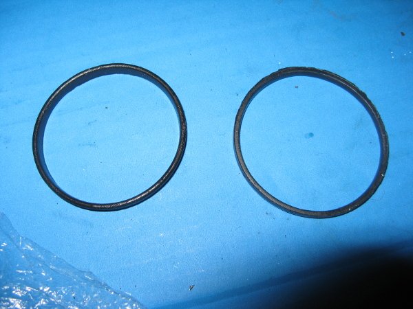

DamirGTI
  On 8/7/2019 at 10:25 PM, jackherer said:
I've never taken a pump apart before so I didn't know they had internal seals, do you know if they have them on phase 2s as well?
Yes , both the "roller-cell" (ph1) and the "turbine" (ph2) pumps have O-ring seals in between the core and the outer cylinder sleeve .
I remember two of my spare ph1 pumps needed longer cranking time from cold to build up the pressure to start the engine , if it wasn't the bleed valve i guess it could be the said O-rings going bad i.e. leaking pressure via the top or the bottom of the cylinder sleeve .
