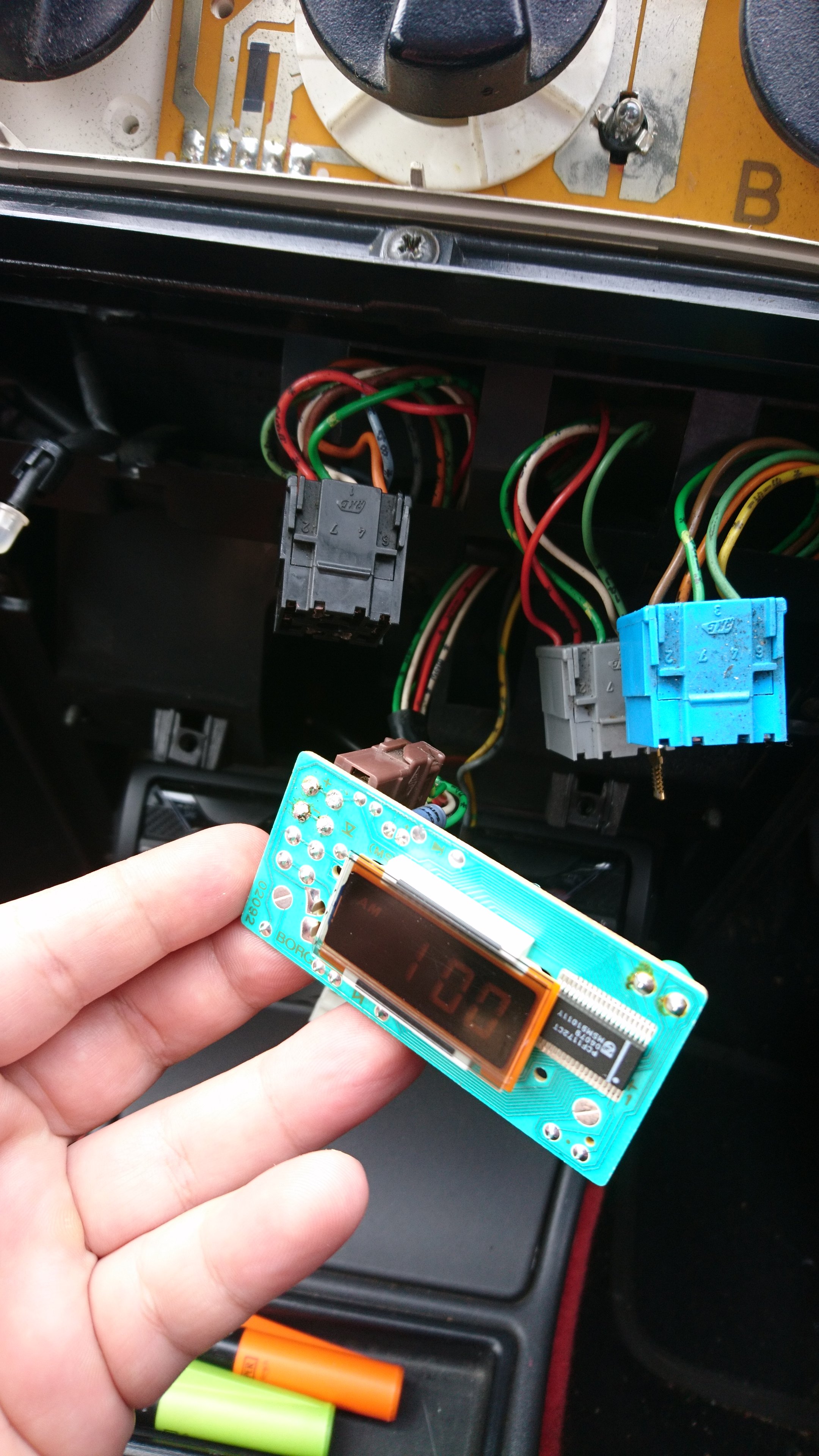

All Praise The GTI 3 Posted July 12, 2019 So my clock has worked perfectly for the short time I've been driving the car. Then I noticed this morning it's died. It's not the usual gone dark as bulbs gone as that's working it's done the complete opposite it's fully lit up bright so no numbers etc took it out and apart and see no obvious issues. can this be fixed? if not anyone got a new LCD or whole clock they don't want stupid money for please annoying as I've been fiddling with the stereo (which is now fully working) but the clocks died. Bloody typical! Share this post Link to post Share on other sites
Adamstanford 3 Posted July 12, 2019 Does the clock work if you wiggle the plug and wires on the back of it? I took mine apart and resoldered the connections, they had hairline cracks in barely visible. Clock now clocking. Share this post Link to post Share on other sites
All Praise The GTI 3 Posted July 12, 2019 Nope unfortunately not. I searched and found your old post actually and tried that. PCB looked ok by eye. It's weird it's lighting up fully quite bright no digits Atall. We do soldering at work under microscopes so il take it back out and look at the solder joints under a scope monday. Share this post Link to post Share on other sites
Thijs_Rallye 89 4 Cars Posted July 14, 2019 Resolder the PCB pins and it'll most likely be fine. The islands often crack of the connector posts. Share this post Link to post Share on other sites
All Praise The GTI 3 Posted July 17, 2019 So I checked the PCB under a microscope and behold there was a hairline crack on one of the connector posts. Resoldered them and still the same. It lights up but no numbers displayed Share this post Link to post Share on other sites
Adamstanford 3 Posted December 5, 2019 On 7/17/2019 at 7:34 AM, All Praise The GTI said: So I checked the PCB under a microscope and behold there was a hairline crack on one of the connector posts. Resoldered them and still the same. It lights up but no numbers displayed That's a shame it was an easy repair for me. Maybe a new clock is needed in your case. Share this post Link to post Share on other sites
