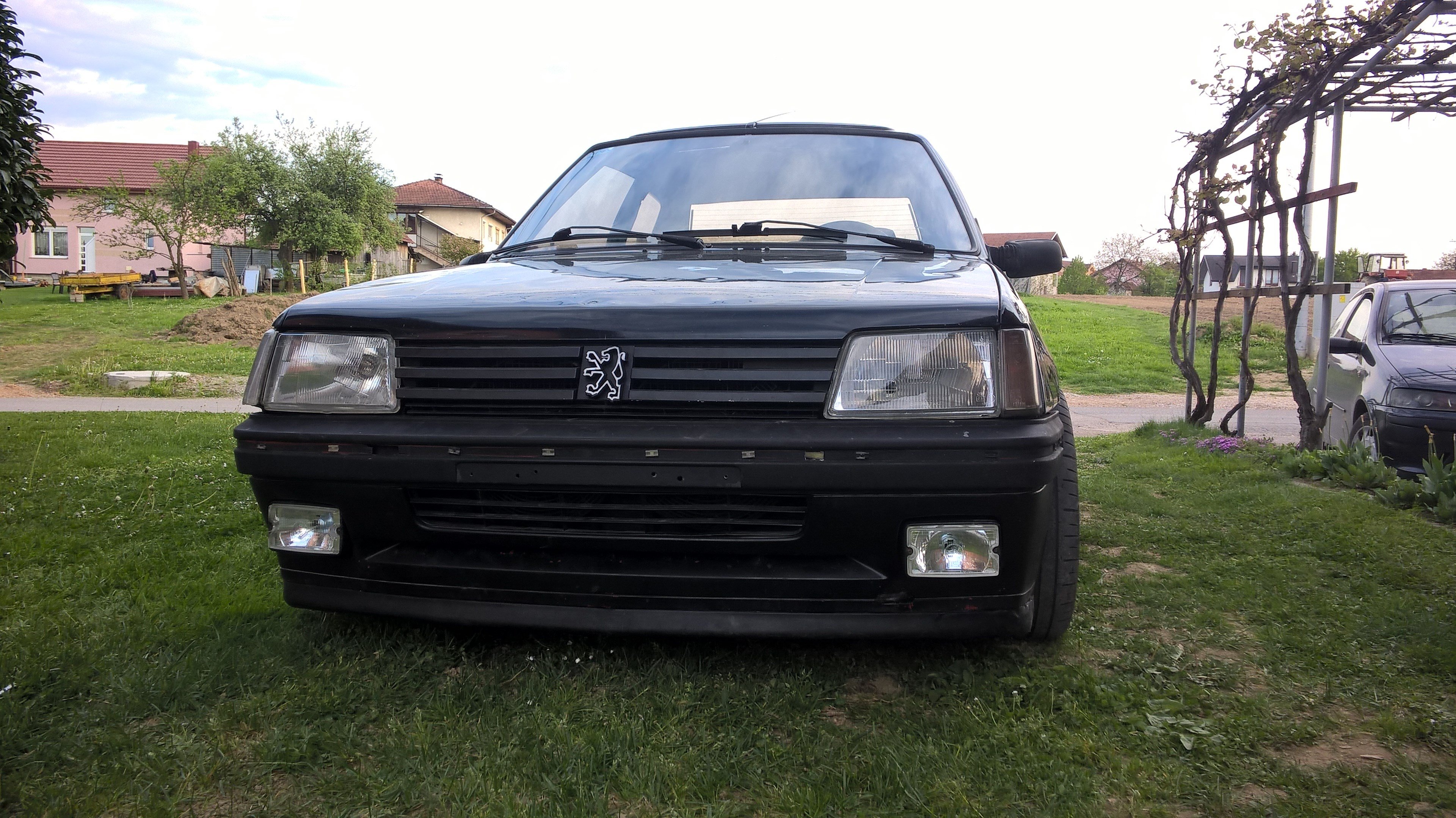

Hello.
Do you have any suggestions for further tuning on my engine?
The engine block is 1.6 B6D 117hp.
The engine head is 1.9 122 hp DKZ
Camshaft 1.9 130hp.
The complete installation of the engine is 1.9 122 hp MOTRONIC
Maybe it's getting from a car of installations to abolish a higher air intake airflower?
I'm not really the best in English, but I'm working hard with the help of an interpreter.

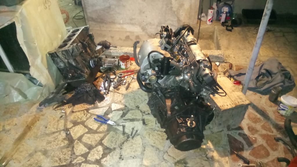

In this car, this is currently the eighth engine. It was 1.4 TU3S in chassis. Before the GTI engine was 2.0 TCT XU10J2TE, the third piston was burnt out of too much fuel. Now I have compiled this engine that I mentioned earlier, but I'm wondering if I can get even more power without being a piper cam or an ITB?

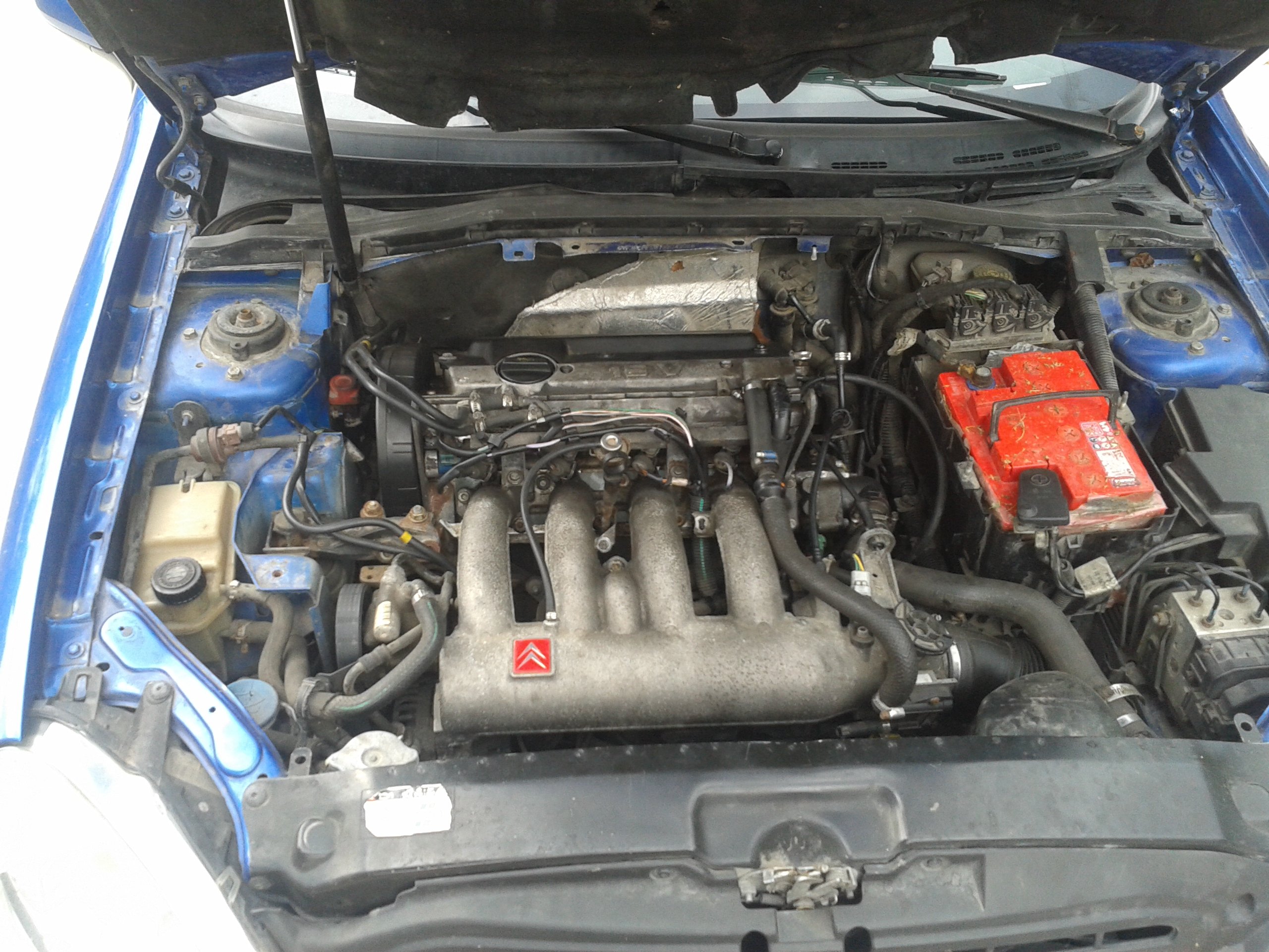

Today I bought xsara vts, I will put the engine in my 205. When I start working, you will be notified.
