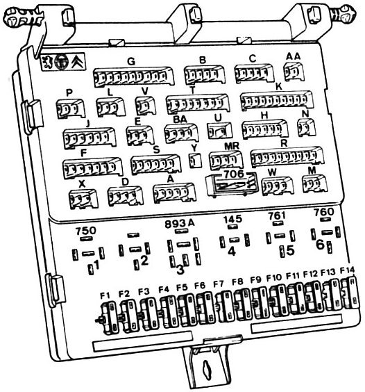

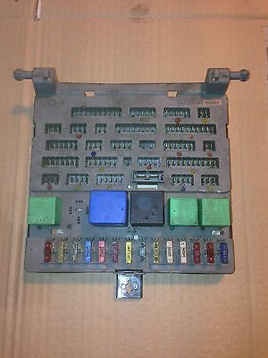

theknudsen 0 1 Cars Posted April 30, 2019 Do anyone have a Peugeot 205 fusebox diagram that fits to the picture ? Thanks a lot Share this post Link to post Share on other sites
SRDT 255 Posted April 30, 2019 Here: https://issuu.com/lamicale309/docs/schemas_electriques_309 Do you have a problem with your fuse box? 1 Share this post Link to post Share on other sites

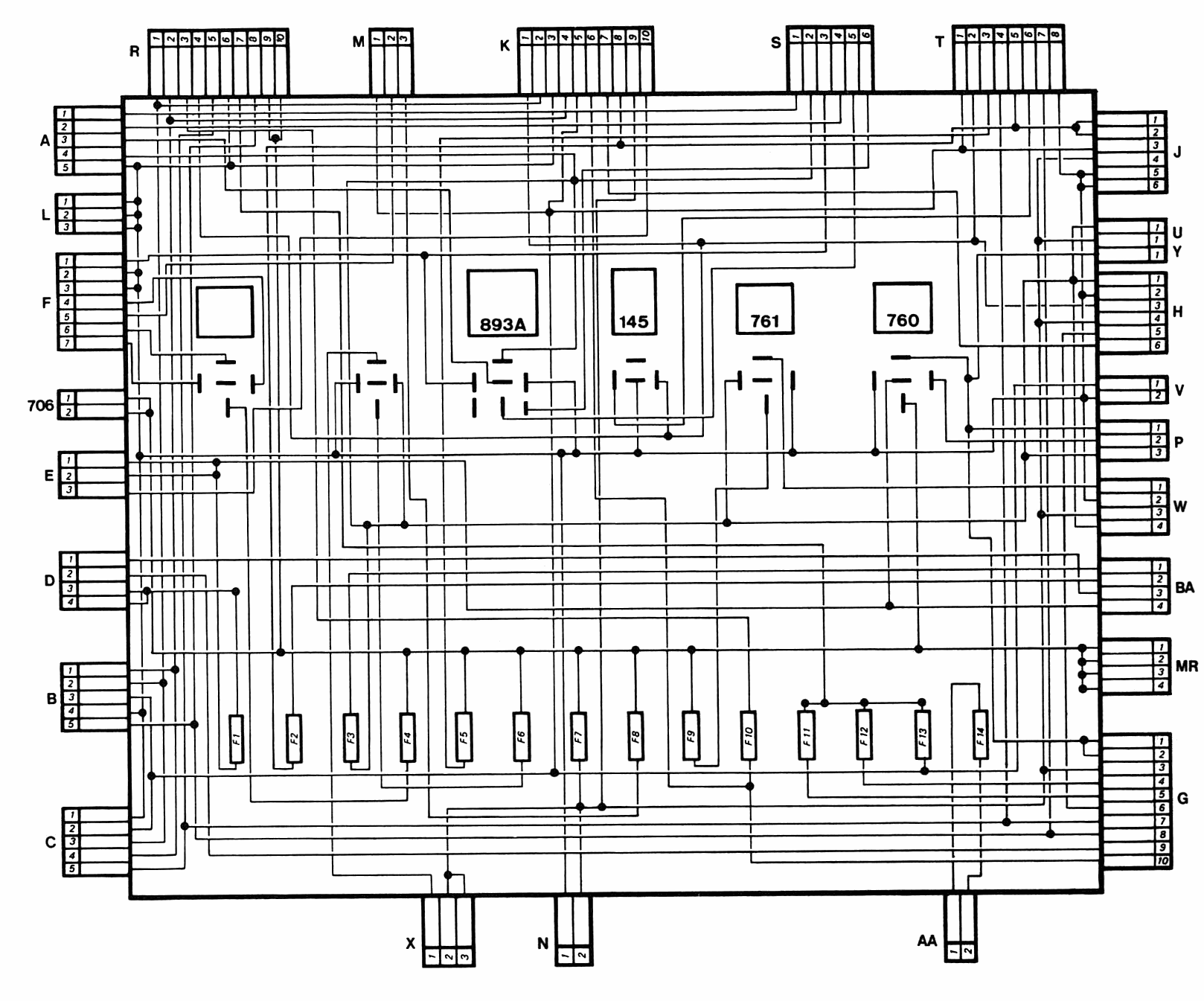

Ryan 99 Posted May 1, 2019 There's also this one which has the connectors round the edge, but has the individual pin numbers marked. Share this post Link to post Share on other sites
SRDT 255 Posted May 1, 2019 Strangely this one isn't exactly the same, look at the circuit for F8 and you can see it doesn't feed the rear defroster "760" relay. Any fuse box with a falty horn, rear defroster and cigarette lighter isn't wired this way. Thinking about it your diagram could be a early one, then Peugeot protected the relay with F8 introducing a weakness in the design. One thing that is right on your diagram and omitted on mine is the central connector on the rear defroster relay. Share this post Link to post Share on other sites
theknudsen 0 1 Cars Posted May 13, 2019 Can anyone tell m what connector "D" in the fusebox is connector to? and what is the different realys for - 893A, 145, 761, 760 etc. ? Thanks Share this post Link to post Share on other sites
Ryan 99 Posted May 14, 2019 Connector D is (I think) connected to the starter motor and the switch on the gearbox for the reverse light. The six relays, from left to right: 1 (750) = Front spot lamps 2 = not used on GTI 3 (893A) = Wipers 4 (145) = Flasher unit for indicators / hazard lights 5 (761) = Electric windows 6 (760) = Heated rear window 1 Share this post Link to post Share on other sites

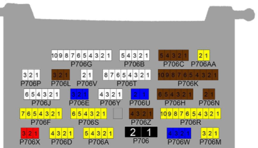

joris_andriesse 8 Posted June 8, 2022 Is there perhaps also some diagram or something which tells which connector goes to what? So, G is connected to ...., B is connected to ... C is connected to ... etc. Share this post Link to post Share on other sites
SRDT 255 Posted June 8, 2022 In French, as usual: http://www.dethomaso.fr/2019/02/schemas-electriques-205.html Share this post Link to post Share on other sites
joris_andriesse 8 Posted June 9, 2022 Thanks @SRDT, but how do I now translate those number to where these wires go to? Share this post Link to post Share on other sites
SRDT 255 Posted June 9, 2022 Choose a year: 1986, 1989 or 1991 and go near the bottom of the list: 2 1 Share this post Link to post Share on other sites
MrAndy 10 Posted November 15, 2022 Old thread, but I feel that I'm not alone when thinking, how will I know which connector does what? In the middle of putting the whole car ready for rotisserie... all parts will be removed. So, for example, if I want to know what the connector P706W is doing, there is no clear list with explanations available? I will select a random item, "power windows" from the "Dethomaso" pages, find the wiring diaghram of the power windows and see that the connector P706W is mentioned on that page, so that must be it then.. Is that the only way to proceed with all the connectors or do I have any better way? Thanks in advance -A- Share this post Link to post Share on other sites
SRDT 255 Posted November 15, 2022 P706W became H706W on later years. P is for planche de bord (dashboard) and H is for habitacle (cabin). Looking at H706W on the diagram above it's used for central locking and power windows with more info about variants on page 49/3. Share this post Link to post Share on other sites
MrAndy 10 Posted November 17, 2022 On 11/15/2022 at 11:08 PM, SRDT said: P706W became H706W on later years. P is for planche de bord (dashboard) and H is for habitacle (cabin). Looking at H706W on the diagram above it's used for central locking and power windows with more info about variants on page 49/3. Thanks Share this post Link to post Share on other sites
MrAndy 10 Posted November 17, 2022 Hi again, This was basically what I was looking for. Now I should have some chances to find the same connectors in the car and in the drawings. Hope it helps others also -A- Share this post Link to post Share on other sites
