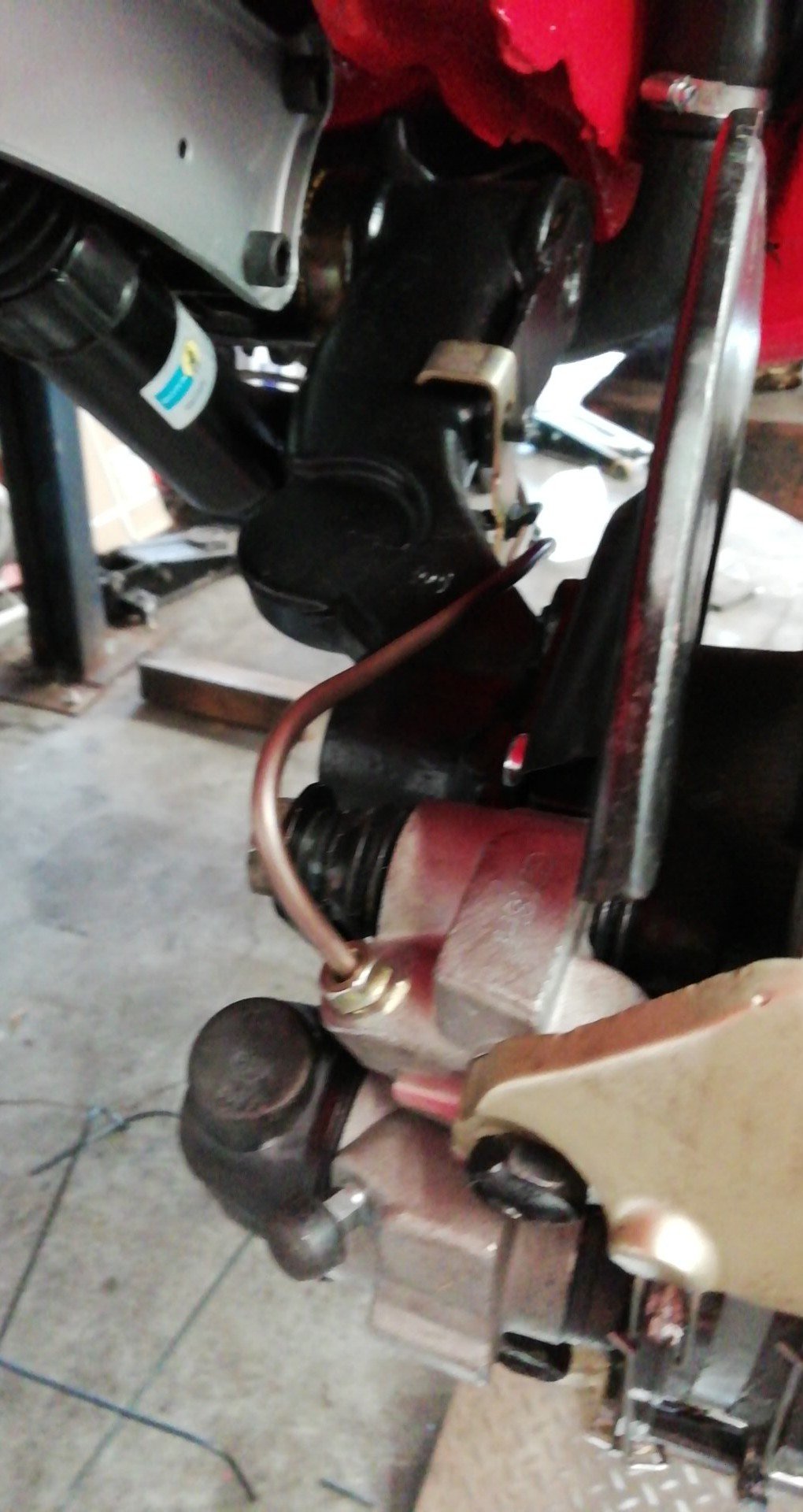

Hi all
Just after some assurance that the rigid line I've put into my caliper looks right. Haven't done this before and as I've said in my main thread I was wondering about the left right movement of the caliper over time with a fixed pipe.
Any thoughts?

I do find it slightly odd that the caliper has this movement but Peugeot deemed it ok. To be fair I moved the caliper on the sliders and with full range the overall effect on the hyd pipe does appear to be minimal.
jackherer
I agree but if you think about it they have a lot to lose so they must have been pretty convinced it was OK, if you do it and it fails you'll get a soft pedal and investigate whereas if 306s failed en masse they'd have lost millions doing a recall.
Miles
The pipe goes on the other side of the bracket too, 106 and 206 use the same method as the caliper hardly moves really and do all mine like this, the amount of time people fit the flexi on wrong as they forget it rubs on the inner arch
