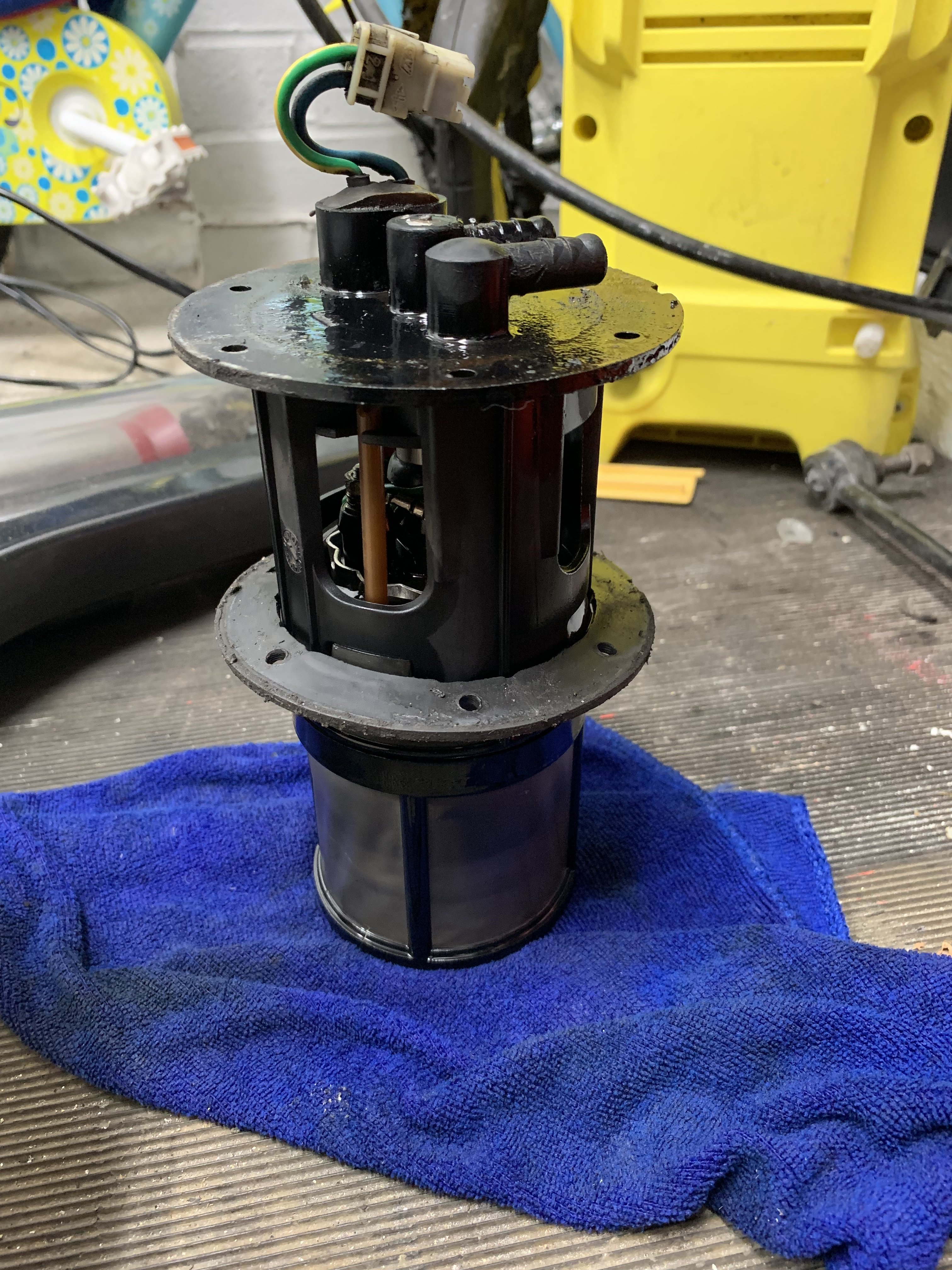

Thats my pump removed. No part numbers anywhere not a clue of the make.
Found this bosch unit looks like it will do the job?
https://m.onlinecarparts.co.uk/bosch-1156309.html
Miles
Wrong one as thats a phase 2, both Bosch pumps, get the fitting kit from Bridgecraft and pump from Glengoe and a nice modern pump with a good flow rate
