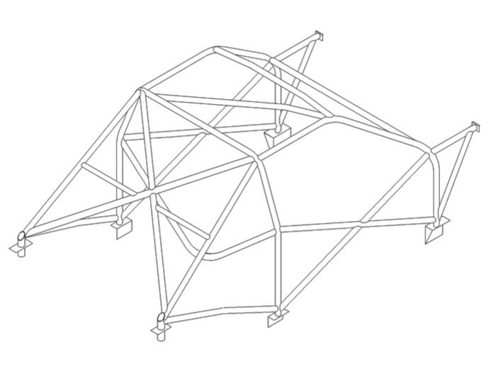

jamie_1992 66 1 Cars Posted November 18, 2018 (edited) I’m looking for some advice on rollcages for my 205, I currently have a bolt in safety devices c44 cage in the car but wanting to upgrade. My options are: a) modify my current cage to include braces to the front struts and extra bracing b) remove current cage and fit a full blown weld in cage from custom cages I believe the custom cages weights around 33kg and not sure what the c44 weights but I’d imagine the weld in weights more as there is more to it, what I’m wondering is will the added weight of a weld in cage be worth it for the added strength it would give to the shell Edit: just found that the c43 the full bolt in cage weights 60kg according to the safety devices website so I’m not sure how the custom cages can be nearly half the weight, think il have to research this a little more Current cage http://www.safetydevices.com/motorsport/products/roll-cage/Peugeot+205+-1983-1998-3-door-without-sunroof/82/925/ Custom cages https://www.customcages.co.uk/roll-cages/peugeot-205 Edited November 18, 2018 by jamie_1992 Share this post Link to post Share on other sites
Biggles 65 Posted November 18, 2018 2 hours ago, jamie_1992 said: Edit: just found that the c43 the full bolt in cage weights 60kg according to the safety devices website so I’m not sure how the custom cages can be nearly half the weight, think il have to research this a little more Custom cages https://www.customcages.co.uk/roll-cages/peugeot-205 If you read the link you posted you'll find out - the CC cage is certificated rather than to Blue Book dimensions. Share this post Link to post Share on other sites

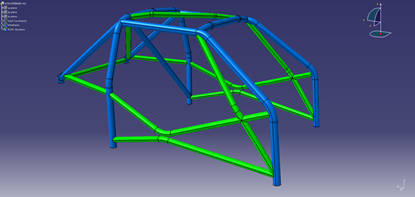

Kane 34 Posted November 19, 2018 (edited) Yep, yield strength of T45 is almost double that on CDS tube (~680 MPa vs ~380MPa) so you can get away with a significantly smaller/thinner cage while maintaining an equivalent strength. I wouldn’t bother with T45 if competing is something you may or may not end up doing further down the line. The reason being is that if you build a cage using T45 of a lesser diameter/wall thickness than listed in the blue book you require a test certificate from an approved body (Mira is the only company in the UK that can provide). This will not only cost you more than the cage itself but you have to provide the 3D model for them to analyse which unless you can do yourself is more expense. Stick with the cheaper material using the minimum dimensions noted in the blue book to simplify things. Edit: beat me to it WP Edited November 19, 2018 by Kane Share this post Link to post Share on other sites

Biggles 65 Posted November 20, 2018 (edited) 19 hours ago, Kane said: I wouldn’t bother with T45 if competing is something you may or may not end up doing further down the line. The reason being is that if you build a cage using T45 of a lesser diameter/wall thickness than listed in the blue book you require a test certificate from an approved body (Mira is the only company in the UK that can provide). This will not only cost you more than the cage itself but you have to provide the 3D model for them to analyse which unless you can do yourself is more expense. Except Custom Cages are advertising the cage as certificated so they have already had the analysis done. All you would have to do is satisfy CC you've fitted it correctly in order to get the certificate. Mira do indeed know how to charge - IIRC the analysis for the cage in my friend's car cost a 4 figure sum ... Edited November 20, 2018 by Biggles Share this post Link to post Share on other sites
Kane 34 Posted November 20, 2018 Sorry I hadn’t realised he was looking at a certified cage as he said he was intending on making it up himself. You’re not wrong! Plenty Hillclimb/sprint cars been done over in recent seasons due to lack of rule enforcement/blue book ambiguities, a lot of which have run into the thousands to rectify. Share this post Link to post Share on other sites

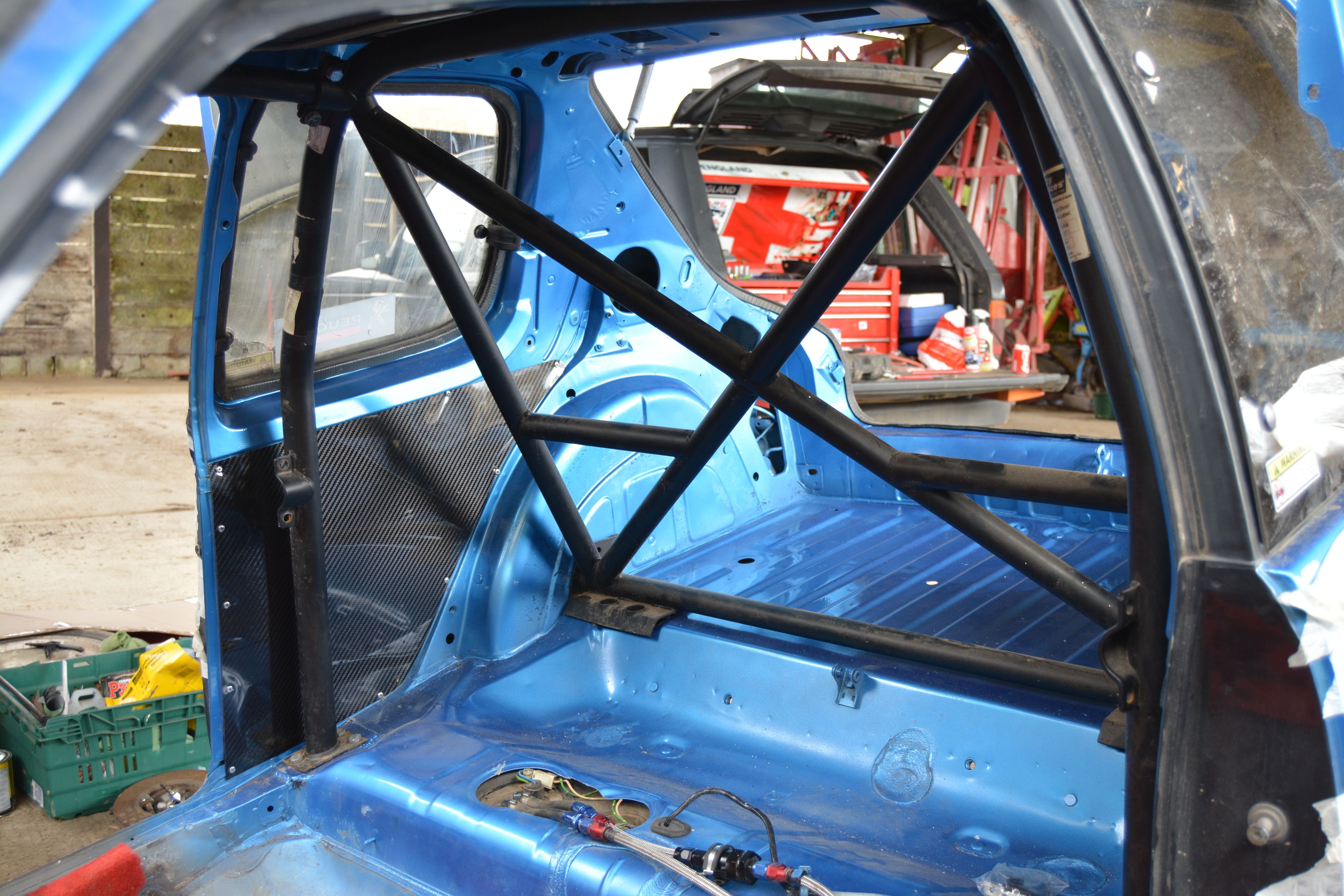

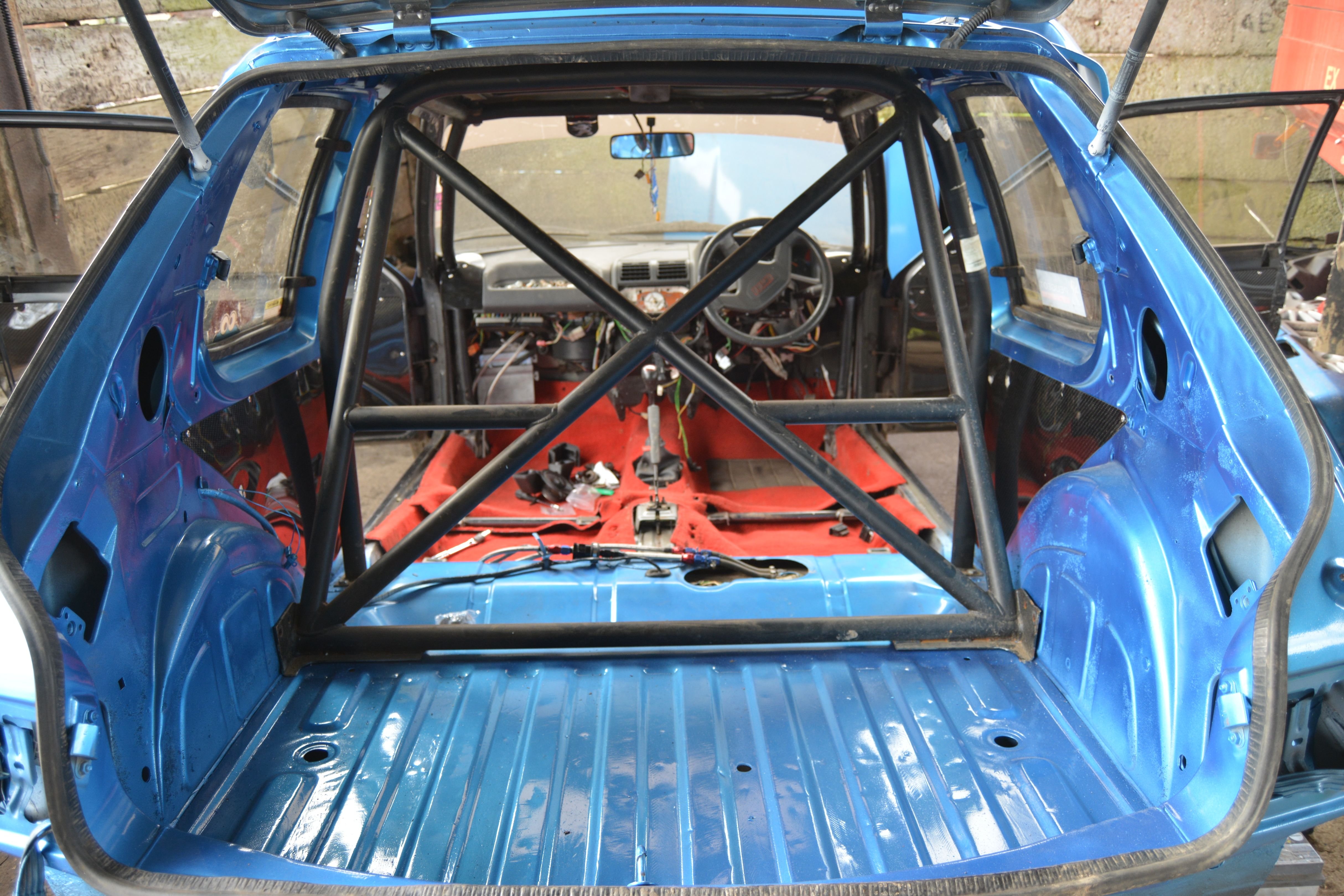

camgti 56 Posted February 12, 2019 (edited) Just to throw in my 2 cents here. I have recently completed a a full blown race build. If something is worth doing, do it once. Go and take the car to someone who can give you advice if they are doing the work. Have a look at the requirements for ANY future events you may like to do. Build the cage around that. We wanted safety to be first and stiffness second so have a heavier cage. Car is also seam welded. It has cross sections ontop and on the back stays and doors. It has 2 A pillar bars and triangulates to the front turrets. Have it made for quality and safety and you cant really go wrong. A few more bars could save your life. Lets face it, we are not racing for sheep stations at the end of the day so a little extra weight will soon be forgotton. Edited February 12, 2019 by camgti Share this post Link to post Share on other sites
