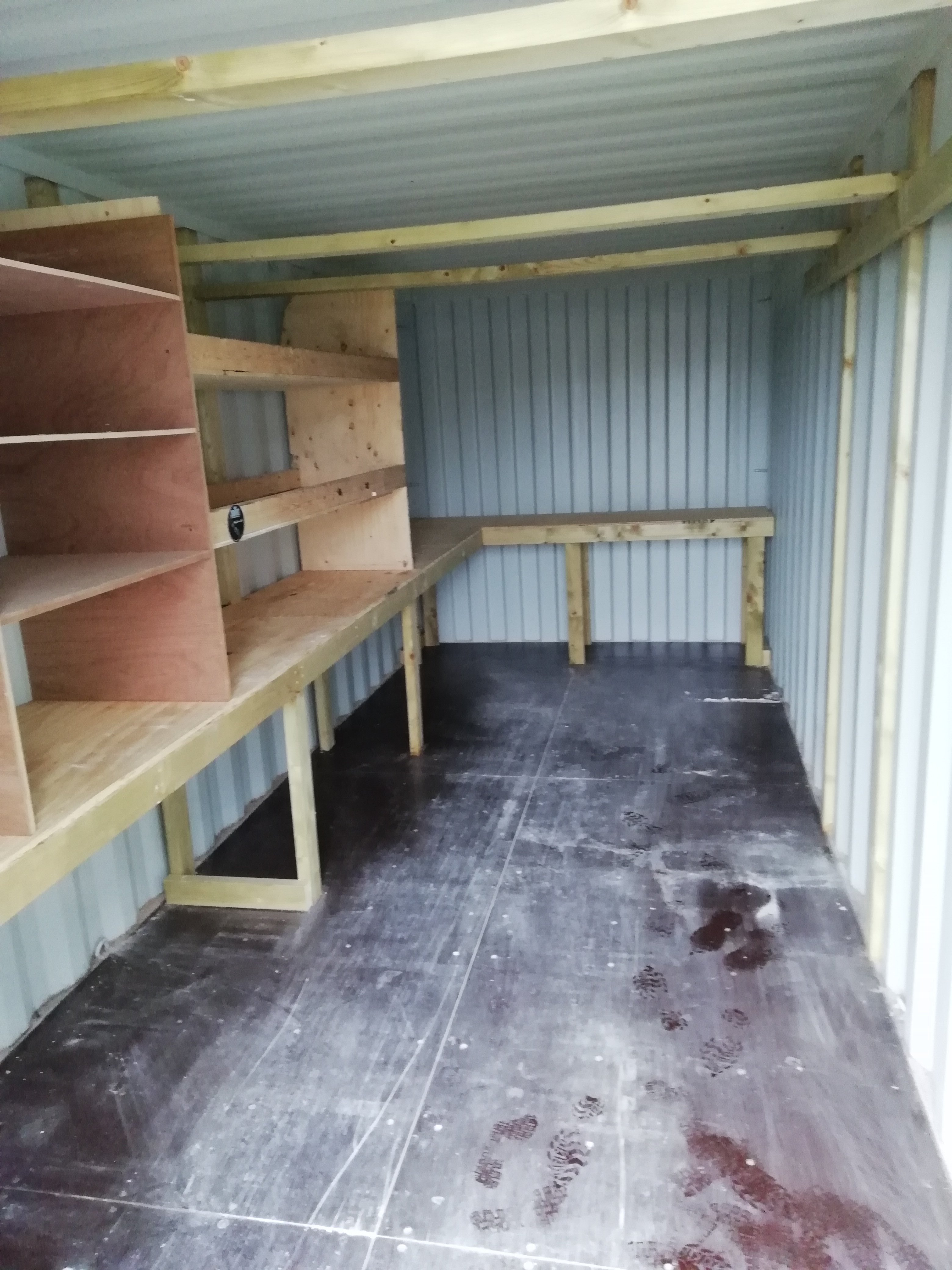

Telf 236 2 Cars Posted October 19, 2018 (edited) As per the title- does anybody have any experience of storing their car in a shipping container? I've read various articles online- it seems that the success to a large extent depends on the type of container used and the location. Condensation appears to be an issue in old steel and aluminium containers but not so much in Corten steel containers ( no idea why?!?) The reason I'm asking is because I've got the opportunity to hire a 30 foot container which I am thinking of using to house my engine rebuild in, store all my 205 junk but also store the GTI over winter. The container is brand new on a complex at a local farm. Its in a row. Its raised off the floor and the interior has been coated with a anti condensation layer. The floor has been laid with wood. I've inspected it and it appears dry but I'm concerned as to what might happen if a car is in there over winter. As its 5 minutes from the house I'd go over on the way from work and open it for venting every week . Any advice or experiences would be great. Edited October 19, 2018 by jackherer Share this post Link to post Share on other sites

Telf 236 2 Cars Posted October 19, 2018 Hi Mei. I don't have any space that's why thinking of renting. I dont have a garage so it seems a reasonable idea to keep the car out the elements during winter. A plus is the farm and compound has cameras everywhere so it's quite secure and locked up after 7 pm. As usual Google has made me unsure what to do with stories of the container turning into a condensation/water trap ruining stuff inside Share this post Link to post Share on other sites
