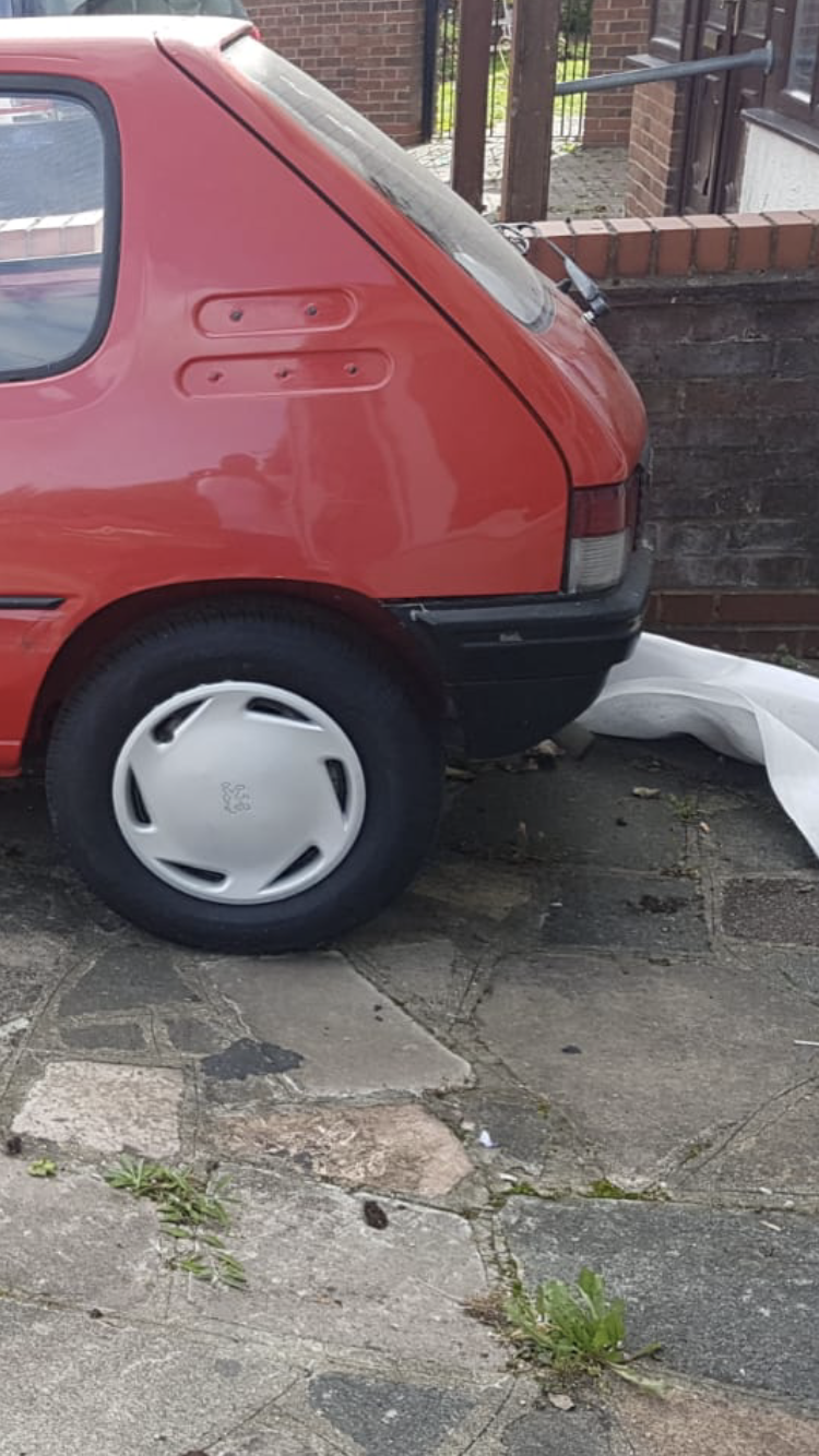

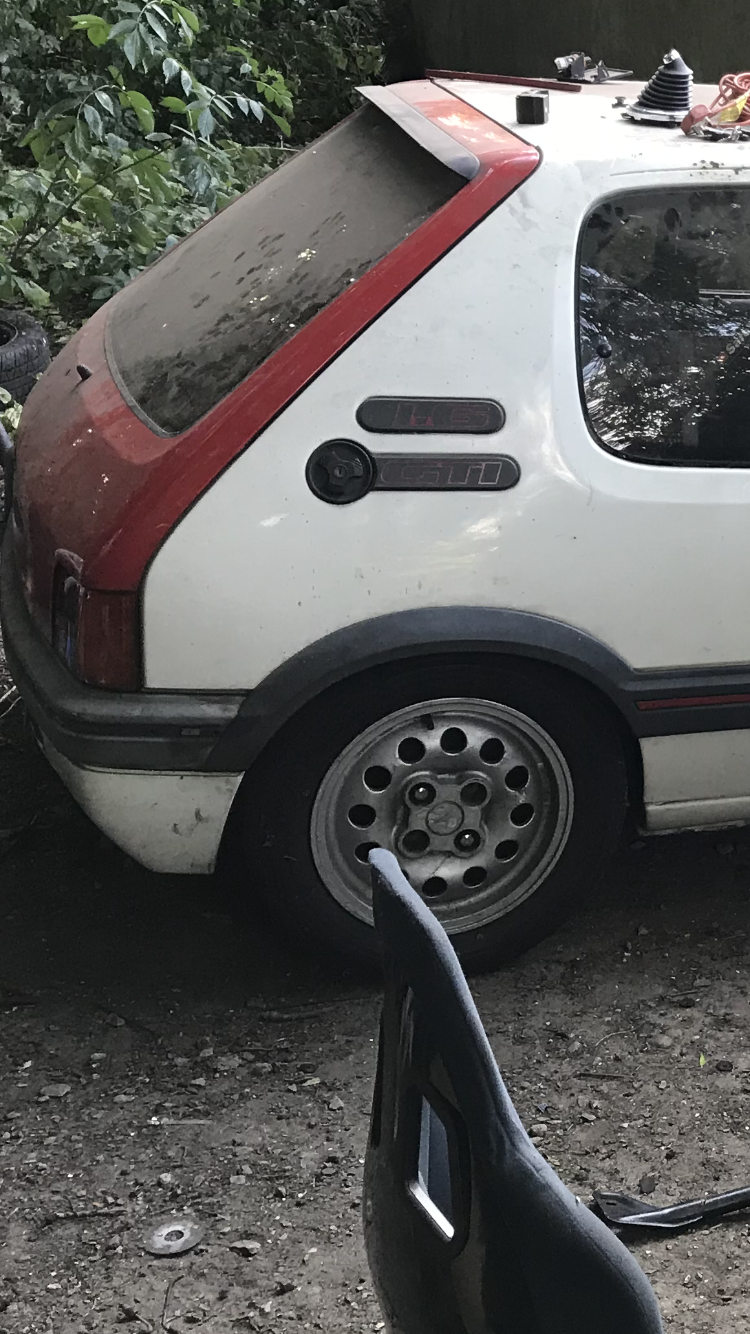

K20205 5 Posted September 27, 2018 (edited) Ive recently bought a 1.1 base model hatch, i have a 1.6gti as a donor and want to switch everything onto the base model but the arches seem smaller when i test fitted the quarter panel trim from the gti. how far deep do i need to cut to get the gti trims to fit onto it? has anyone got pictures of theirs if theyve done it. cheers Edited September 27, 2018 by K20205 . Share this post Link to post Share on other sites
boldy205 75 Posted September 28, 2018 Once you get the gti trims off, you will see. It's quite a large 'egg' shape arch. Not sure but I think you will be into some serious body modifications to get it all done properly. Can you use some rallye arches instead? Share this post Link to post Share on other sites
Tom Fenton 1,569 Posted September 28, 2018 Remove plastic arch from GTI make a template of the shape. Transfer to base model cut the 1/4 panel. You will also need to cut the inner wheel well and then weld a piece in to bridge the gap. Not difficult to do but take your time to do it neatly. Share this post Link to post Share on other sites

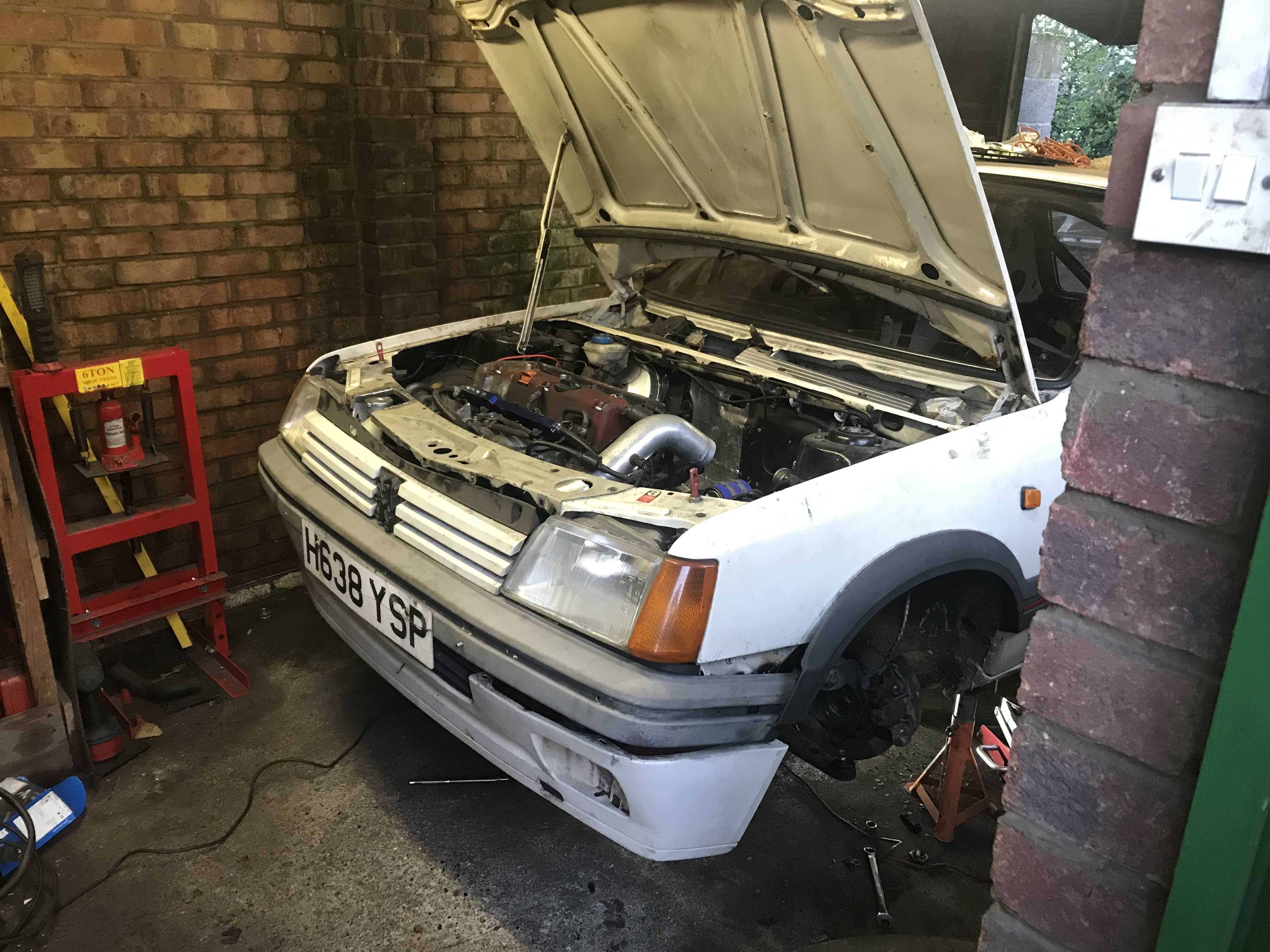

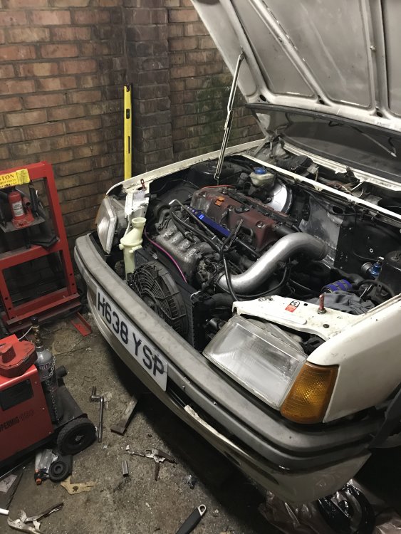

K20205 5 Posted September 28, 2018 4 hours ago, boldy205 said: Once you get the gti trims off, you will see. It's quite a large 'egg' shape arch. Not sure but I think you will be into some serious body modifications to get it all done properly. Can you use some rallye arches instead? I want to put 16inch alloys and its going to rub or maybe not even fit, i need to cut to make space for the larger wheels. its going to be k20’d from a civic. Share this post Link to post Share on other sites
K20205 5 Posted September 28, 2018 2 hours ago, Tom Fenton said: Remove plastic arch from GTI make a template of the shape. Transfer to base model cut the 1/4 panel. You will also need to cut the inner wheel well and then weld a piece in to bridge the gap. Not difficult to do but take your time to do it neatly. That is exactly what i was thinking to do mate. Makes sense as ive got a shell to compare with. thanks Share this post Link to post Share on other sites

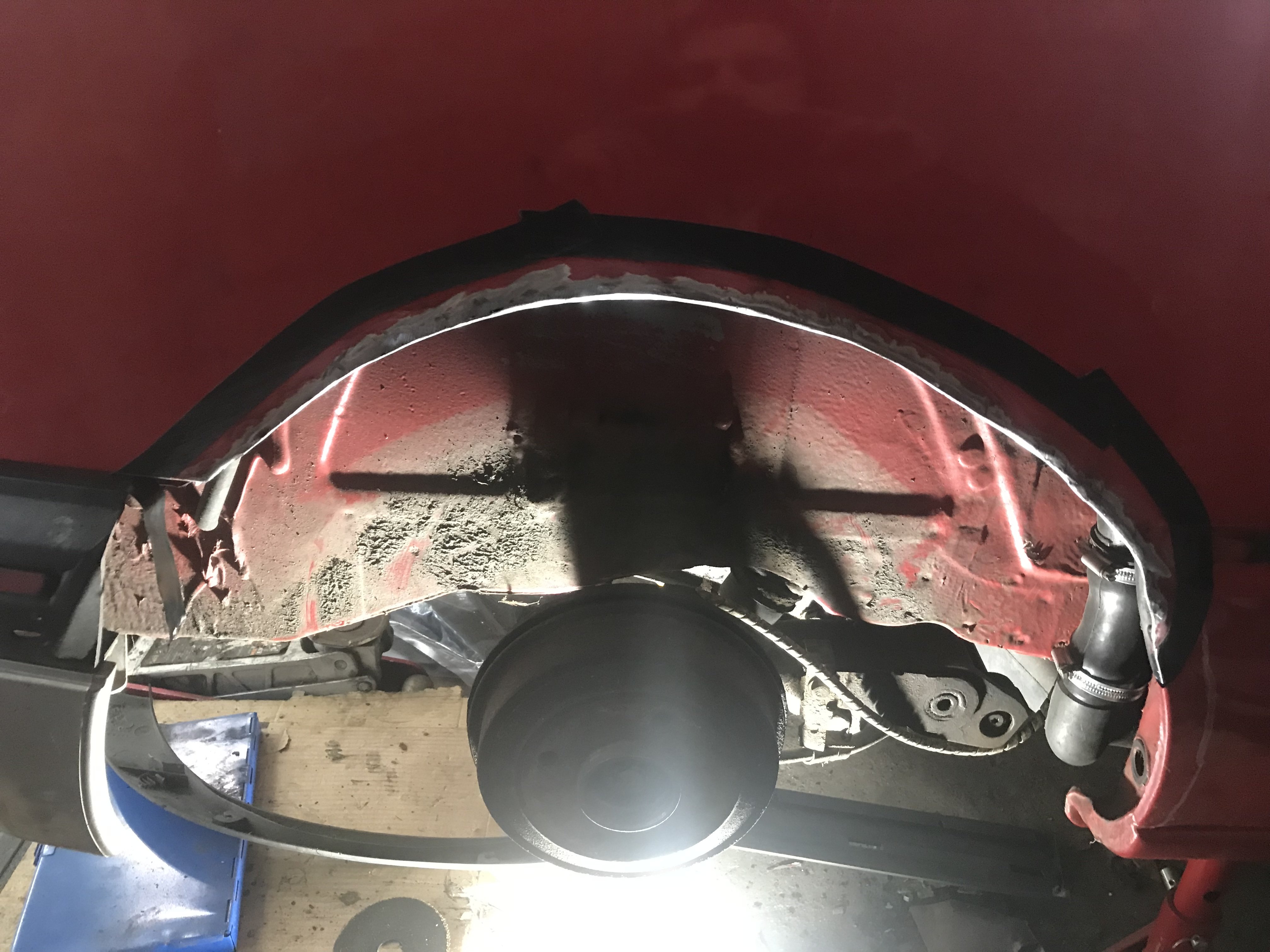

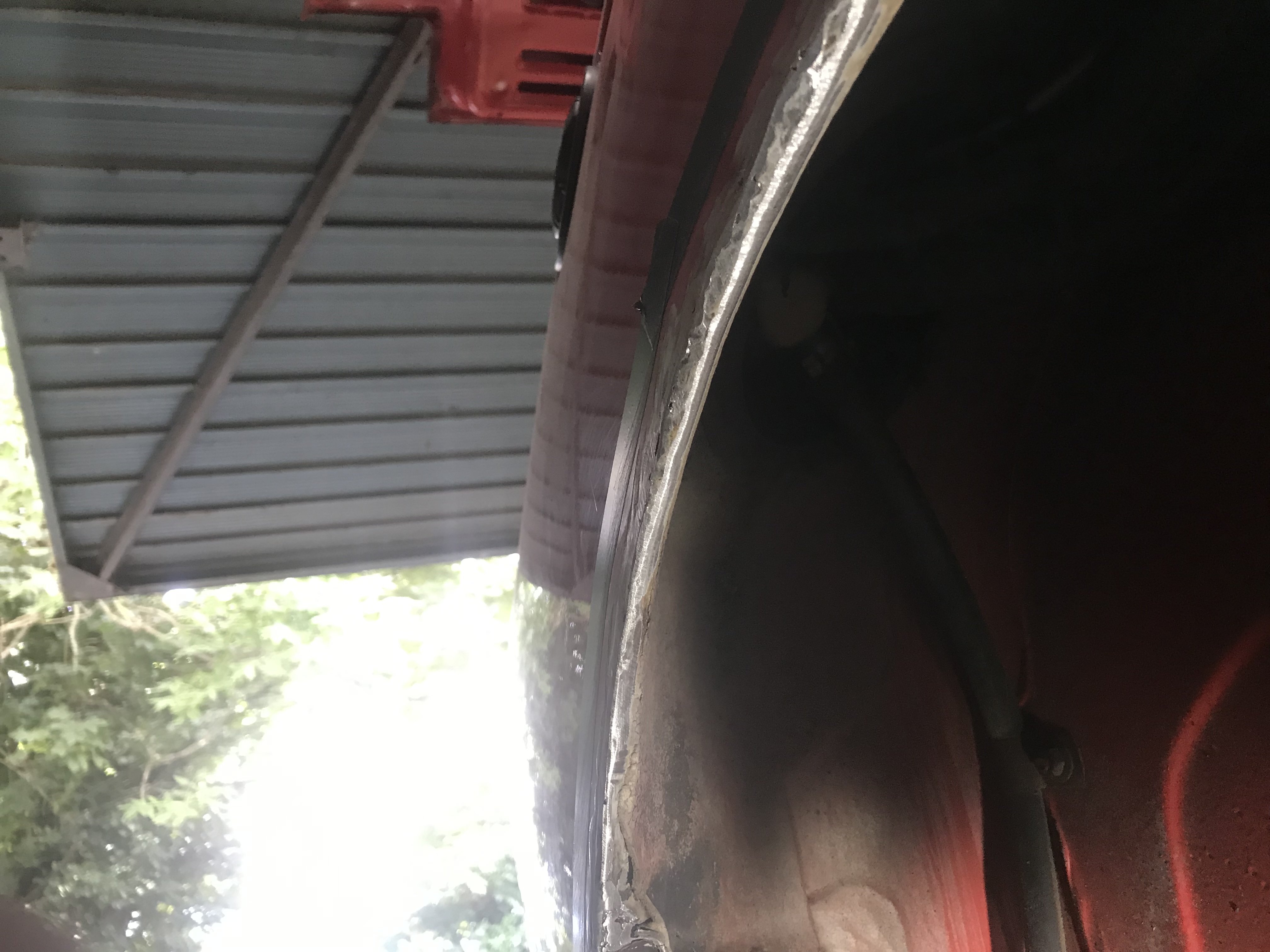

Vasco Morais 0 Posted March 7 i have the same issue, and saw your work there. i was wondering if i can simply cut the part of the wheel arch from the 1.6gti and fit it in the non gti car? Share this post Link to post Share on other sites
welshpug 1,682 Posted March 7 Thats a lot more work, much quicker to make a template like Tom Fenton said and just cut away to match, and make a small infill piece as required Share this post Link to post Share on other sites
Vasco Morais 0 Posted March 7 how did he make the inner "lip" did he cut it in slices? or since it's such a small lip he just hammered it ? Share this post Link to post Share on other sites
