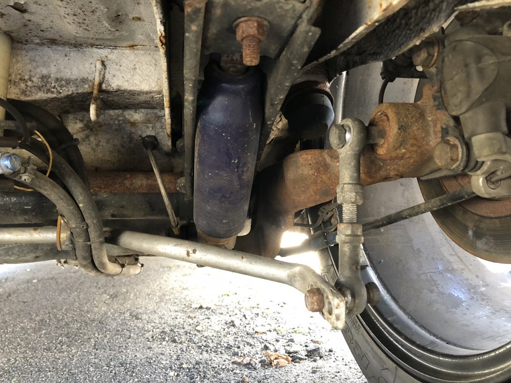

SweetBadger 99 Posted September 19, 2018 Have run one previously on a standard 1.6 beam and it made a noticeable difference. No complaints from me. I run one on the race car in addition to a 24mm arb - provides some adjust-ability. The only thing that is a bit crap is the way it attaches to the trailing arms: the brackets are a faf to get on, and although effective it looks like a bit of a bodge. I've drilled and tapped the back of the stub axles for an M10 bolt, and run rose jointed links from the bar which are bolted directly into the back of the stub axle. Share this post Link to post Share on other sites

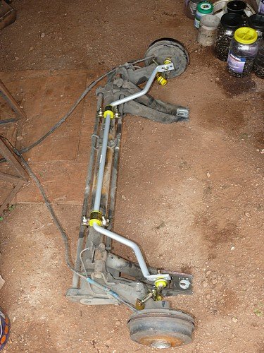

SweetBadger 99 Posted September 19, 2018 They used to make one for the 205 - bolts on to the cross tube with U bolts then around each trailing arm: Share this post Link to post Share on other sites

SweetBadger 99 Posted October 21, 2018 Was up at the garage today so grabbed a quick pic: 1 Share this post Link to post Share on other sites
jackherer 543 Posted October 21, 2018 Thanks, it looks like they are at a better angle there as well as being more solidly attached. Share this post Link to post Share on other sites
