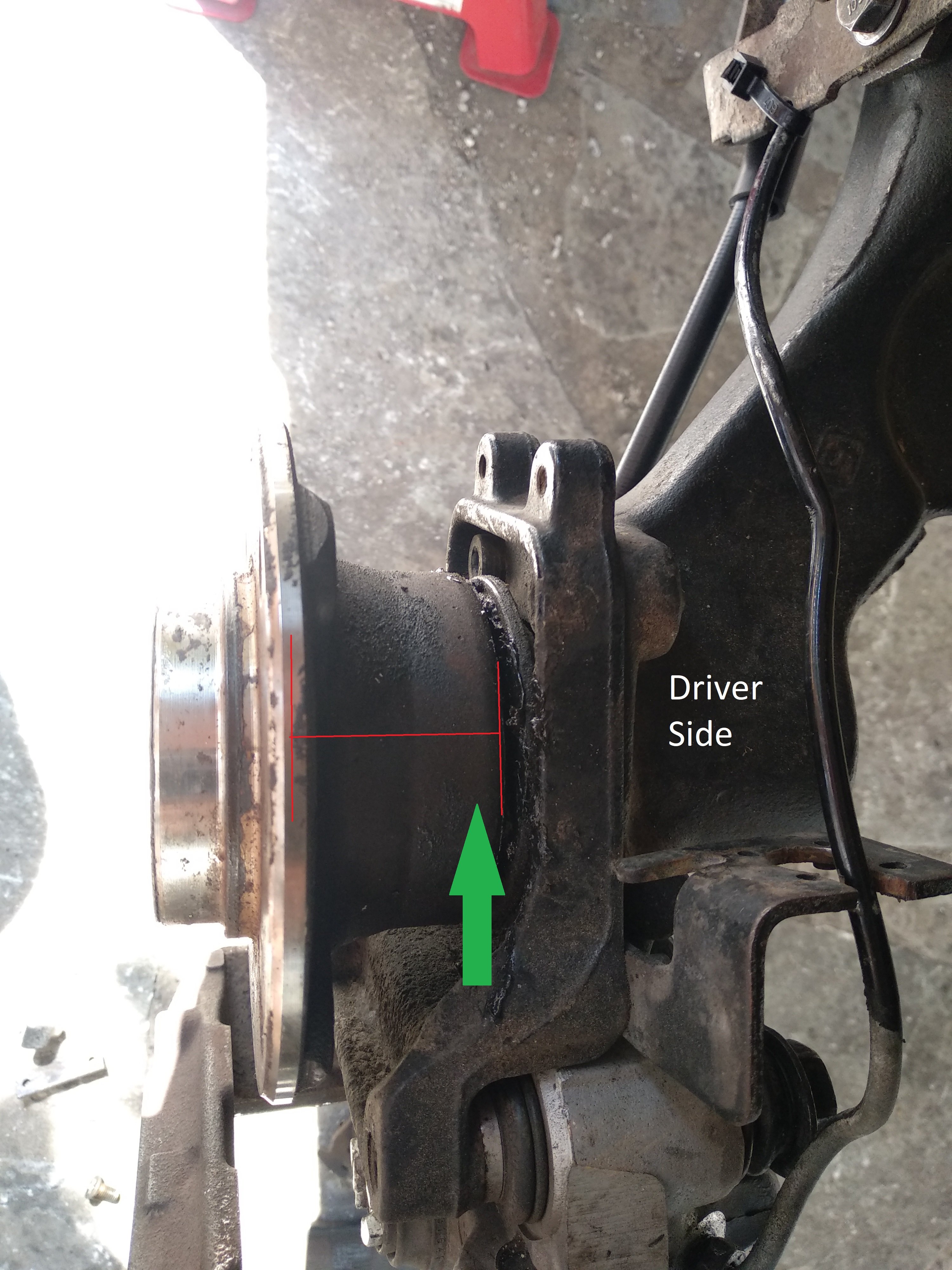

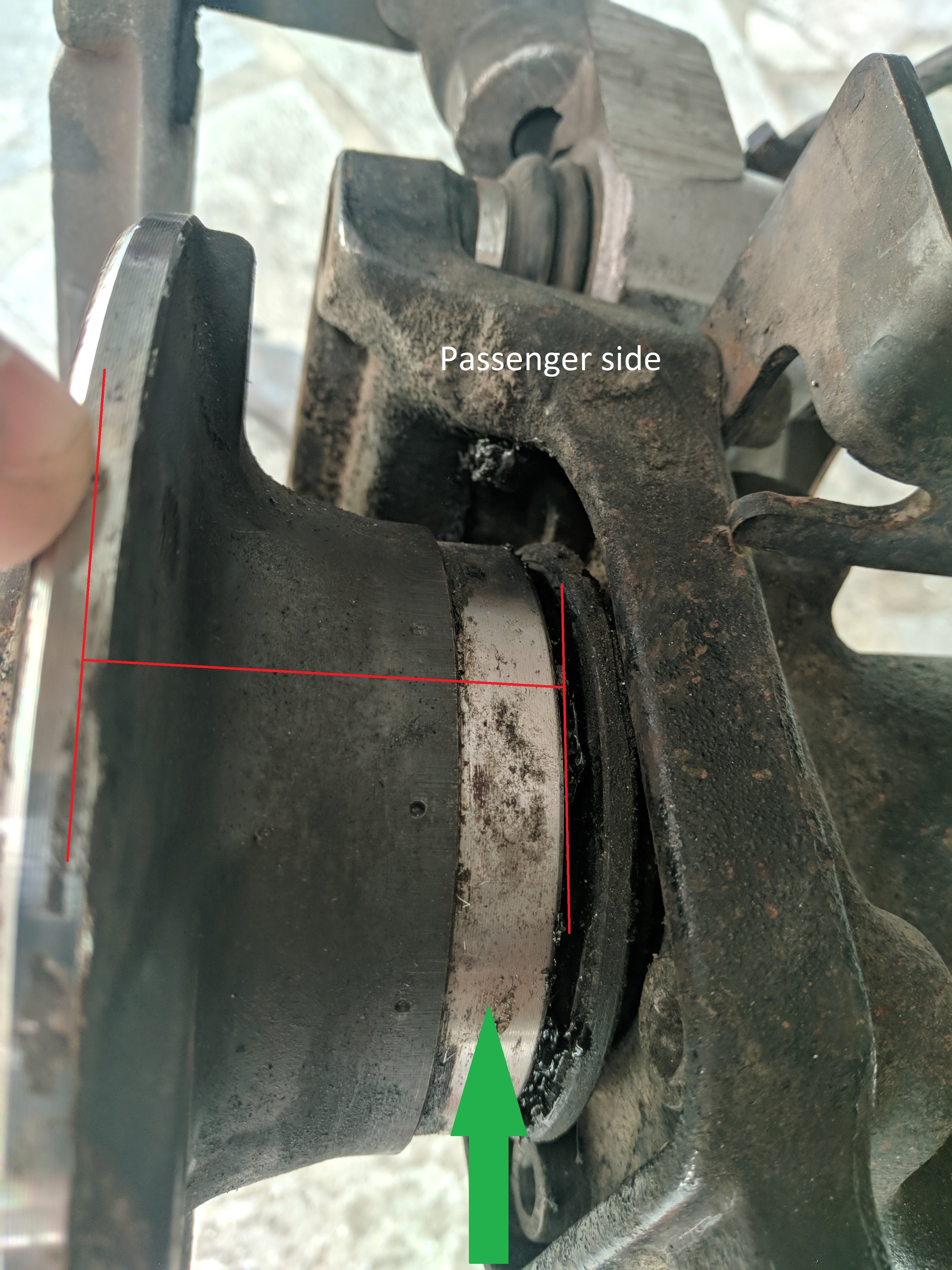

In the pictures below :
1) The red distances are equal.
2) The green arrow shows a different piece of the passenger hub. I think that this metal is not a wheel bearing because it has 68mm diameter.
Rear wheel bearings have 52mm outer diameter. I am right?
Any ideas what exactly is hapening?

I think that is an ABS hub from a 306 or something with the ABS teeth taken off from the area you arrowed in green.
kostas205
Ok, so the wrong one is the passenger side hub?
jackherer
I think so, yes.
How did the brake discs and pads line up in the caliper? Did the caliper have to be pulled out on the sliders to get them to fit?
I’d bet that someone has repaired the trailing arm that side in the past by just substituting an arm off a 306. They look very similar at visual inspection but when you measure the sub axle is longer, and there’s a spacer if 9mm if I remember right that sits behind the bearing.
I’d also measure the brake discs as it could be they are different side to side offset wise.

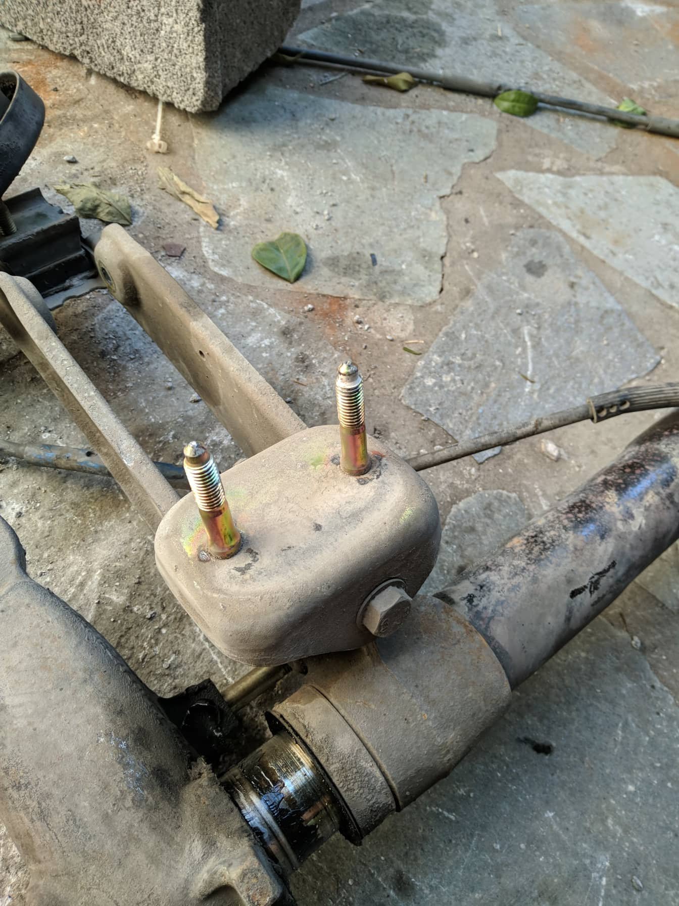

The brackets you talking about are these in the photo right?
11 hours ago, Ozymandis said:
The pressed steel mounting brackets at the frontof the axle are handed , Left and right , it`s possible to get that bit wrong and offset it all one way or another, if you swapped an axle you may have mis-matched them?
They are marked by peugeot G for gauche and D for droit
Only 1.9 GTI. All the rest (base, 1.6 gti, 309) are not offset and not stamped.

On the picture is my previous axle ( base model with drums), where exactly is it stamped?
Ozymandis
In the OP he`s fitted a 1.9 axle.
Kostas ,as Tom says the lesser model brackets arent stamped its just the 1.9 model brackets.
You cant see the stamping with it fitted to the car.
Blimey your old axles so clean and un-rusty, they all look like rusty scrap in Britain
