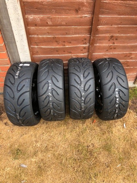

woodymi16 24 2 Cars Posted July 26, 2018 (edited) I got my A050's from Ebay https://www.ebay.co.uk/itm/4-x-195-50-15-YOKOHAMA-A050R-MEDIUM-Track-Sprint-Hillclimb-TRACK-USE-ONLY-Emark/122728854875?fits=Tyre+Width%3A195|Aspect+Ratio%3A50|Rim+Diameter%3A15&epid=2269726760&hash=item1c9335b55b:g:gKUAAOSwuDNZzM8D Edited July 26, 2018 by woodymi16 1 Share this post Link to post Share on other sites
