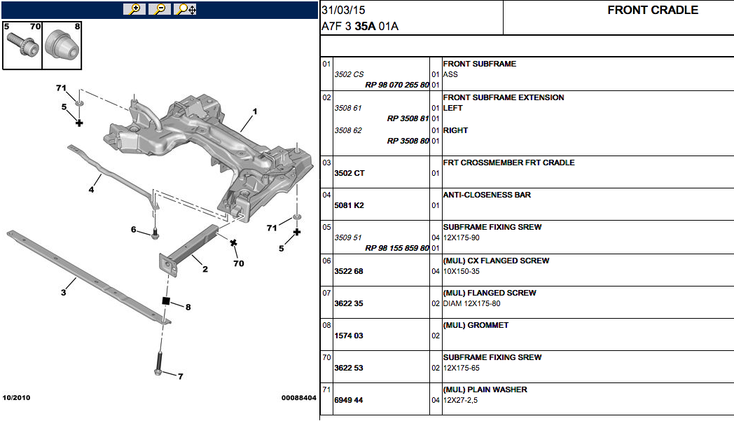

Never been near a 207, but can you drop the subframe down easily?
jackherer
I don't know but it doesn't look too bad on servicebox:
1954779080_ScreenShot2018-06-13at14_55_44.thumb.png.35853d94905caa3755c3a33f4a837409.png
It depends what the extensions to the front of the car are like in terms of access. I think the ARB would have to be unbolted too as it wraps around the driveshafts.
