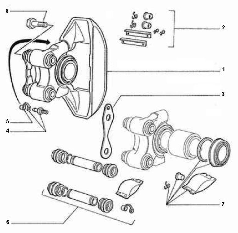

3 Washer-like stop plate on brake caliper
Here item 3, OE 442792. What is the function of this part? I'm not missing it I'm just curious.

picture 3 British mot failure if it’s missing (eBay or make yourself)

You'll find you will get both parts in the 2nd and 3rd picture cheaply from Peugoet
