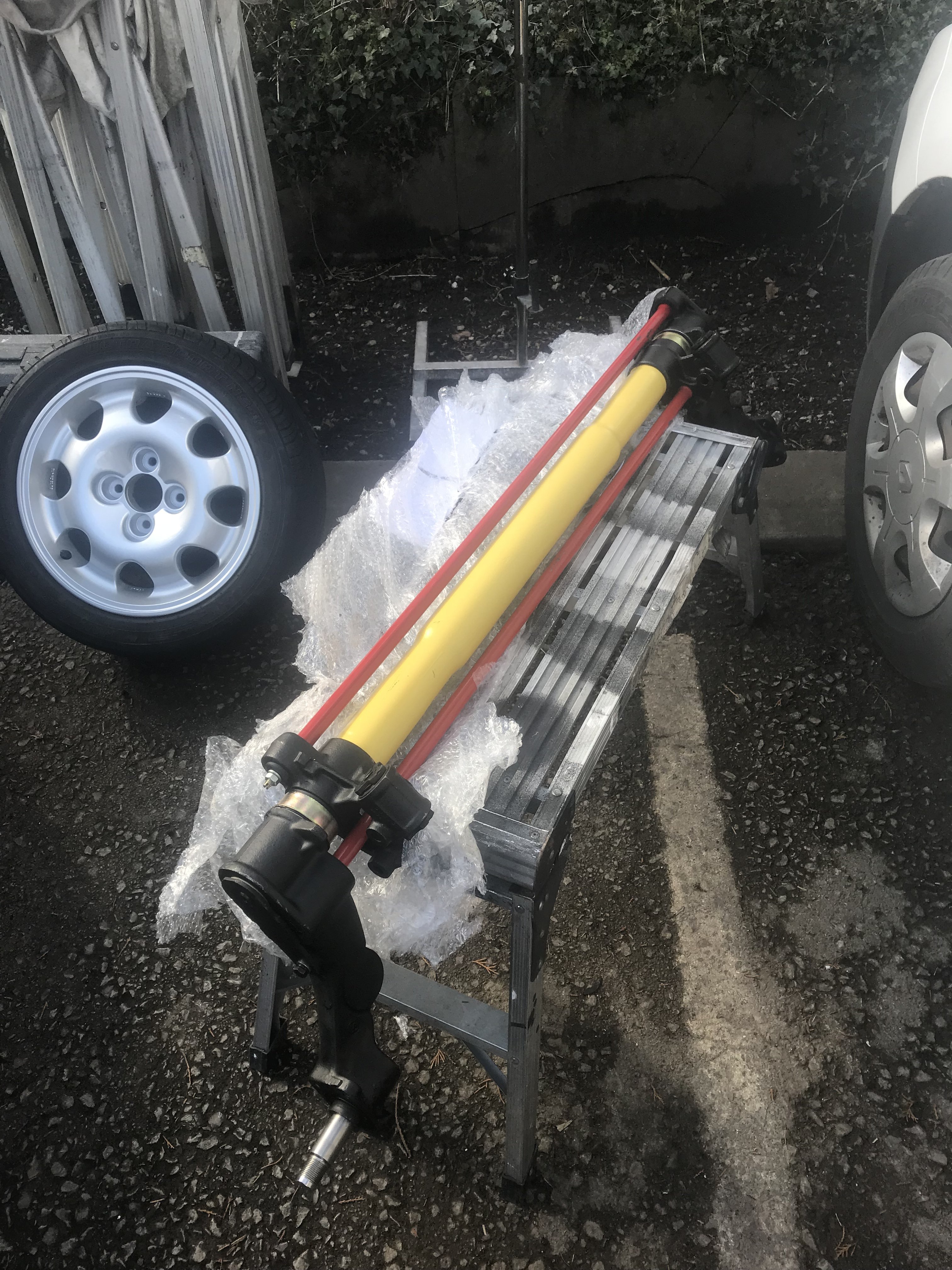

I think it’s different if you get a refurbished beam compared to a new beam. I went for a refurbished which they took mine in for swap against it. Tube, trailing arms and torsion bars definitely aren’t new but blasted and powder coated. Was still £400 but got £100 back against mine.

I spoke to them when I ordered mine. They do a New beam which is there own made with all new parts which is £400. Then they do a refurb original beam which again is £400 but you get £100 back when you send your beam in. Not sure about the drum version but guessing it’s the same
