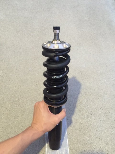

welshpug 1,681 Posted January 28, 2018 306 dampers are a bit short for a 405. wiring diagrams are all on here. Share this post Link to post Share on other sites
jackherer 543 Posted January 28, 2018 On 1/28/2018 at 11:56 AM, IRISH_MI16 said: The omex is future proofing for what I have in mind for this engine and car. I'll have to get it eventually and if one comes up at a reasonable price I see now reason not to get it and use it. Repeated mapping on a rolling road can get very expensive, it makes sense to get all the changes made to the engine first then fit the ECU and get it mapped rather than having it remapped at every stage. But I do agree it is a good idea to fit a modern ECU so you can lose the distributor cap and rotor arm along with the air flow meter apart from anything else. Share this post Link to post Share on other sites
IRISH_MI16 2 Posted January 28, 2018 On 1/28/2018 at 12:37 PM, welshpug said: 306 dampers are a bit short for a 405. wiring diagrams are all on here. I used 306 shocks with a 30mm spring on the gtx and looks perfect and handles like it's on rails. I figure 25mm drop on the coilover should be plenty as I'm aiming for 50mm I'll have dig around when I get to a laptop see if I can find them Share this post Link to post Share on other sites

my3AWDgst 5 1 Cars Posted January 30, 2018 On 1/28/2018 at 12:37 PM, welshpug said: 306 dampers are a bit short for a 405. wiring diagrams are all on here. Yes they are about 15mm shorter but they work great. I use 306 BC coilovers with BC top spring mount and universal camber plates. Share this post Link to post Share on other sites
