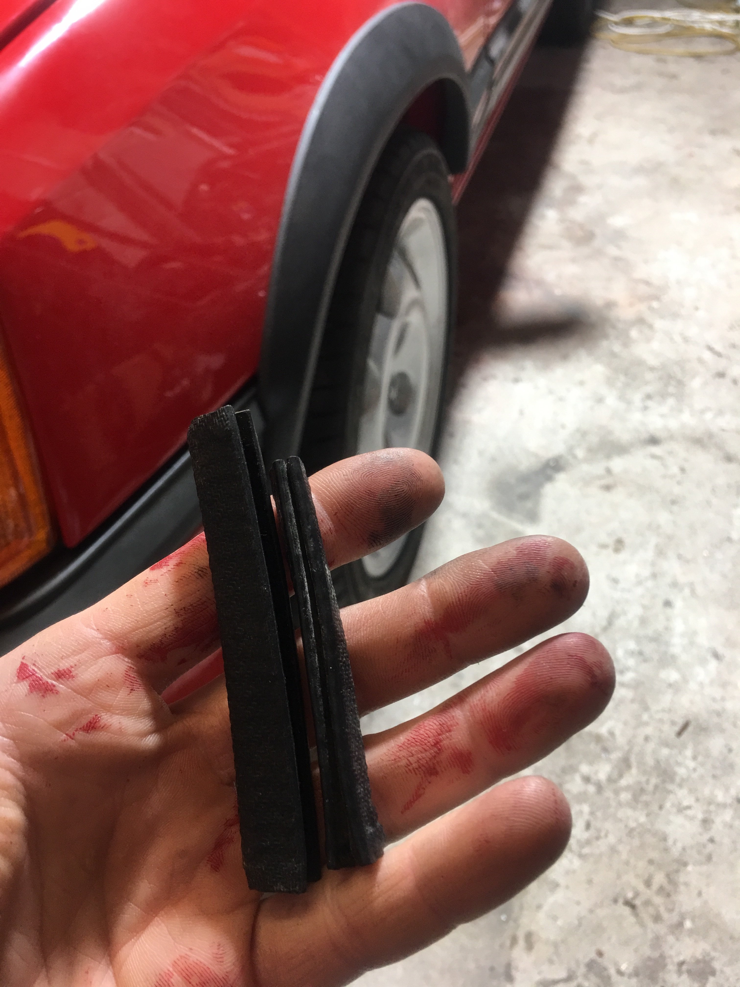

Beeluff 2 1 Cars Posted January 27, 2018 Hi all, this is my first post.... I’ve been lovingly restoring a 205 for the last 2 years, trying to keep it as original as I can..... I’ve got 2 bits of trim that I remember taking off, but looking down all my photos/videos/notes I just can’t find where they need to go!!.... does anyone recognise these?? And do they know where they go???? thanks in advance!!! Share this post Link to post Share on other sites
Tom Fenton 1,567 Posted January 28, 2018 I think they go on the lip near the fuel tank underneath, where the fuel and brake lines run from the floor pan up and over the tank, to prevent the pipes chaffing on the spot welded lip. Share this post Link to post Share on other sites
Beeluff 2 1 Cars Posted January 28, 2018 Got it!!!! Thanks Tom!!..... makes sense! I’ll get them on in the morning:) Share this post Link to post Share on other sites
