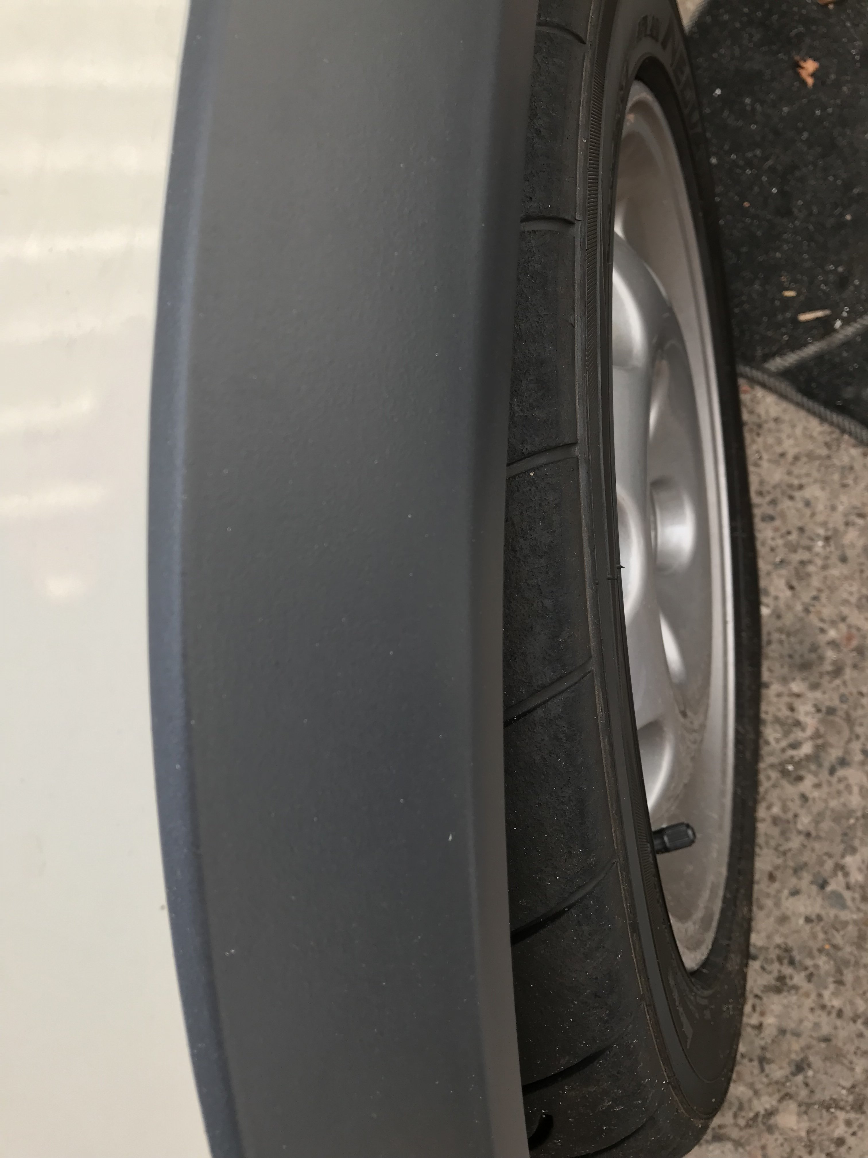

dobboy 231 2 Cars Posted April 28, 2018 I bought a can of the pig stuff and found it far too light. However I have seen an odd car with light trim in old pictures. But mine back in the day was never as light. ive mentioned on here before, but I got all my trip painted. It was plastic primered, texturised with a fancy paint, and finished with Ral7022 (iirc) with a matting agent added too, which was a match for my internal trims. i don’t think there is much paint on them at all but there isn’t a single peel or flake etc. Turned our good. Share this post Link to post Share on other sites
dobboy 231 2 Cars Posted April 29, 2018 Colour is RAL7021 1 Share this post Link to post Share on other sites
dobboy 231 2 Cars Posted April 29, 2018 Here’s a pic I took to show what the colour looks like. Share this post Link to post Share on other sites
