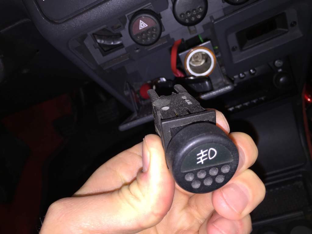

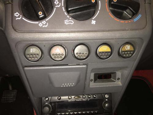

Bovien 6 Posted January 10, 2017 (edited) Gaz205, you have a point there (not that you others don't). I could just remove them. However, he forgot to put in the report and I'm not going there next time, so hopefully no issue. I would just like to get the lights working as supposed.I have two switches for fogs though. One for the rear and another for fronts (as the symbol has dipped fogs showing, as is the standard for front fogs). This is why I thought the other guys were on to something. I have attached a couple of pics of my console and the fog switch I'm going on about Edited January 10, 2017 by Bovien Share this post Link to post Share on other sites
Gaz205 50 Posted January 10, 2017 I've never ever seen any 205 with front fogs, only driving lights, I think the majority will suggest wiring them back to the main beam provided they are driving lights not aftermarket fog lights. That switch is more than likely from another model, it looks very out of place, good luck though Share this post Link to post Share on other sites
Bovien 6 Posted January 10, 2017 Interesting. But we can agree that the lower lights only come on as high beam and not boatman driving/dipped beam? 1 Share this post Link to post Share on other sites
Gaz205 50 Posted January 10, 2017 They flash when the lights aren't on when you flash other cars etc and stay on if you have your main beam on in conjunction with your headlights 1 Share this post Link to post Share on other sites
Ryan 99 Posted January 10, 2017 I've never ever seen any 205 with front fogs, only driving lights, I think the majority will suggest wiring them back to the main beam provided they are driving lights not aftermarket fog lights. That switch is more than likely from another model, it looks very out of place, good luck though I think front fogs were an option on some non-GTI models. That front fogs switch is listed on servicebox for the 205, so it was used somewhere. 1 Share this post Link to post Share on other sites
steve@cornwall 100 Posted January 10, 2017 I have that switch fitted on a diesel 205 because it had extra fog lights fitted in the grille. So you're may have had extra lights fitted at some point? Is the centre switch a blank or does it have a function?. My diesel has an a/c switch as the panel was only available with 3 or 5 holes apparently. Share this post Link to post Share on other sites
Bovien 6 Posted January 10, 2017 Good to know ???????? My centre button is a blank.. Share this post Link to post Share on other sites

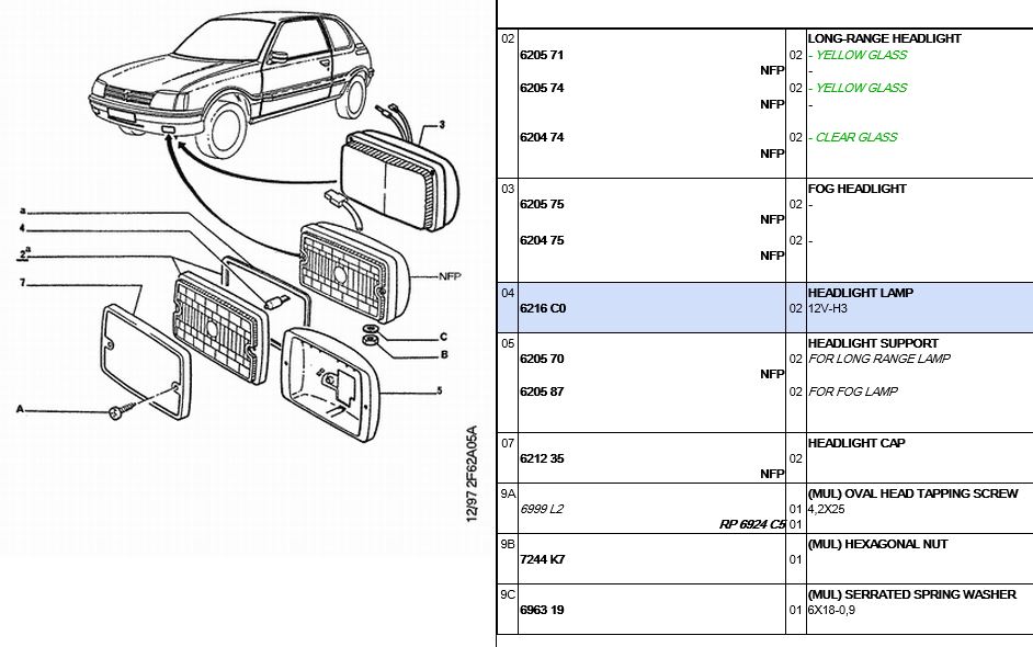

Rjuhar 52 Posted January 11, 2017 (edited) You have both on GTIs. Since you have the switch maybe the car had fogs as the switch itself is quite hard to find. It all depands what glass pattern you have. Fogs: Driving lights: Edited January 11, 2017 by Rjuhar Share this post Link to post Share on other sites
