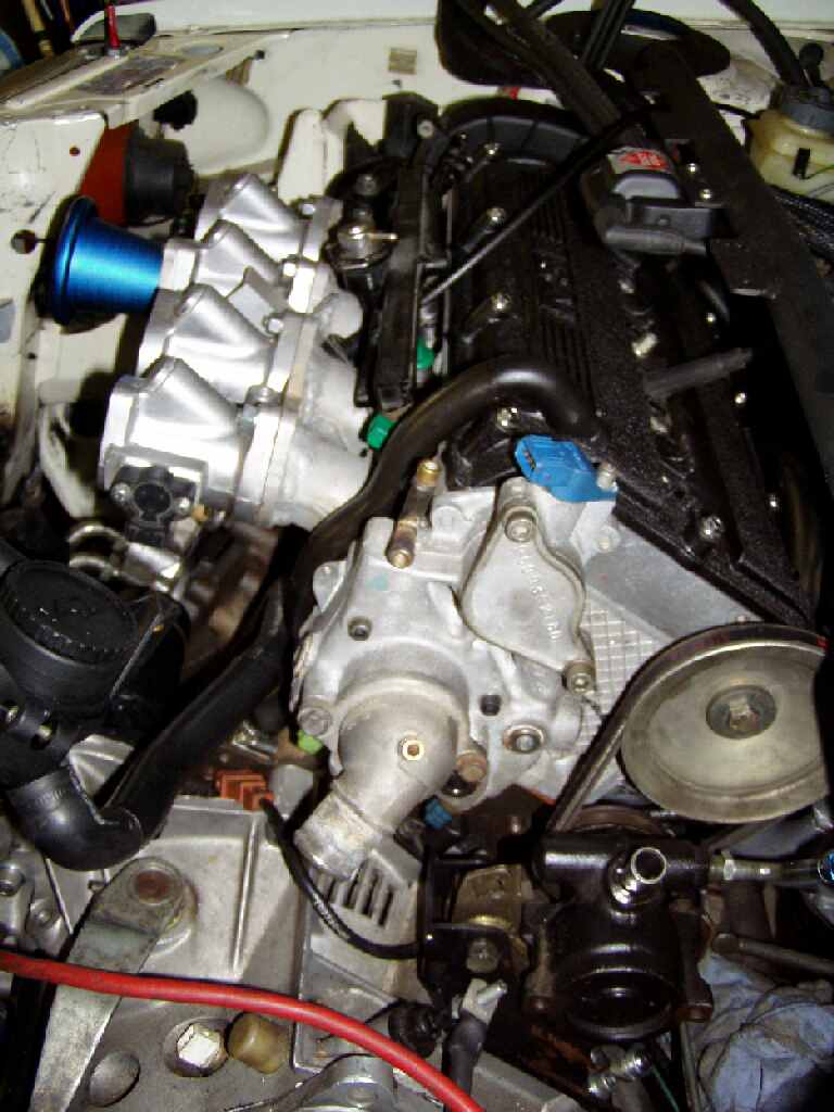

In this picture you can see housing I designed and had it made,this way I was abled to bolt up 1g DSM CAS. This CAS is driven by intake camshaft.

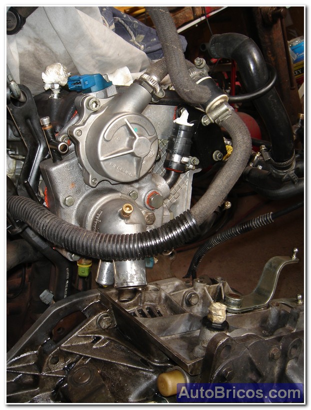

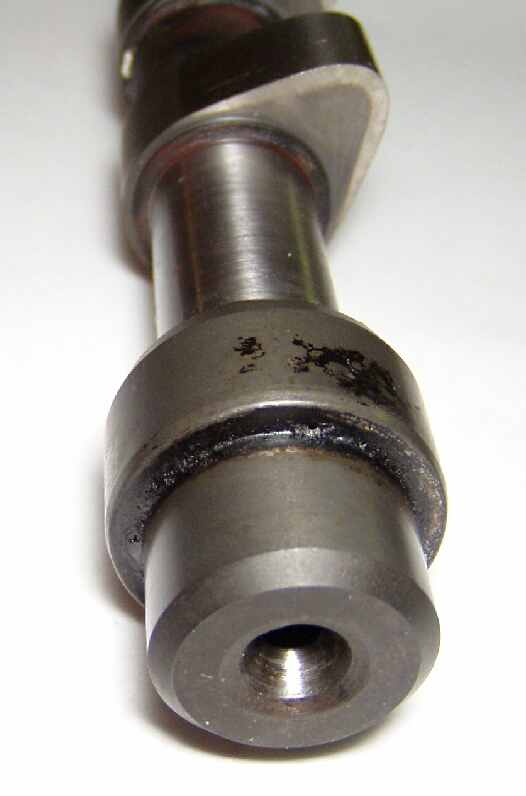

You only need the oil return path if you use the 306/S16 version which has a vacuum pump. The 405 version has a blanking plate as shown on my car. It's an XU10J4 housing on an XU9J4 head. I press the timing tang off and then put a normal seal on.

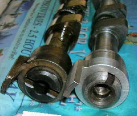

If you can't locate an XU10J4 inlet cam, you could ask somebody who's competent with a mill & lathe to make one. ie picture with 2 cams
I recently sold my spare housing & cam tang to Shane17 on here. That's his new cam and tang in the pic.
If using a 306/S16 cam, you also need to drill/tap the end of the cam to prevent oil entering the housing via the gallery. Note the hole in the cam journal. The 405 cam is solid.
You can use all the XU9J4 cam covers etc.
I'd put an add on Aussiefrogs as well.
Edited by petert
Forgot to say, continue using the XU9J4 exhaust cam. You can use an XU10J4 exhaust cam but you'd have to drill/tap for the M10 thread.
Use XU9J4 head bolts and spacers if using XU10J4 head. Over the water pump, you'll need to add a custom spacer.

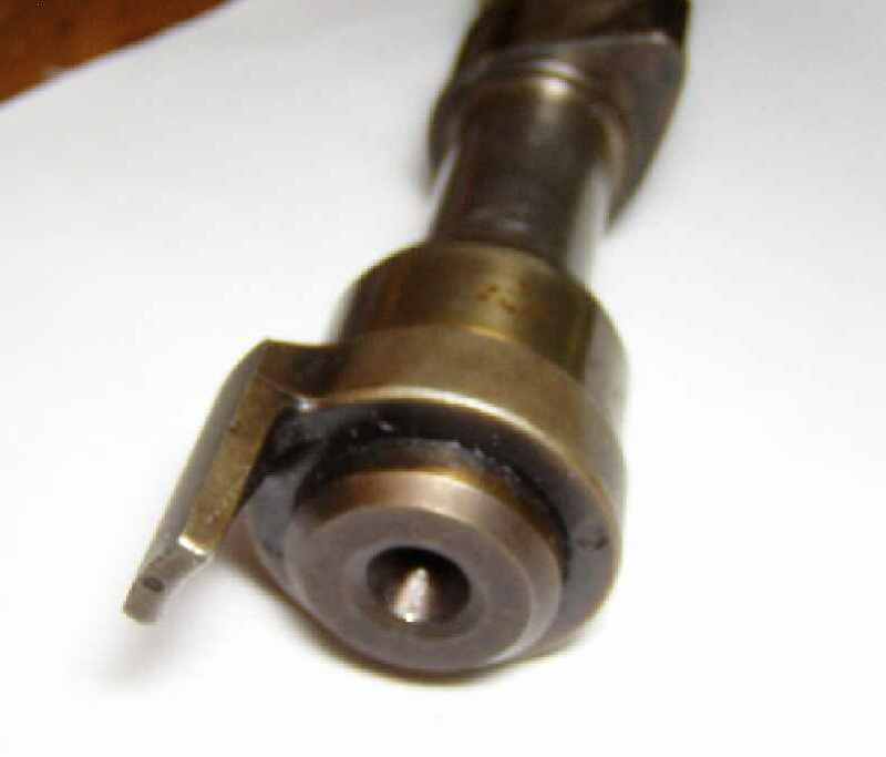

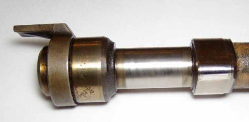

Some pics of a 405 cam with and without tang. And inside of thermo housing, 306/S16 cam.
