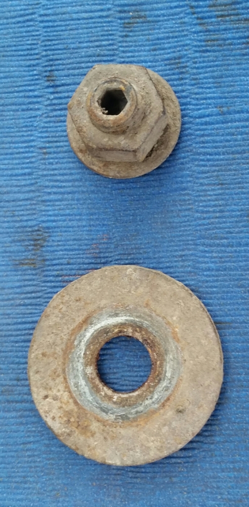

PhilNW 46 Posted August 14, 2016 While turning car round on drive found these two parts lying on the ground (see pic) its been stood for a couple of weeks after a road rally awaiting a new alternator. Before I start a detailed look to see where they have come from, does anyone recognize them? Share this post Link to post Share on other sites
magown3 0 Posted August 14, 2016 At a guess they look like something that holds a bumper on at the corner Share this post Link to post Share on other sites
pugdamo 111 2 Cars Posted August 14, 2016 The nut and remains of the stud look like it came from an anti roll bar link. Share this post Link to post Share on other sites
Tom Fenton 1,563 Posted August 14, 2016 Rear beam rear mount stud snapped Share this post Link to post Share on other sites
camgti 56 Posted August 14, 2016 Tom, do they usually have a allen key bolt? I thought they were solid. The nut looks like the gearbox breather but not with the washer next to it.. I would guess also something to do with the beam...as tome said! Share this post Link to post Share on other sites
PhilNW 46 Posted August 14, 2016 (edited) On 8/14/2016 at 8:15 AM, Tom Fenton said: Rear beam rear mount stud snapped Just checked Tom wins!! Grp A solid aluminium mount - any ideas why it should just fall off while stood in garage - fatigue failure? Edited August 14, 2016 by PhilNW Share this post Link to post Share on other sites
