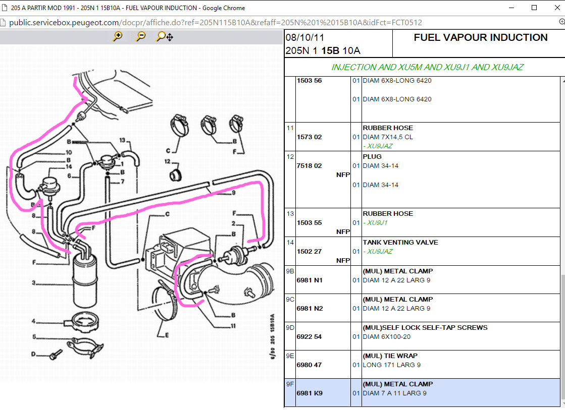

Looks like a oil filler cap on servicebox
farmer
Number 2 you've had from me
1 is that vapour filter drain
14 Tank venting valve (white)
3 Charcoal canister
Edited by farmer
mhyphenl

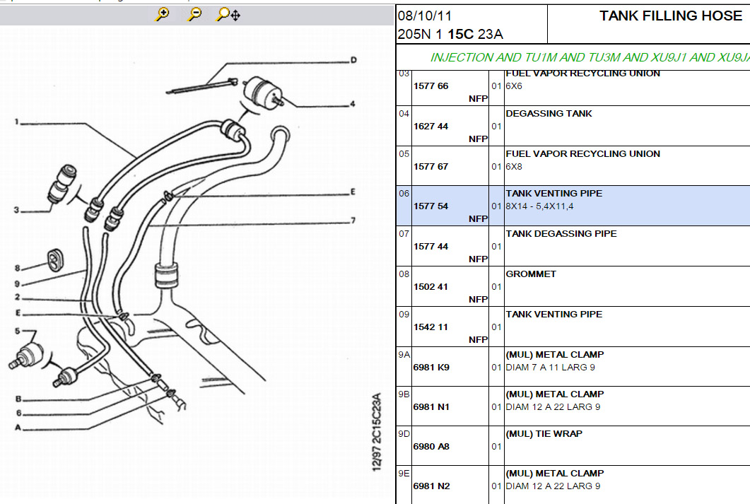

Just looking at the service box image, it's quite confusing. There are several options coming from the carbon canister. There are only 2 connections to the canister, in and out but on this image it looks like 3. I don't think I have item 14 though, there is a valve in that position but doesn't look like that. Also this shows the whole thing being plumbed into the elbow after the AFM where mine is definitely attached to the throttle body! I've drawn the route mine seems to take, the rest makes no sense to me!
The bit up in the filler hose housing is the de-gassing tank, item 4
Edited by mhyphenl

The diagram is so misleading but it would be good to talk to someone who has this setup and has seen it all in the open as it were. Do you have part number 14 on the diagram (1502 27) or is it part number 1 (1626 23) you have?
